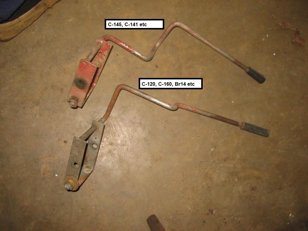

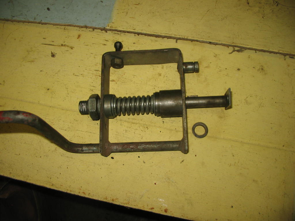

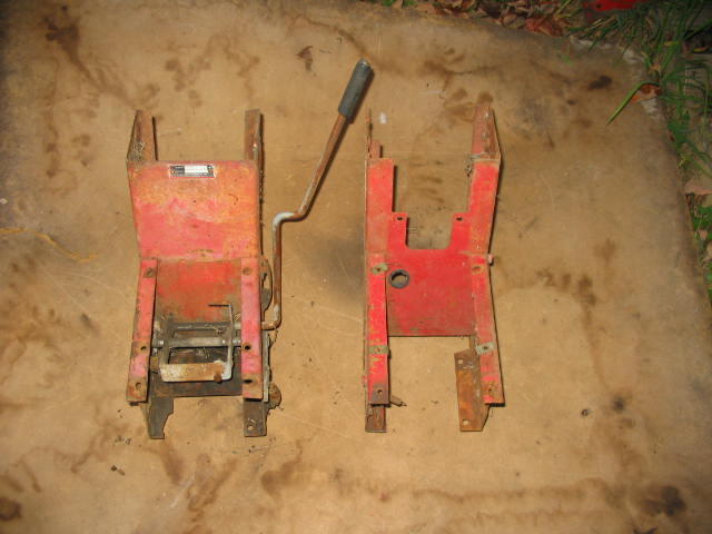

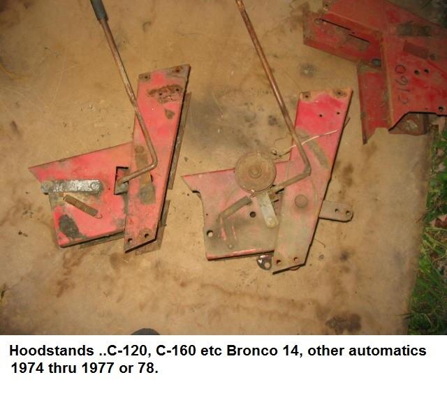

Blasterdad 3,168 #31 Posted December 18, 2022 On 12/13/2022 at 11:05 PM, daveoman1966 said: I had a 73 no-name 12hp Auto with the Motion control lever in the center of the hoodstand...like yours is. Its a PITA to operate...just awkward. So, after doin' a little digging, I was able to REMOVE that center lever and replace it with a right SIDE control lever. I actuall did this with mine and for a friends 16hp Auto. It involves: 1)pull out the original lever with friction components. 2)transfer those friction parts to the new side-control lever. 3)...MAYBE--- Trim a small slot out of the belt cover to accommodate the vertical side lever. 4)reinstall the new side lever, with fiction parts, in exactly the same place as the original lever. DONE. You'll need a side lever like this: I have two of them. you MAY even consider swapping out the ENTIRE Hoodstand. NOTE the the side control lever is a WELDED assembly with the square BOX containing the friction parts. Its a PITA to operate...just awkward. This is an excellent post! I agree about the awkward position, my Dad had a No Name 16 Auto with a snowblower on it. Lots of hand motion & switching hands to operate the motion control & lift lever. I have a No Name 12 Auto I've considered swiching to a side control as I have all the parts to do so, but I also like the "uniqueness" of it so I decided to leave it original. I only use it to pull the cart around the yard so it"s not that bad, it's my dedicated cart horse so to speak, or I just get her out to run her. ( It's got the wrong sticker on the hood & different PTO but she is a '73 No Name Auto ). 1 Share this post Link to post Share on other sites

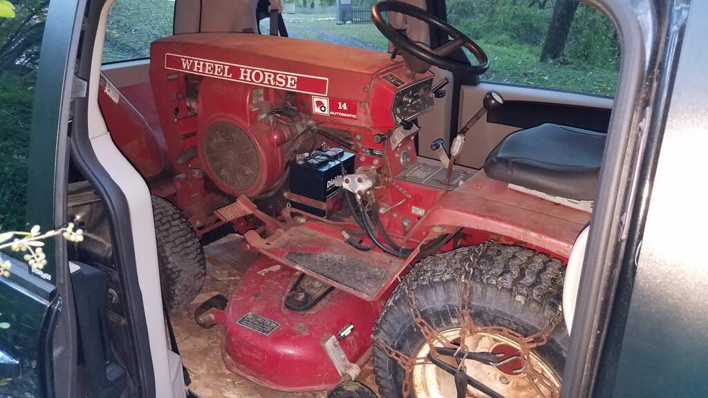

Inspectorjoe 473 #32 Posted December 19, 2022 When I bought my 14 Automatic, it had an extension on the motion control lever. It did make it a little easier to use, But it had a fatal flaw,. In neutral, it was tight up against me, so I couldn't go into reverse. Maybe the guy who installed it was small. I certainly am not. 2 Share this post Link to post Share on other sites

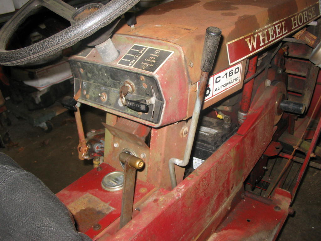

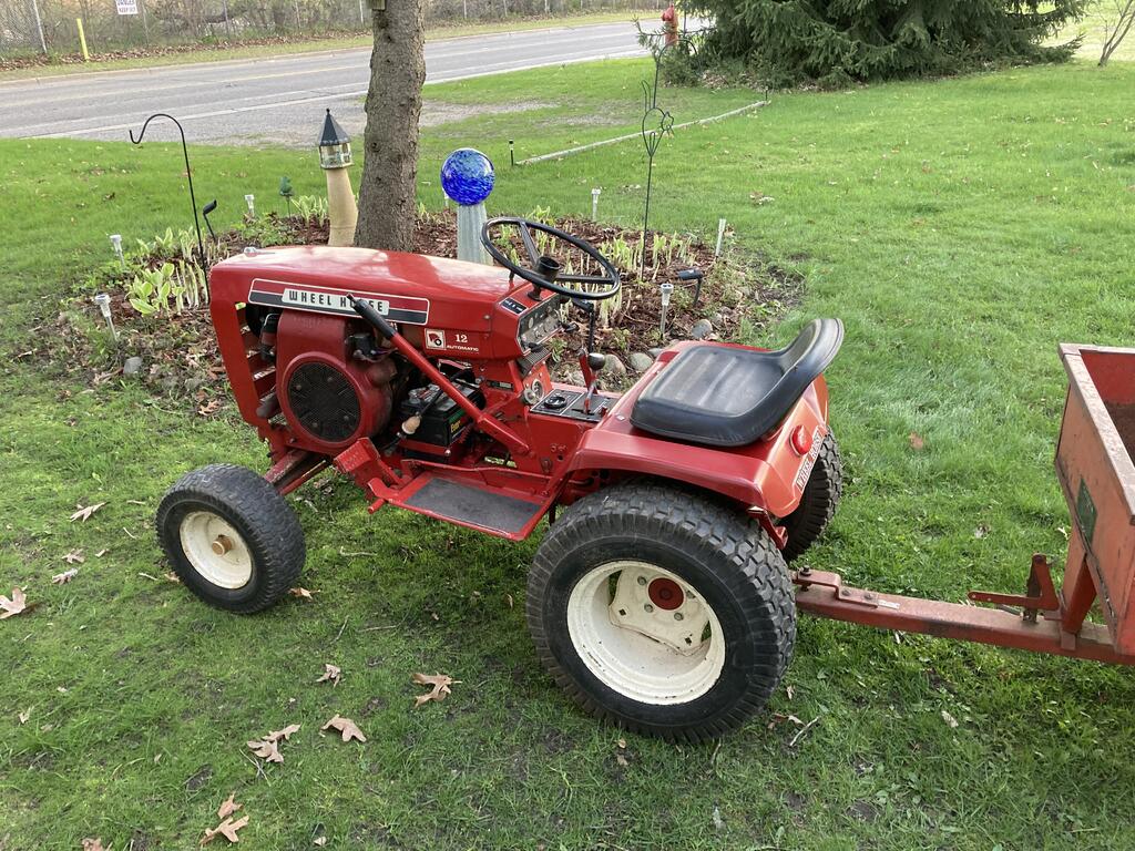

Wheelhorse#1 1,996 #33 Posted December 21, 2022 Great post.Here’s my 73 auto no name.It originally had the console shift.It’s was a pia to operate from the center. It can be easily swapped out as @daveoman1966 pointed out. I received the parts from AZ tractor and dave walked me through it.took me about a hr to swap out. Share this post Link to post Share on other sites
