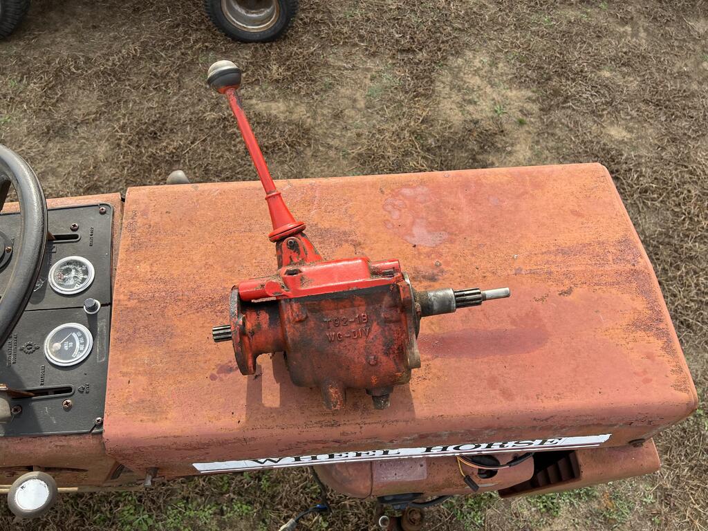

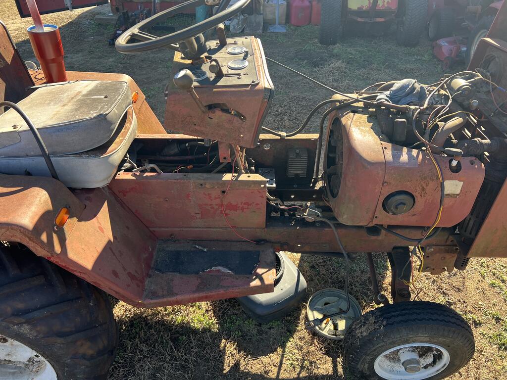

19richie66 17,951 #1 Posted December 4, 2022 (edited) Picked this up with plans on a restoration project for later on. Every pivot, linkage rod end and bearing on this tractor is worn out. It had a loader on it before I got it. Got it running, lift cylinders work albeit very slow but it would not move. Trying to decide what direction to go, I scoured the internet and stumbled across these two videos on youtube and have studied them, watching them both many times. Sad he repurposed an older horse but the way he did the transmissions is genius. I have a Panzer rear axle, picked up a T-92 3 speed powerking transmission but I didn’t have a wheelhorse manual transmission. I did have another Eaton 1100 sitting around and thought I would give it a go with that. This way I don’t have a clutch or linkages to try to fit in there. Did some measuring and it will be close. Yes I will have to cut the frame on the right side a little but will weld in some steel to stiffen it back up. If it works, you’ll see what I’m talking about. Haven’t gotten that far yet. Yes I’ll loose the PTO and steering brakes but I don’t really care as I have no D series attachments and will add automotive disc brakes in the rear. Took the transmission apart, removed the pump and began cutting. Removed the axles/differential (it won’t be used), cut off the axle housing extensions. Removed the bearings and traced out some circles on some 1/8” plate for fillers. JB welded both plates in place of the axle bearings and reassembled the transmission. Silicone sealed the outside of the plates and ran out of time. Next step is to remove the PTO assembly and right side panels/fender. Gonna be tight. Edited December 14, 2022 by 19richie66 5 6 Share this post Link to post Share on other sites

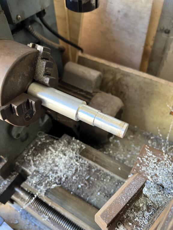

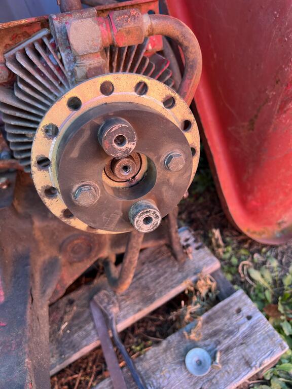

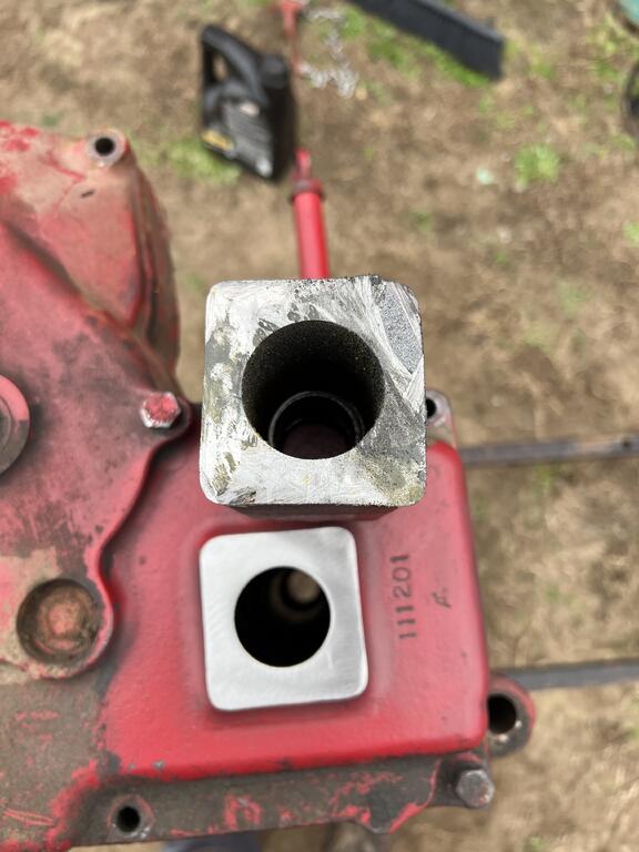

19richie66 17,951 #2 Posted December 5, 2022 Had to make an adapter to center up the coupler and the “new” coupler so I could mark the holes. Got everything drilled and welded. Should work. 4 6 Share this post Link to post Share on other sites

953 nut 70,661 #4 Posted December 5, 2022 I will be watching this one for sure! So, the power output will use the break shaft, do you think it is strong enough or will it be replaced with a bigger shaft? Guess you will need to do some frame surgery to allow the input of the Eaton to line up with the crankshaft, no big deal for you. Will this be coupled to a geared transmission so you have a choice of operating speed ranges? 1 Share this post Link to post Share on other sites

19richie66 17,951 #6 Posted December 5, 2022 (edited) @953 nut I believe the brake shaft will be plenty strong enough as it is a 3/4” hardened shaft and inside supports the reduction gears for the differential. If I measured right, I have to take about 1-1/2” out of the right side but I will weld a new crossmember below the transmission housing. The brake shaft will drive a chain down to the 3 speed powerking transmission. To start I will use the same size sprocket top and bottom. We’ll see what kind of speed/power I get from that. If I have to, I’ll go up or down on tooth size till I get it right. The Panzer rear is a 4:10 geared axle if my observation is correct. Edited December 5, 2022 by 19richie66 1 2 Share this post Link to post Share on other sites

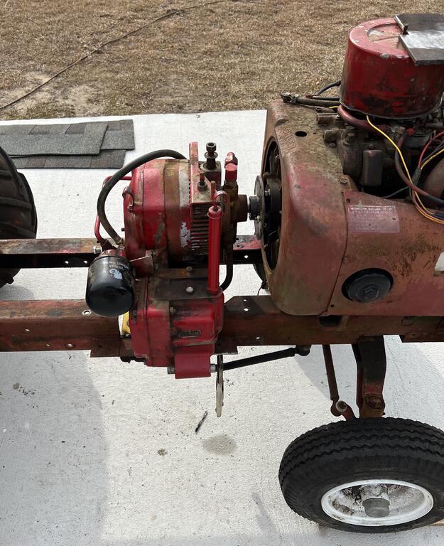

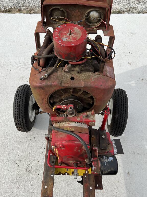

19richie66 17,951 #11 Posted December 5, 2022 Another piece to the puzzle. No I can do some more planning. 3 5 Share this post Link to post Share on other sites
19richie66 17,951 #12 Posted December 5, 2022 Ready for surgery 2 3 Share this post Link to post Share on other sites

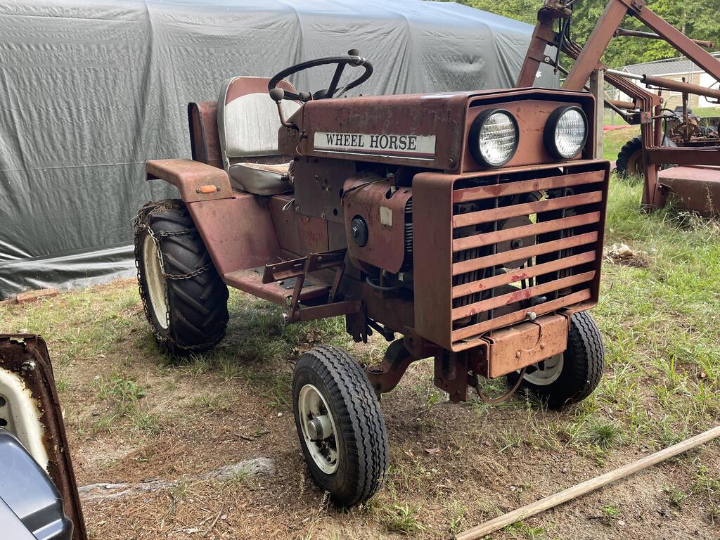

Snoopy11 5,731 #13 Posted December 5, 2022 (edited) Strikes me, right or wrong... that those are some skinny tires on the front for a loader. I am in love with the D200 though... I read a thread a while back that most members deem it the biggest tractor Wheel Horse made. I'd simply love to have one. Maybe one day... Don Edited December 5, 2022 by Snoopy11 1 Share this post Link to post Share on other sites
19richie66 17,951 #14 Posted December 5, 2022 1 minute ago, Snoopy11 said: Strikes me, right or wrong... that those are some skinny tires on the front for a loader. I am in love with the D200 though... I read a thread a while back that most members deem it the biggest tractor Wheel Horse made. I'd simply love to have one. Maybe one day... Don Those tires I believe were put on after the loader was taken off. They will not stay. It will get a set of 5 lug trailer hubs before its over. I had a D160 long ago but it was in really bad shape. The sheet metal on this is in fantastic shape…. Mechanically she is sick. 3 2 Share this post Link to post Share on other sites
Snoopy11 5,731 #15 Posted December 5, 2022 5 minutes ago, 19richie66 said: The sheet metal on this is in fantastic shape Sure looks like it! Sweet looking! Good luck on this one! I'll be along for the ride... drooling the whole time over your pictures... LOL Don 1 1 Share this post Link to post Share on other sites

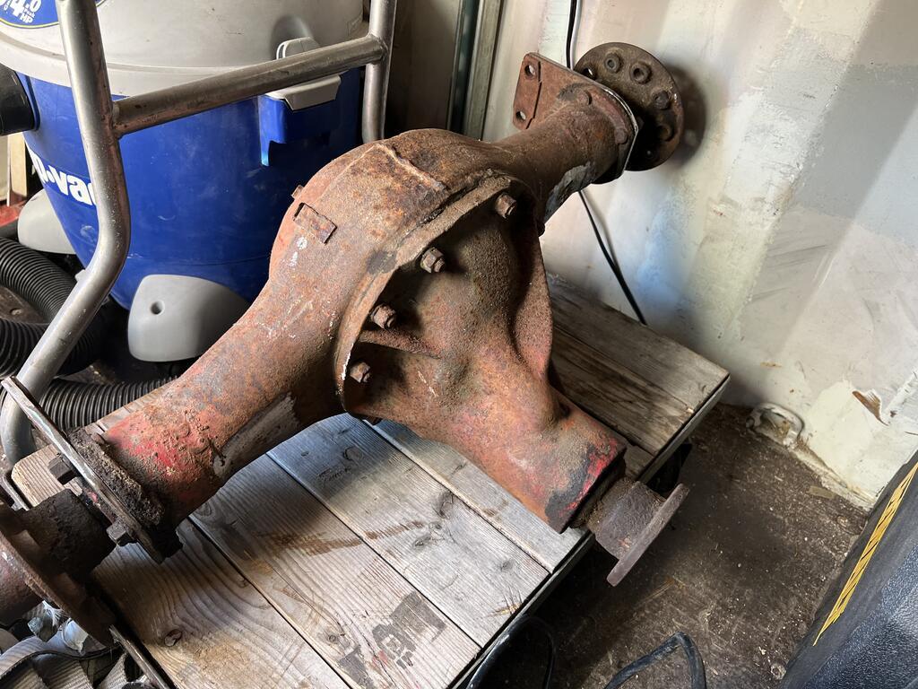

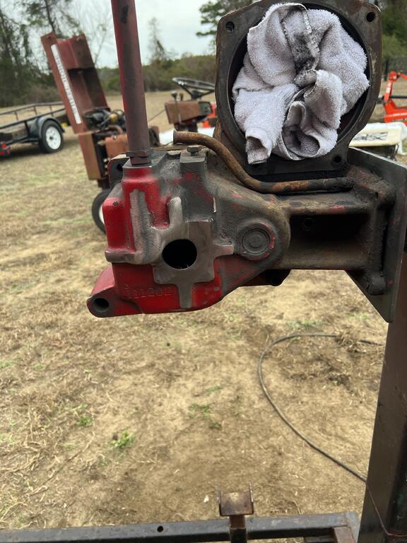

19richie66 17,951 #18 Posted December 6, 2022 Rear axle ready to go. 1 6 Share this post Link to post Share on other sites

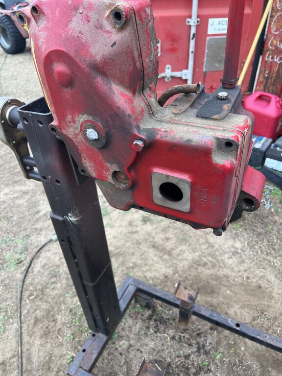

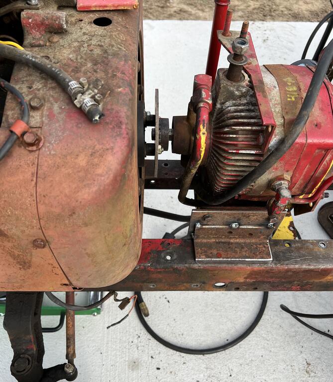

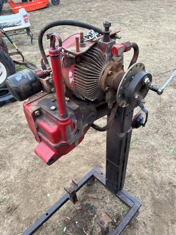

19richie66 17,951 #23 Posted December 14, 2022 Test fit. Got it pretty much figured out but just need to finish making the mounts. Everything lines up pretty good. Got more pieces and parts coming. 3 3 Share this post Link to post Share on other sites
Pullstart 71,564 #24 Posted December 14, 2022 So, is that brake shaft going to be the input shaft of the gear transmission? 3 Share this post Link to post Share on other sites
19richie66 17,951 #25 Posted December 14, 2022 Yes. It will have a sprocket and the transmission will have a sprocket. Chain drives the input shaft of the 3 speed transmission. 1 1 1 Share this post Link to post Share on other sites
