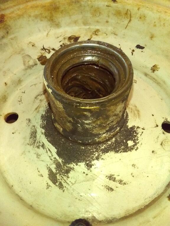

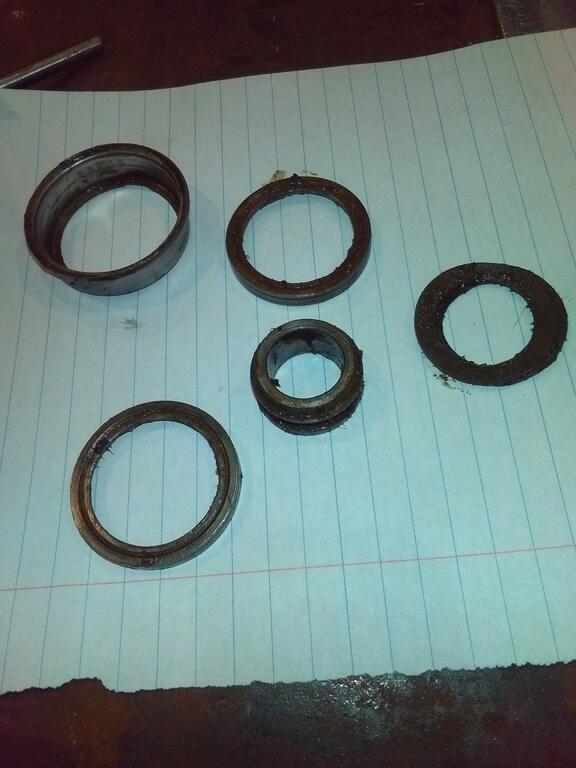

uglyblue66 134 #1 Posted November 29, 2022 I took my wheels from my E 141 to have a couple good tires put on, the clic came un done and the front wheel tried to come off, in doing so,the inner wheel bearing came apart. It appears to be a roller bearing as there were a few of the balls in there. Where can i get a a replacement bearing? I can't find a part number on the bearing to interchange with. 1 1 Share this post Link to post Share on other sites
gwest_ca-(File Mod) 12,511 #2 Posted November 29, 2022 Is the spindle 3/4" diameter? Is the inside diameter of the tube where the bearing goes in the wheel 1-3/8" diameter? Original part number 107124 and no longer available from Toro 1 Share this post Link to post Share on other sites

uglyblue66 134 #5 Posted November 30, 2022 OK, I will have to measure the hub after I knock out the piece still in it. Share this post Link to post Share on other sites

Handy Don 17,591 #8 Posted November 30, 2022 Just to clarify, these are ball bearings. Roller bearings ride on cylinders instead of balls (and if the cylinders are really small, they are called needle bearings). If you go with sealed bearings (I concur with @ri702bill that these are way to go), @peter lena will advise you to open them and replace the "stock" lube with something like Lucas Red or Green before installing them. Be sure to replace both bearings in each wheel at the same time! I've done this to four tractors now with no issues and I was able to really degrease the wheels in the process so things are a lot cleaner. I even changed the bushing-style bearings on my garden cart over to sealed ball bearings. 4 1 Share this post Link to post Share on other sites

uglyblue66 134 #10 Posted December 3, 2022 (edited) Ok, the inside of the wheel is 1 3/4 inch, the spindle is 3/4 After some research, I found this page, https://www.myelec-traks.com/810007R1.pdf Along with alot of other info but the wheel bearing part number it shows for the E141 is 107124. Edited December 3, 2022 by uglyblue66 2 Share this post Link to post Share on other sites

peter lena 10,095 #13 Posted December 3, 2022 @uglyblue66 have also firmed up those bearings , with additional washers , that detailing also eliminates the play issue . its a regular thing for me to look at the INTENDED FUNCTION . of wheel horse anything , and detail in it working better . thin washers are available for that set up , that firming hold of the bearings prevents the horizontal shucking side to side play that starts bearing destruction . the pictures above , which I can relate too , are what made me look for a change , since stopping wheel , side play , there is no bearing issues at all .road tested it , and applied it to my other horses , so I know it works . make a change on a problem area, just my own experience, pete 1 Share this post Link to post Share on other sites

uglyblue66 134 #16 Posted December 11, 2022 Well exact fit,worked great. I took out the inner seal and left the outer 1 in so I can grease the wheels with the fitting. I got 4,and just about cheated and just put the other 2 on the shelf for later but went ahead and checked and I am glad i did. The tire guys had ruined the other inner bearing to.it came all to pieces when I messed with it just a bit.So all new,and I took it on a night time run.glad to have it going .It had sat a while because of a flat bad tire then the bearing screwed up. 3 Share this post Link to post Share on other sites
