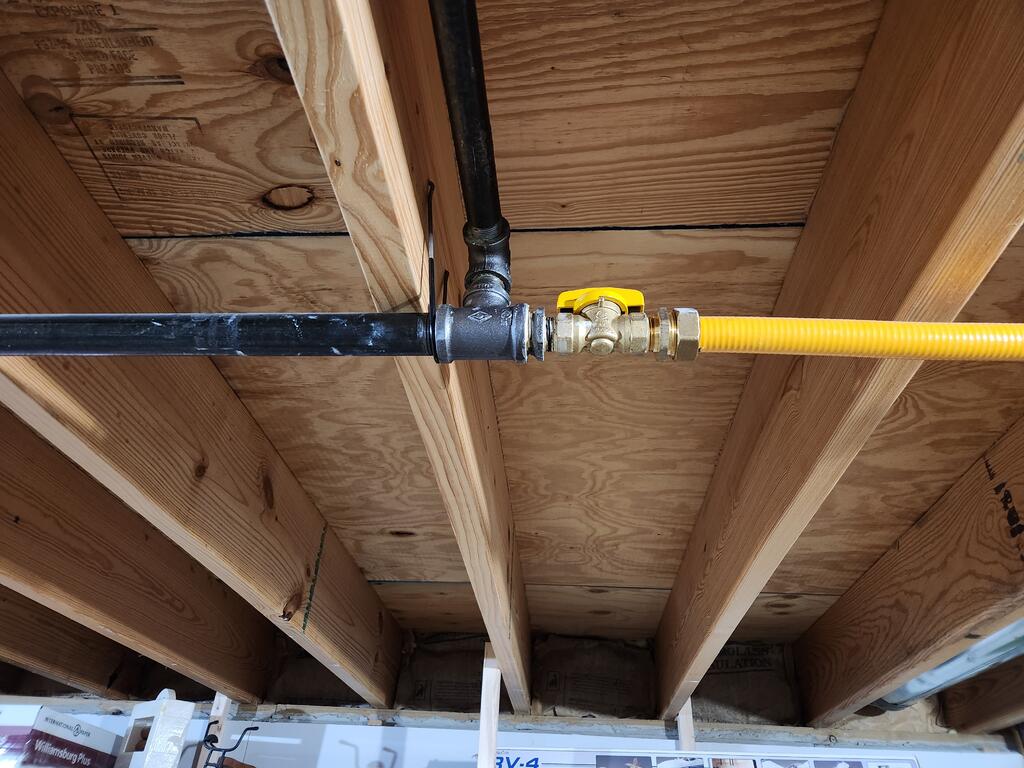

Racinbob 13,199 #5 Posted November 26, 2022 There's a shutoff at the meter. First, as with electricity, if there's any doubt call a professional. Gas is nothing to mess with. We switched to a gas range a couple years ago. I ran a csst line to it. That's corrugated stainless steel tubing that @rmaynard is referring to. The fittings are a bit pricy but I love the stuff and it has advantages over iron pipe. A shut off is required at all appliances. That's national and local codes can't eliminate it. First, I shut off the gas at the meter. Then I installed this where I tapped into the existing piping. This one wasn't required but it allowed me to get the gas back on as sooner. I ran the line and ended the csst at a short section of iron so I could get a firmer mount to the joists. Don't forget the required drop pipe near the destination. From there it's up through the floor, the code required valve and connection to the range. Make sure everything is sized correctly for the cfm required. All the info to do that is easily found online. Csst is different than iron pipe. Again, if in doubt, call a professional. CHECK AND RECHECK FOR LEAKS WITH A SOLUTION AS WELL AS YOUR SNIFFER. ALWAYS HAVE A GAS DETECTOR IN PLACE. 2 Share this post Link to post Share on other sites
