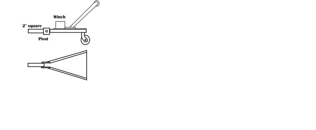

953 nut 65,727 #3 Posted November 3, 2022 4 hours ago, CCW said: First idea is to mount the crane to the hitch receiver. Ground bracing when picking up a load is fairly easy, but how do I keep it upright and sturdy while driving? If you make it into a mini-trailer with a pivot at the hitch and a couple of inflatable tire caster at the back it should be stable and follow you where ever you go, easy to back up too. Something like this; 3 5 Share this post Link to post Share on other sites
ebinmaine 78,595 #4 Posted November 4, 2022 9 hours ago, 953 nut said: If you make it into a mini-trailer with a pivot at the hitch and a couple of inflatable tire caster at the back it should be stable and follow you where ever you go, easy to back up too. Something like this; Excellent idea Richard. There are massive loader style cranes which Americans often refer to as knuckle booms that are on super heavy duty versions of this. It creates a loophole in the weight restrictions of some states. By putting the crane on its own trailer even though it's permanently attached to the vehicle it adds a lot to the weight carrying capability by gross vehicle capacity. IIFF properly built it would be an excellent addition. 2 Share this post Link to post Share on other sites
CCW 1,500 #5 Posted November 4, 2022 11 hours ago, 953 nut said: I like this idea. Simple and functional. Thanks @953 nut @ebinmaine 1 Share this post Link to post Share on other sites
