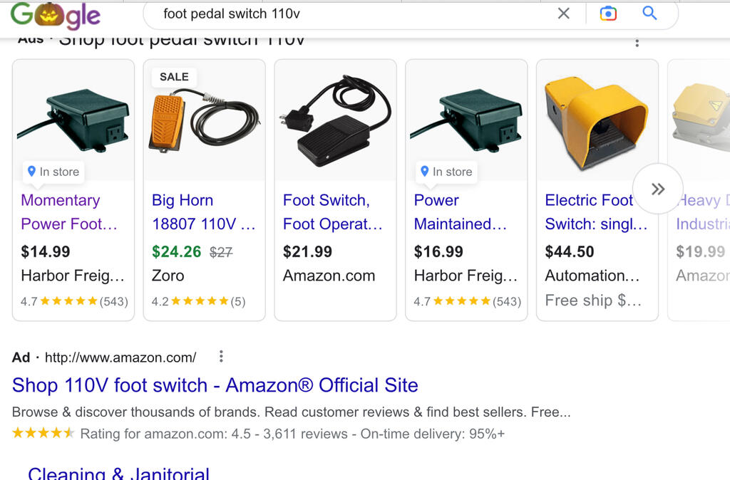

Pullstart 71,016 #2 Posted October 31, 2022 What about a foot pedal switch feeding both machine EB? My only negative I can think of is the spool time of the vacuum. You’ll be running the saw before the full auction happens. 3 Share this post Link to post Share on other sites
ebinmaine 80,103 #3 Posted October 31, 2022 2 minutes ago, Pullstart said: What about a foot pedal switch feeding both machine EB? My only negative I can think of is the spool time of the vacuum. You’ll be running the saw before the full auction happens. Not a lot of spool up time on those. A second maybe? Not a big deal. I do like that foot switch idea. 1 Share this post Link to post Share on other sites
Pullstart 71,016 #4 Posted October 31, 2022 Good handful of options. Make sure whatever you get, it’ll handle the amp load of both units 3 Share this post Link to post Share on other sites

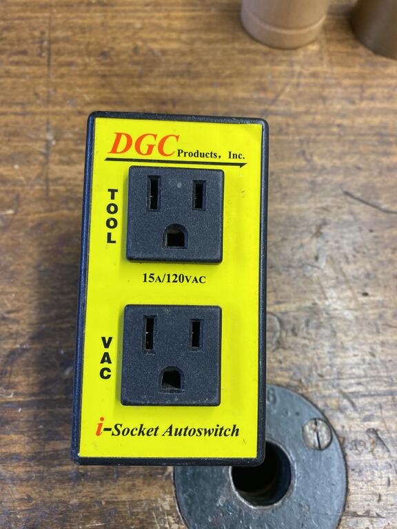

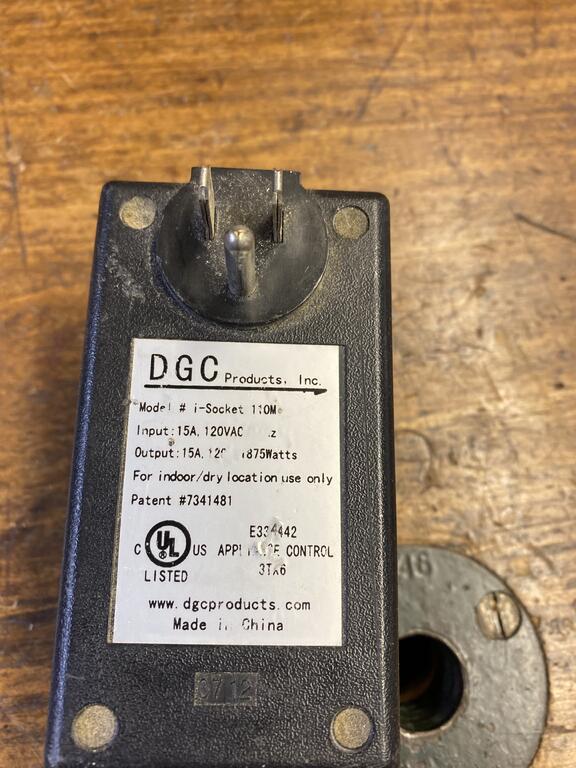

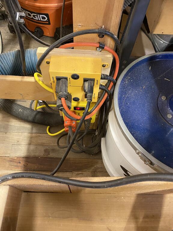

formariz 12,381 #12 Posted November 3, 2022 (edited) @ebinmaine I have used these devices for over 30 years. They are invaluable for their intended purpose. They delay the turning on of the vacuum not only to prevent overload from the two motors but also disconnect vacuum a few seconds later to allow hose to clear. The draw back on the one suggested by @oliver is that it’s amperage rating is too low. I use mine sometimes continuously for over 20 minutes or more when using router table. The plug overheats and start melting. Something to be careful with. I already replaced it a few times and keep spares handy. The smaller unit is great for a single tool such as a motorized miter saw specially at a job site. Edited November 3, 2022 by formariz 1 1 Share this post Link to post Share on other sites
