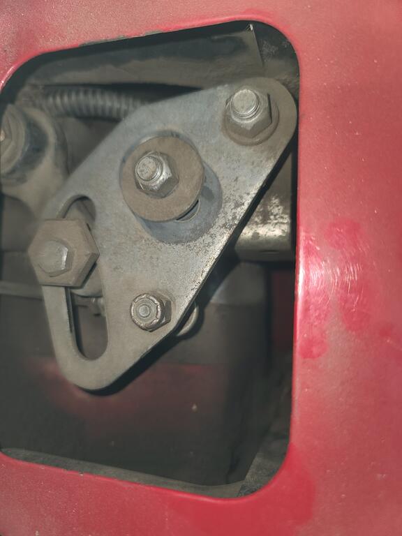

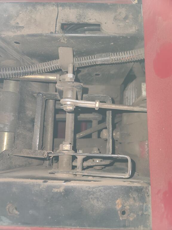

Cee245 850 #1 Posted October 24, 2022 Having an issue with reverse on my 416h. I've adjusted the neutral creep before and am just now trying to get it just right.... I know to clean and use dry lube etc because of this site I currently have it so when I push the brake, it stops with no creep at all.(I checked this with it jacked up) Problem is when I use reverse it is SLOW. What am I missing? I can't seem to get it right, yet. 😕 Thanks 1 Share this post Link to post Share on other sites
Ed Kennell 44,145 #2 Posted October 24, 2022 Does the motion control lever rotate the cam plate through the entire length of the forward/reverse slot ? If it isn't going to full reverse, you probably need to lengthen the control rod, then readjust the cam nut to set zero creep. 3 2 1 Share this post Link to post Share on other sites

Cee245 850 #4 Posted October 25, 2022 Thanks @Ed Kennell !! after more investigating I agree. 1 Share this post Link to post Share on other sites
Cee245 850 #5 Posted October 25, 2022 Although, I have a foot conversion on this machine. When I push down the whole way, it seems it needs more room. I'm guessing I'd have to adjust the foot control first. (This info would have been more helpful in my original post!) When the 80hour weeks stop next week, I'll be able to devote some more time to figuring this out. 2 Share this post Link to post Share on other sites
