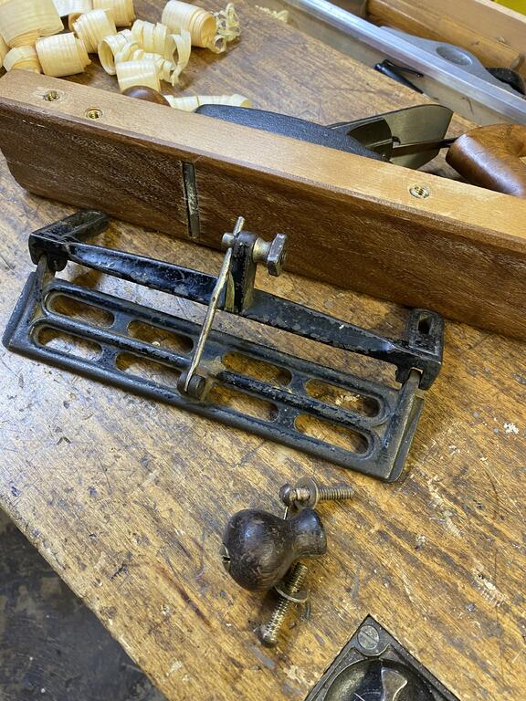

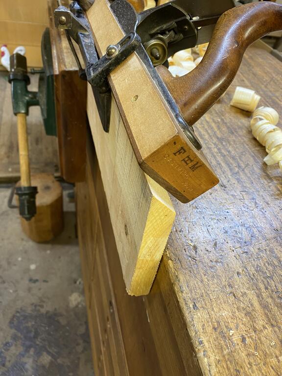

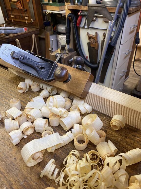

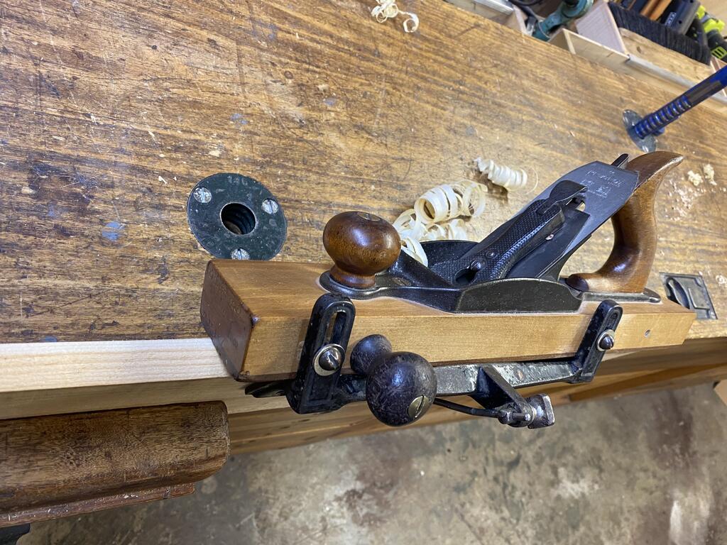

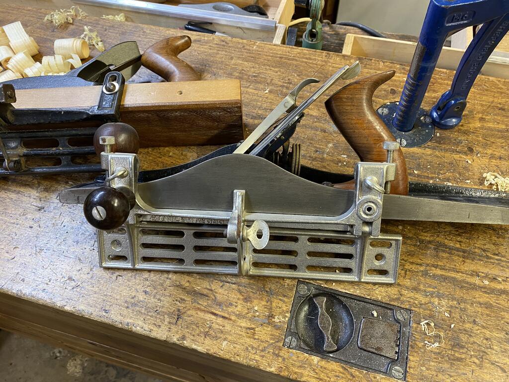

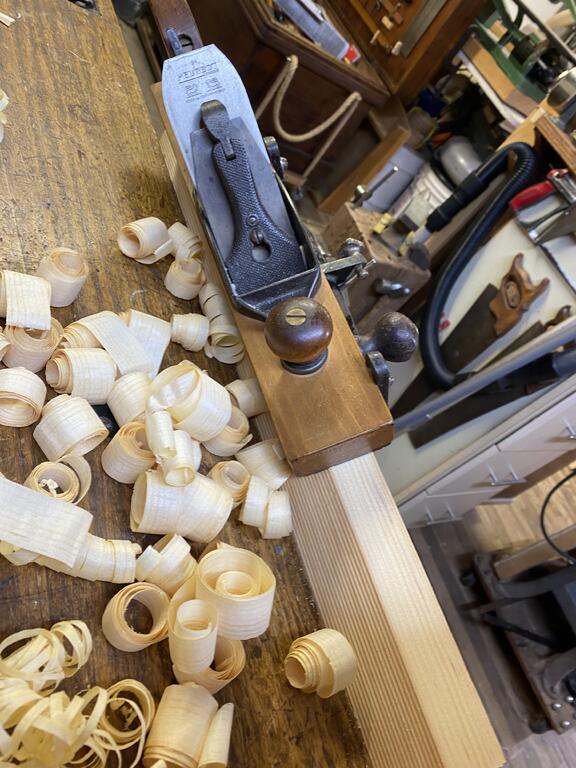

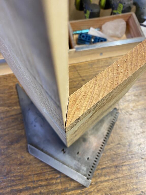

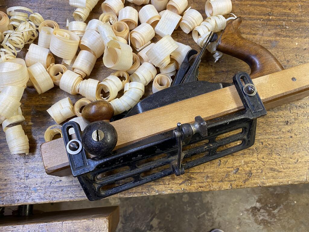

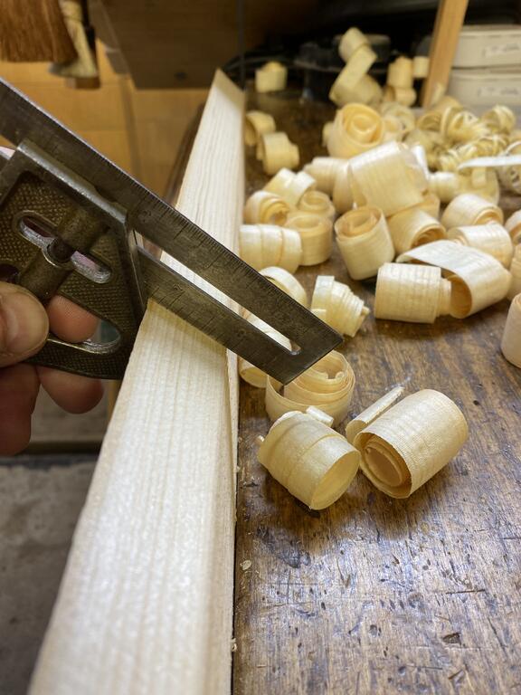

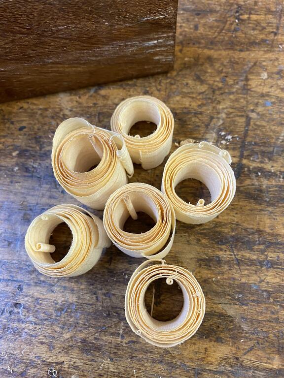

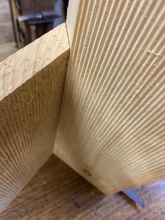

formariz 11,865 #1 Posted October 18, 2022 Everyone knows that a miter is a relatively simple thing to do. Wether using a powered miter saw or a hand operated one it is a straightforward thing to do as long as it is on the end of a board. A long miter on the edge of a board however is a not so simple thing to do . I am sure many of you tried it on for example a table saw and found that it is not only a precarious operation but also that it does not yield good results. Regardless of the side of the fence you attempt to cut it there is always lots of binding and burning. If board is not perfectly flat miter will also not be accurate. I always do long miters by hand using a plane. I have made them up to ten feet long this way. Plane is assisted by an adjustable guide that will adjust to 45 degrees or anything in between. It is a stress free operation with full control over the results . Sometimes one wants a mitered joint to be somewhat more or less than a perfect 45 and with this method adjustments of 1/64” are done in one pass with precision by merely adjusting the blade tilt on plane. Plane guides I use are over 100 years old but can be found relatively easily. My favorite one is made to be used with a wood plane. It’s used on a plane I had since I was 20 years old and one of my favorite tools. When not in use guide is removed. They are also available for metal planes. Another example how a somewhat complex operation with power tools can easily be accomplished better with no drama using simple common hand tools with better predictable results. Jointer Gauge attaches to wood plane Jointer Gauges for wood planes are rarer They were mostly made for metal planes Gauge holds plane comfortably at right angle very small adjustments can be made by just tilting blade within plane a very satisfying and controlled process End result a perfect miter predictable perfect results. Miters can be simply glued by using masking tape as a clamp Full contact on both sides throughout entire length The only clean up to contend with . No flying dust on your face, no danger to fingers. 3 8 3 Share this post Link to post Share on other sites

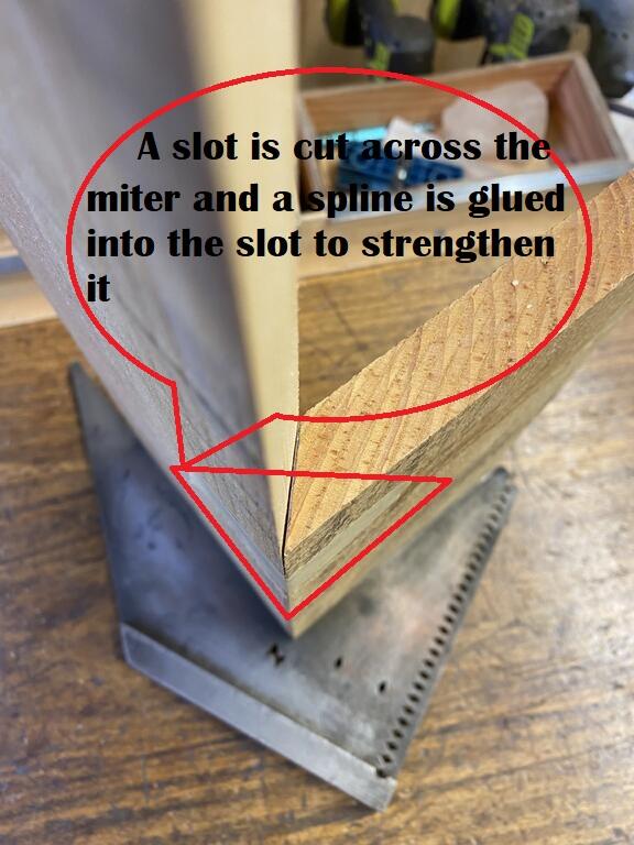

953 nut 51,940 #5 Posted October 18, 2022 I see you splined the joint to strengthen it, I usually use a contrasting color wood when doing that. 1 Share this post Link to post Share on other sites
Pullstart 59,859 #6 Posted October 18, 2022 @953 nut what does that mean? Share this post Link to post Share on other sites
953 nut 51,940 #7 Posted October 18, 2022 1 hour ago, Pullstart said: @953 nut what does that mean? 1 Share this post Link to post Share on other sites
Pullstart 59,859 #8 Posted October 18, 2022 I see, like a bow tie on a flat joint! Cas mentioned that was just masking tape on this joint Share this post Link to post Share on other sites

formariz 11,865 #10 Posted October 18, 2022 1 hour ago, Pullstart said: I see, like a bow tie on a flat joint! Cas mentioned that was just masking tape on this joint Correct I did not use a spline. The purpose of the spline is not only to reinforce joint but also to aid in keeping pieces aligned during glue up. When ends are exposed such as in the case of a small box they are also decorative. However if the miter is anything longer than about 30 inches it is a mistake to use it. That would mean running the two pieces individually on the table saw to create the kerf. On a long piece a precarious operation such as doing the miter that way. Kerfs will not be precise in relation to one another therefor misaligning the miters at glue up. On something long it also creates problems if too much glue is used which will not allow joint to close. There is no need for it. Joint has plenty of good glue surface. It will break everywhere but not at actual point of joint. A glued joint on long grain is stronger than the wood itself. I have done mitered joints up to ten feet long many times and nothing else is needed than a precise miter. Keeping it simple creates less panic at glue up. Plain masking tape keeps joint aligned and tight as glue sets. On the ends I use a pinch dog to keep ends together while I apply the strips of tape every six inches or so as needed. Carpenters glue ( aliphatic resin) sets within 15 minutes so to give me a little more time I add a small percentage of white vinegar to it . That extends set time by about 50% without reducing the strength of glue. 3 Share this post Link to post Share on other sites
