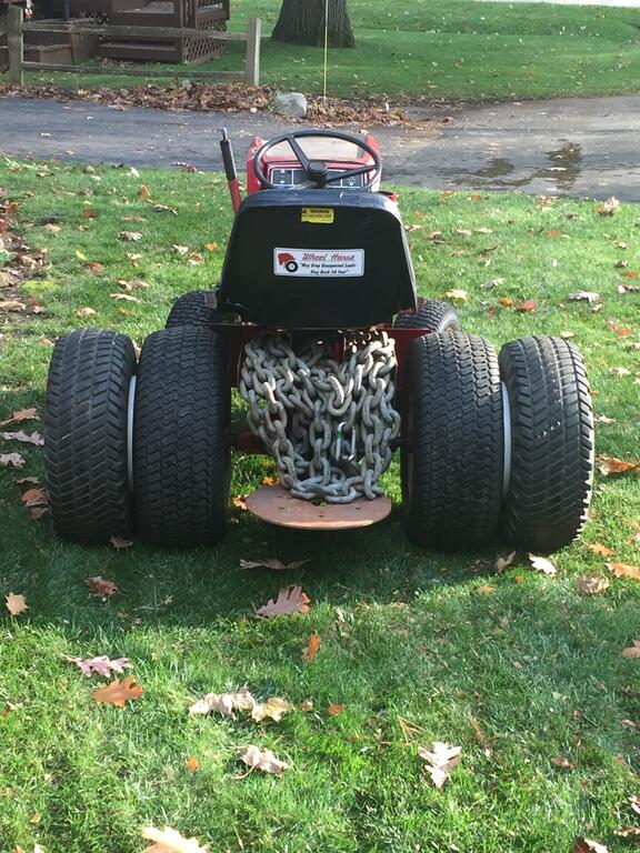

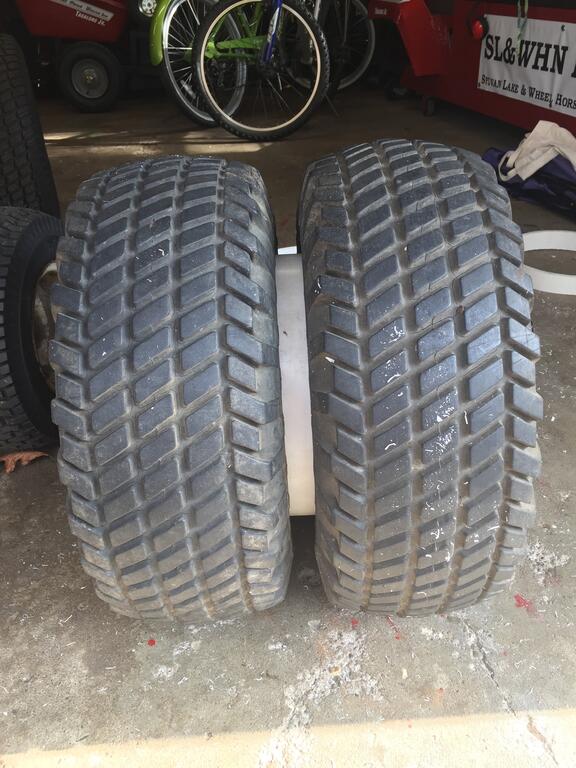

SylvanLakeWH 32,697 #11 Posted October 9, 2022 (edited) @Pullstart Is the proud owner of the set I made for the WHrat WHrod…. I used a circular saw following a sharpie line… worked great… Here’s the details: Dually discussion starts at post 62… Edited October 9, 2022 by SylvanLakeWH 4 4 Share this post Link to post Share on other sites
Pullstart 71,366 #12 Posted October 9, 2022 They still work too! 2 1 1 Share this post Link to post Share on other sites
Handy Don 17,560 #13 Posted October 9, 2022 4 minutes ago, Pullstart said: They still work too! I keep expecting the next picture to feature a small trailer with 10 clowns popping out of it! 9 Share this post Link to post Share on other sites
Horse Newbie 7,405 #14 Posted October 9, 2022 (edited) 1 hour ago, SylvanLakeWH said: @Pullstart Is the proud owner of the set I made for the WHrat WHrod…. I used a circular saw following a sharpie line… worked great… Here’s the details: Dually discussion starts at post 62… My gawsh !… what do you do … throw an anchor out for brakes ? The chain man !… the chain ! Edited October 9, 2022 by Horse Newbie 1 5 Share this post Link to post Share on other sites

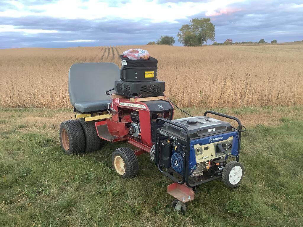

Horse Newbie 7,405 #15 Posted October 9, 2022 School bus seat ? 2 1 1 Share this post Link to post Share on other sites

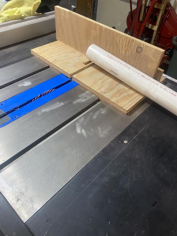

Heatingman 977 #18 Posted October 9, 2022 Cut it on a table saw. Make a little jig with 90 degree angle that slides on mitre slot. use a strap to hold the pipe loosely on to the jig, and slowly rotate the pipe. Sorta like this, just picture a larger piece of PVC. This jig is for making box joints, but it would look very similar. 4 1 1 Share this post Link to post Share on other sites

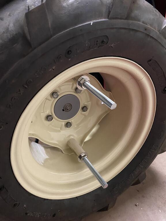

Heatingman 977 #19 Posted October 9, 2022 If the rims are just held together with long bolts and the PVC, then why not just sleeve the bolts with steel pipe nipples. similar to this 5 1 Share this post Link to post Share on other sites

ebinmaine 80,930 #22 Posted October 9, 2022 10 hours ago, Pullstart said: @ebinmaine @OldWorkHorse not knowing your urgency… @SylvanLakeWH included a real good length of 12” pvc with the WHRat. I have plenty. AWESOME. I'll send a PM... 10 hours ago, Heatingman said: This jig Excellent idea! 10 hours ago, Heatingman said: If the rims are just held together with long bolts and the PVC, then why not just sleeve the bolts with steel pipe nipples That would work to hold the wheels together for flat ground. Steve has some elevation. My ground is ROUGH. The PVC holding the wheels to each other makes all the difference. 4 Share this post Link to post Share on other sites

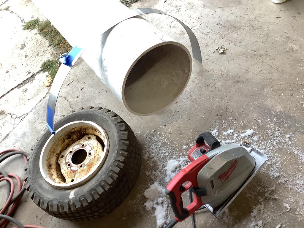

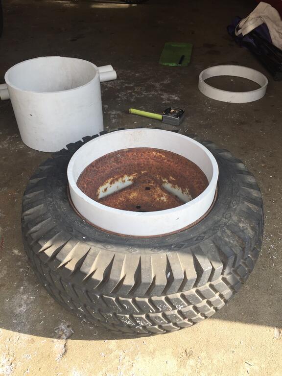

Pullstart 71,366 #24 Posted October 20, 2022 @ebinmaine @OldWorkHorse. I used a piece of thin aluminum to draw a straight line. A couple Jack stands laid down make a decent turn drum for cutting! 5 1 Share this post Link to post Share on other sites
