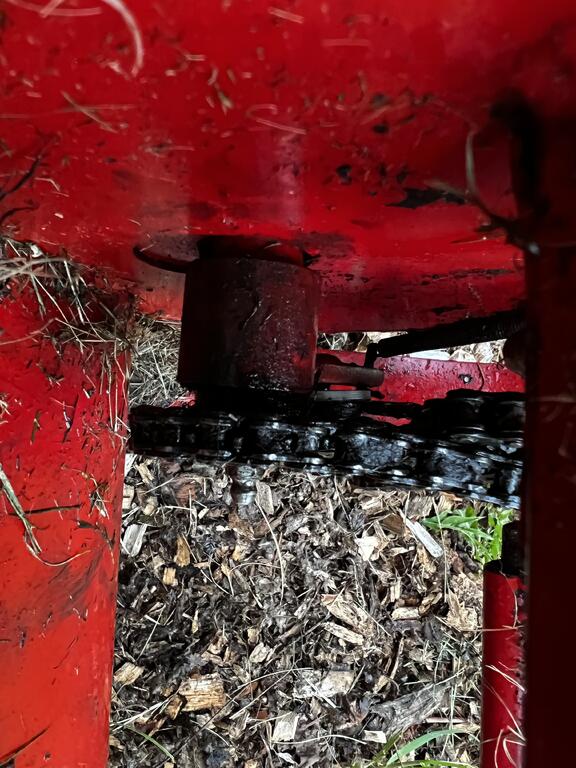

dbreeze911 13 #1 Posted October 4, 2022 So my sweeper chain won't stay on. It comes off at the tensioner, which appears to be missing a bushing or something. You may be able to see from the photo that there is a space btwn the tensioner and the bit that holds the tensioner spring. This bit gets a little catywompus by maybe a few degrees. It also moves freely about 3/16 in between the tensioner and the sweeper body. Does anyone have an exploded version of this assembly or an idea about what to do about it. Really appreciate it. ty 1 Share this post Link to post Share on other sites

peter lena 9,942 #10 Posted October 5, 2022 @dbreeze911 that trans drain is right under that plug picture , there is an allen plug right there , feel / look around for it, often packed with dirt , jack up front end to enhance drainage , change shift boot , your sweeper picture shows a drive chain off angle to the sprocket , thats your problem point , getting a diagram picture of that will let you find a cure . straight alignment and maybe another chain idler will help you out , have to see what you are dealing with . pete 1 Share this post Link to post Share on other sites

dbreeze911 13 #14 Posted October 5, 2022 9 hours ago, peter lena said: drive chain off angle to the sprocket , thats your problem point , getting a diagram picture of that will let you find a cure . straight alignment and maybe another chain idler will help you out Getting a diagram has been difficult without the OEM. I'll look into similar chain idlers. But even that is a needle in a haystack without the model. The leaves are falling. Guess I'll be raking. 1 Share this post Link to post Share on other sites

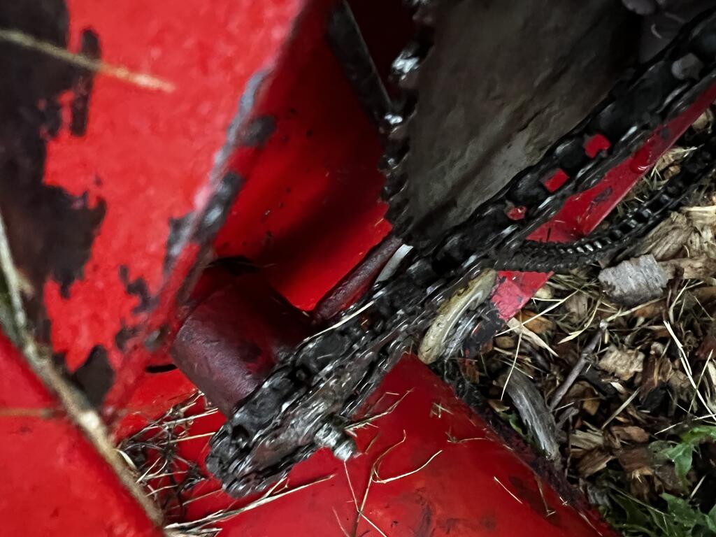

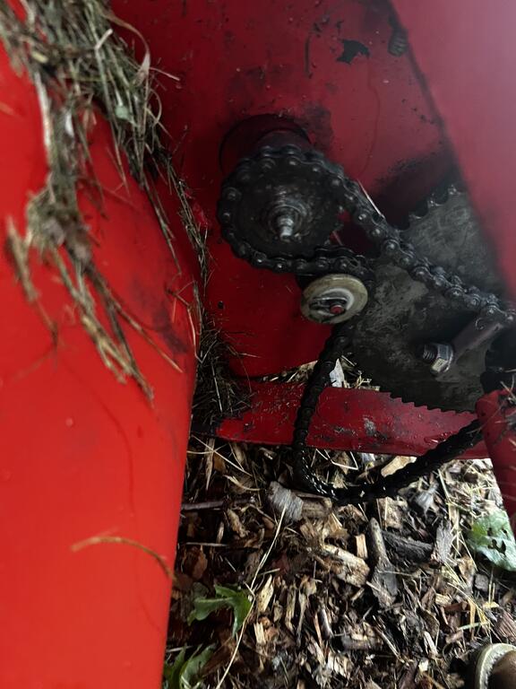

dbreeze911 13 #15 Posted October 6, 2022 18 hours ago, gwest_ca said: It should be a simple mechanism. Post some pictures of it so we can see what you are dealing with. @gwest_ca Just saw your note. I can't get a good shot. Are these helpful? ty I believe the mal function is in the light colored tensioner roller assembly. The way it attaches (see original photo) isn't stable. It sort of rocks slightly and sticks itself for a second on the shaft it rotates on then the chain comes off ty I don't feel so alone. I'm very appreciative. 2 Share this post Link to post Share on other sites

953 nut 67,394 #17 Posted October 6, 2022 1 hour ago, dbreeze911 said: I believe the mal function is in the light colored tensioner roller assembly. The way it attaches (see original photo) isn't stable. It sort of rocks slightly and sticks itself for a second on the shaft it rotates on then the chain comes off I wonder if the axle that your tensioner rides on is worn down on one side. If it is a shoulder bolt like most mower decks ride on you could probably find a replacement at a good hardware store. They com in all sorts of sizes and configurations. 2 Share this post Link to post Share on other sites
peter lena 9,942 #18 Posted October 6, 2022 @dbreeze911 that entire set up has been destroying itself for quite a while . another very important thing is your access / viewing of how it work's , can you elevate it , even on a couple of milk crates , so you can roller stool around it ? done that on my snow blower , mower decks , plow quadrant . lets you see where the problem is , those idler pulleys are available at tractor supply , just get same size / type . those large sprockets also look worn. look at detail function first , lubricate as you go , to enhance movement / function . personally love recovering a neglected attachment . making improvements / changes as I go . another vital thing is lubrication , lucas RED GREASE , also made by cnc is made for tough areas . just put the chain back on and see how its saposed to move . not as over whelming as you think . when secured , lubricated , aligned , it should move with smooth total ease . get us a frontal angle picture to see what you have , thanks pete 1 Share this post Link to post Share on other sites
lynnmor 8,899 #19 Posted October 6, 2022 35 minutes ago, peter lena said: @dbreeze911 that entire set up has been destroying itself for quite a while. get us a frontal angle picture to see what you have Yes, but clean it properly before taking the picture. I suspect that the chain and sprockets are spent. 3 Share this post Link to post Share on other sites
Lee1977 7,709 #20 Posted October 6, 2022 Check your bearings or bushings on those shafts too.. If they are worn and the shaft moves around the chain won't stay on. 2 Share this post Link to post Share on other sites

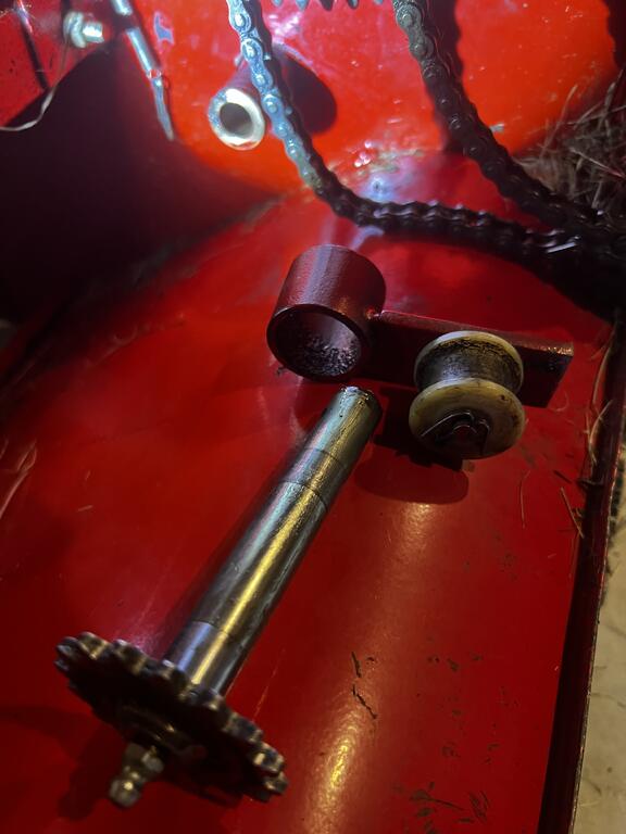

dbreeze911 13 #22 Posted October 8, 2022 No bearings or bushings on the chain tension idler. You may be able to see the play and slop though. The chain started droping immediately after hitting a hole in pasture. Uh oh. The 30 second vid is 70mb. only 15mb is permitted. Here's a pic instead. For clarity; The idler fits on the union you see in the background. The sprocket shaft inserts into that union. the idler doesn't fit on the sprocket shaft by design. 1 Share this post Link to post Share on other sites
