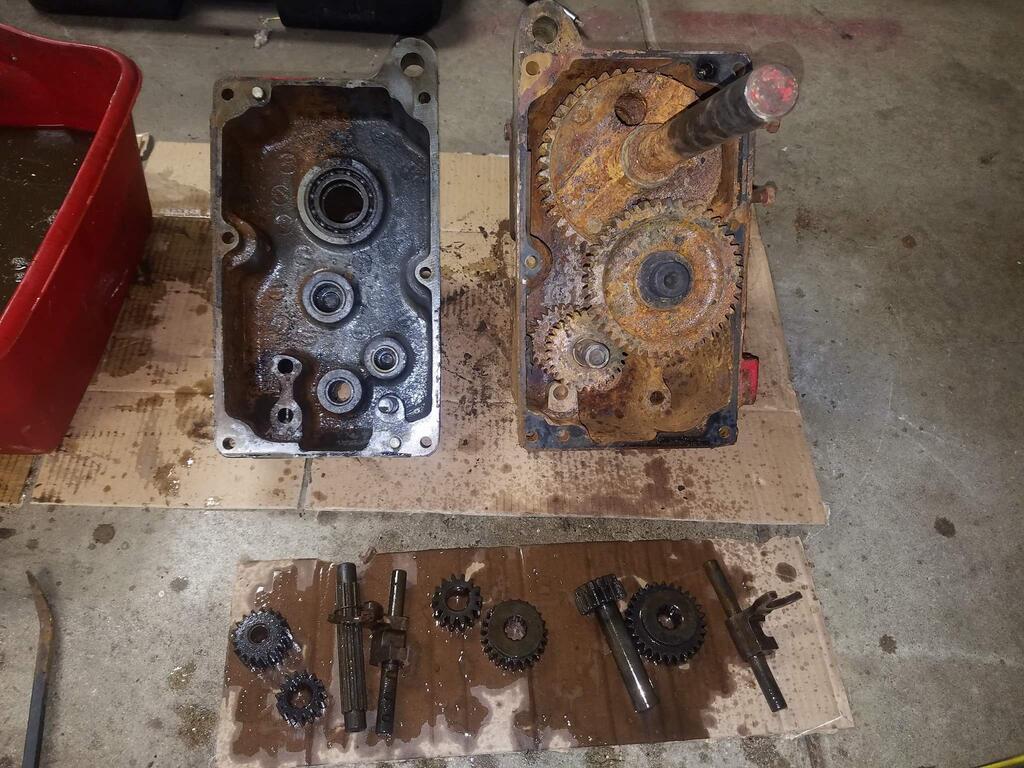

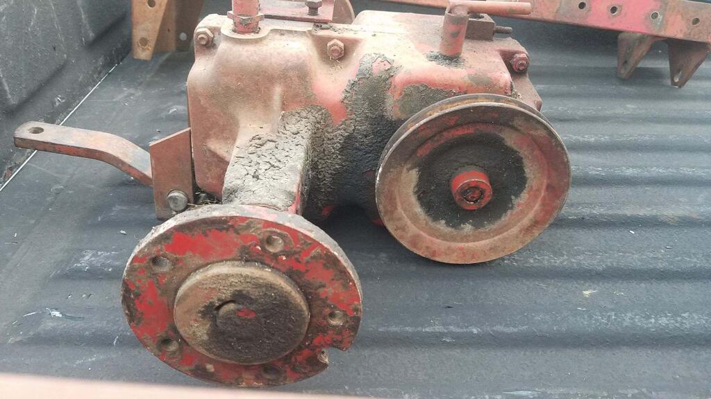

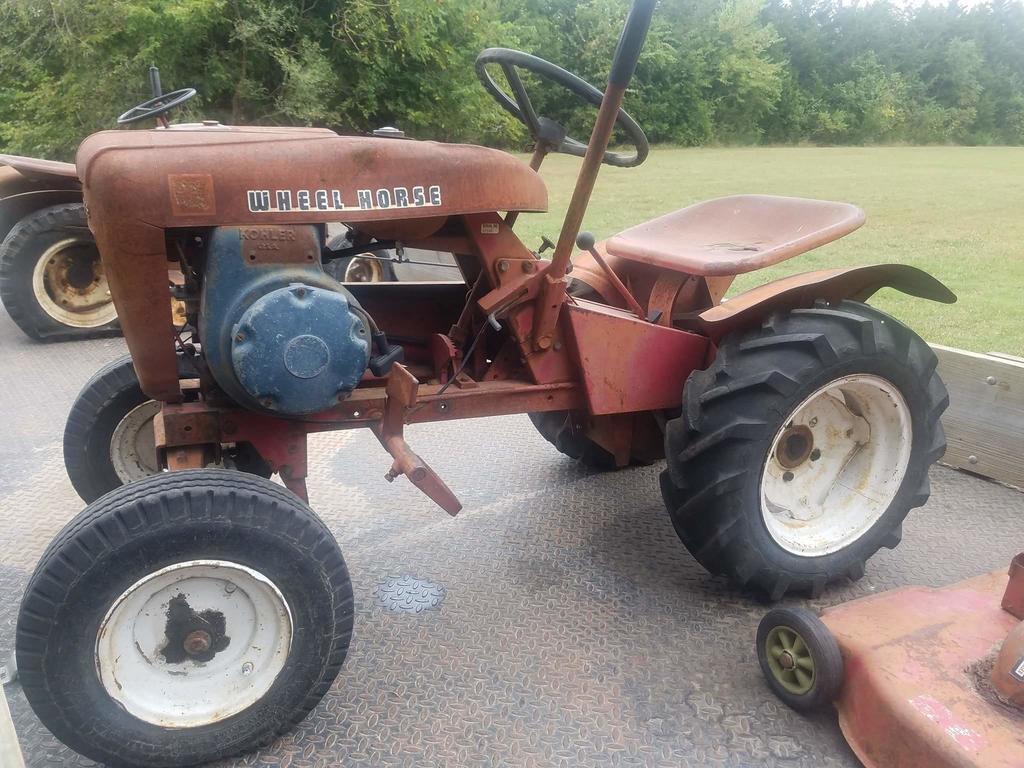

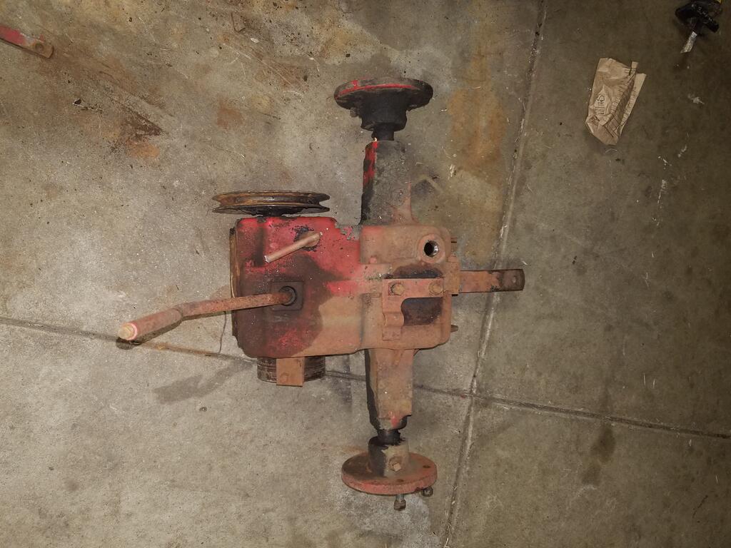

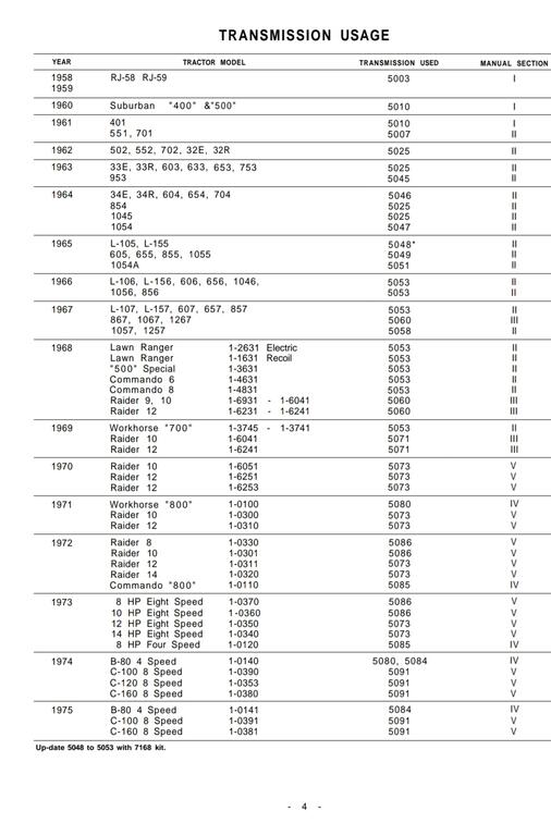

DBlackston 323 #1 Posted October 3, 2022 Hello all! I have a 704 that when I purchased it the transmission was locked up solid. I tore it apart but the inside was rusted quite badly and was in need of all new bearings and seals. I was going to buy a rebuild kit and tear into it, but a friend had a good transmission out of a C-111 that just needed seals. I have some questions though about this swap, and this is my first Wheel Horse Resto so I wasn't sure about a few things. I found this chart and found out that the 704 had a 5046 transmission and the C-111 had a 103916 transmission. I do have the hubs off of the C-111 transmission, and they are different than the 704 hubs. They are 5 hole instead of 3 hole but the same bolt pattern I think. The main difference I can tell is that the axle shafts are bigger at 1- 1/8" on the C-111 transmission than the 1" on the 704 transmission which I like since I plan on putting a set of dual ags on the tractor and filling them with washer fluid. The input pulley is also different, which I wondered if it would cause any issues. Unfortunately I started this swap about 2 years ago and life got in the way. I no longer have the 704 input pulley and don't know what size it was. The easiest option would be to just keep the C-111 input pulley but it may be too big for the belt cover on the 704, I also am not sure if the K161 motor has a different RPM than the C-111 motor and I might end up with a slow tractor or a hotrod out of the deal. I think I had originally planned to put the 704 input pulley on the C-111 transmission but I broke it when removing it from the transmission. I seem to recall them being different shaft sizes too. Is there a pulley that would fit the C-111 shaft and be the right size for and input for the K-161 motor? I did check tonight and found the frame attach bolt pattern to be the same between the 794 frame and C-111 transmission which I was worried about. My frame is cracked though. I need to grind the cracks and weld them. I think I will buzz a 3/8" plate out on our waterjet and weld it to the inside of the frame to better support the frame in that area and prevent future cracking. I will buy some longer studs to accomodate that. The last thing I was concerned about was the brake linkage as I think the C-111 has the brake drum in a different location than the 704 does. If I recall though I bought either a Raider 12 brake linkage or a Raider 10 that should be correct to put an 8 speed in a short frame tractor. The last thing I will need to do once I have the tranny in is make new shifter levers, a new cover plate to accomodate the high low shifter, and then have VinylGuy make me a custom shift pattern sticker. Is there anything else I am missing to make this swap work? Share this post Link to post Share on other sites
Pullstart 68,935 #2 Posted October 3, 2022 I just noted some swap details in my 502 thread. The larger trans input pulley was because the C-111 had a larger engine pulley. You’ll be crawling if you leave the 8 speed pulley on there.., and the belt groove is wider than your stock 4L belt. check out the details here: https://www.wheelhorseforum.com/topic/73794-502-worker-refresh/?page=6&tab=comments#comment-1086840 1 Share this post Link to post Share on other sites
953 nut 64,268 #3 Posted October 3, 2022 7 hours ago, DBlackston said: I do have the hubs off of the C-111 transmission, and they are different than the 704 hubs. They are 5 hole instead of 3 hole but the same bolt pattern I think. The main difference I can tell is that the axle shafts are bigger at 1- 1/8" on the C-111 transmission than the 1" on the 704 transmission which I like since I plan on putting a set of dual ags on the tractor and filling them with washer fluid. The hubs are no problem but if you are running dual rear tires do not fill the outer set and keep the inflation down to 2 or 3 PSI so they can flex rather than putting too much pressure on you axles and hubs. The input pulley is also different, which I wondered if it would cause any issues. Unfortunately I started this swap about 2 years ago and life got in the way. I no longer have the 704 input pulley and don't know what size it was. Stick with what you have and go for a 5/8" wide engine pulley the same size as the C-111 had. The easiest option would be to just keep the C-111 input pulley but it may be too big for the belt cover on the 704, I also am not sure if the K161 motor has a different RPM than the C-111 motor and I might end up with a slow tractor or a hotrod out of the deal. I think I had originally planned to put the 704 input pulley on the C-111 transmission but I broke it when removing it from the transmission. I seem to recall them being different shaft sizes too. Is there a pulley that would fit the C-111 shaft and be the right size for and input for the K-161 motor? Just have to get measurements and buy a new one or stick with what you have. A smaller input pully will increase speed. I did check tonight and found the frame attach bolt pattern to be the same between the 794 frame and C-111 transmission which I was worried about. My frame is cracked though. I need to grind the cracks and weld them. I think I will buzz a 3/8" plate out on our waterjet and weld it to the inside of the frame to better support the frame in that area and prevent future cracking. I will buy some longer studs to accomodate that. The last thing I was concerned about was the brake linkage as I think the C-111 has the brake drum in a different location than the 704 does. If I recall though I bought either a Raider 12 brake linkage or a Raider 10 that should be correct to put an 8 speed in a short frame tractor. Keep the clutch linkage as is and adapt the brake linkage from it. The last thing I will need to do once I have the tranny in is make new shifter levers, a new cover plate to accomodate the high low shifter, and then have VinylGuy make me a custom shift pattern sticker. Is there anything else I am missing to make this swap work? Share this post Link to post Share on other sites
ri702bill 11,345 #4 Posted October 3, 2022 (edited) Good project - Kevin, as mentioned above and @Handy Don have done similar swaps. Don used a 6 speed - no issue with either the input or the brake. I did a similar to your swap on my 854 using the Unidrive from a 1979 C81 donor.... Got a new input pulley of similar diameter as the 704 but with the 5/8" bore from McMaster - the groove is a tad deeper - used a 69 inch belt, not the original 70 inch one. You need to shorten the dipstick and tube an equal amount to not only clear the seat, bur allow removing the dipstick with the fixed seat above. I found it easier to do this as a last item - remove the seat, install the uncut tube and dipstick and fill the Unidrive UP TO the full mark on the dipstick. Then cut the tube and dipstick, reinstall them the top of the fluid mark is your new "full" mark - just use a triangular hand file to add the line - do not use a Dremel!! Have not figured how to hook up the parking brake - but in first gear, lo range it stays put! Shift pattern - the C81 came with the flat top shift knobs, just cleaned them up for a couple coats of black vinyl interior paint and new decals from Terry.... Edited October 3, 2022 by ri702bill 1 Share this post Link to post Share on other sites
Pullstart 68,935 #5 Posted October 3, 2022 @953 nut I rarely disagree with you, but as wouldn’t suggest increasing the front pulley, because that’ll require a hefty amount of belt guard remaking. I believe my 502 has a 3.5” or 4” pulley stock. Running my 5/8x3/4” shaft sleeve, I still have my stock pulley set, stock belt and guard as well. The input speed never changed and my final drive is still the same 1 Share this post Link to post Share on other sites

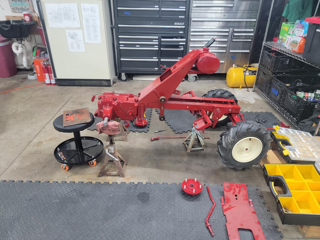

DBlackston 323 #19 Posted October 26, 2025 This is finally coming along, slowly but surely they say! I am going to have to make a brake rod after all. I purchased a set from a nice gentleman on here, but the actual rod is straight and appears to need to have a bend to clear the brake band mount itself. I have one mocked up and bent, just needs welded and threaded and I should be good to go. It does appear as well that my brake band was missing from the C-111. Looking back at pictures I can confirm this from when I picked it up. So I need to locate one of those as well. Since I have access to an EDM I have decided to cut a bushing for the input shaft on the 103916 8-speed to adapt to the SR-64 Pulley. This will let me use the original woodruff key and engage the keyway on the pulley. @ML3 that is a beautiful machine! I am going to have to get some custom decals made by @Vinylguy for this unit! 3 1 Share this post Link to post Share on other sites

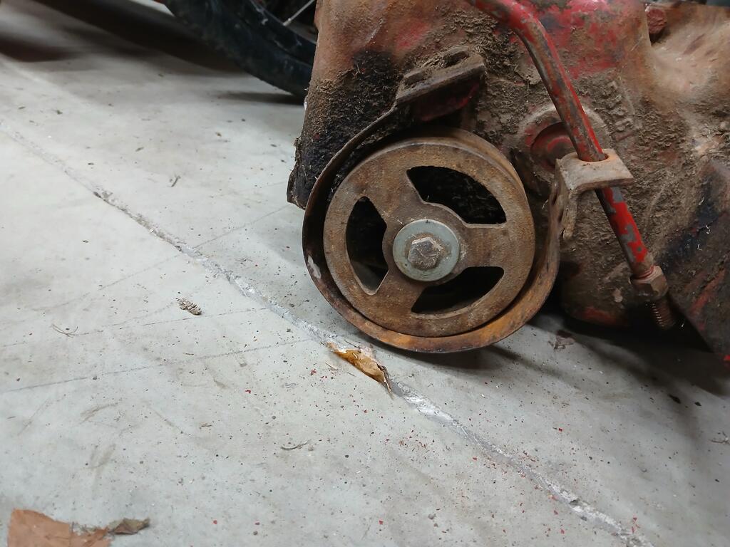

DBlackston 323 #20 Posted November 16, 2025 (edited) Does anyone know what brake bands will fit this? I am trying to locate one to buy. A picture I can compare to would be great! Edited November 16, 2025 by DBlackston Share this post Link to post Share on other sites
702854boy 527 #21 Posted November 16, 2025 1 hour ago, DBlackston said: Does anyone know what brake bands will fit this? I am trying to locate one to buy. A picture I can compare to would be great! I'll get a photo tomorrow sometime and post it in here if someone doesn't beat me to it. Share this post Link to post Share on other sites
702854boy 527 #22 Posted November 16, 2025 Here's the photo 1 Share this post Link to post Share on other sites
Handy Don 15,994 #23 Posted November 16, 2025 (edited) I’m sure other members are more attuned to this than I am and will correct me if I'm wrong, but I’ve handled bands from both three and six speeds as well as Eaton hydros. The only significant difference I’ve noticed is that some were made of thicker metal than others. Remarkably, even though the position and rotation of the drum changed going from 3/6 to 8/hydro, the engineers were able to use the same drum and band geometry Edited November 16, 2025 by Handy Don 2 Share this post Link to post Share on other sites
Racinbob 12,800 #24 Posted November 16, 2025 2 hours ago, Handy Don said: I’m sure other members are more attuned to this than I am and will correct me if I'm wrong, but I’ve handled bands from both three and six speeds as well as Eaton hydros. The only significant difference I’ve noticed is that some were made of thicker metal than others. Remarkably, even though the position and rotation of the drum changed going from 3/6 to 8/hydro, the engineers were able to use the same drum and band geometry I had a hunch that was the case. I have a few old bands and intended to check but I haven't done it. I know the rod is different. One goes over the drum and one straight to the band. Share this post Link to post Share on other sites
DBlackston 323 #25 Posted November 17, 2025 You can see the issue I have with the 3 speed band. It just doesn't fit the drum very well. Maybe there is enough contact for it to work though? Sorry for the bad picture, I just have a far away picture currently. I did make a new brake rod out of an extra rod I had laying around. 1 Share this post Link to post Share on other sites
