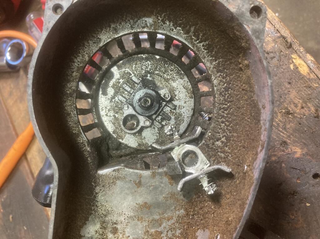

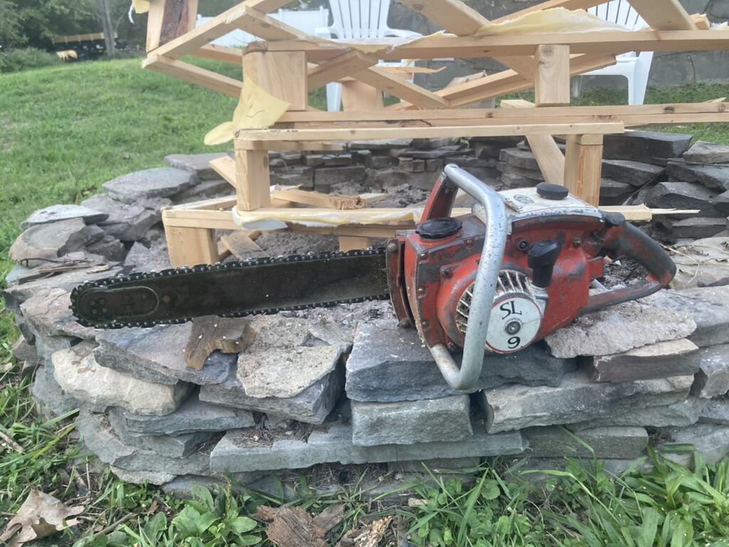

Ifixoldjunk 778 #1 Posted September 30, 2022 Hi y’all, I’ve been kinda not on this site lately. I’ve been sucked into the world of antique chainsaws. Haven’t been doing much with tractors unfortunately. I’ve recently obtained this 1964 Remington SL-9. It ran absolutely amazingly for a week or so, bucking up all manner of firewood. Until the recoil just randomly… exploded? It appears that a E-clip backed out and just launched the pawls into the spinning flywheel. Luckily, it seems that only the recoil was destroyed. The rest of the saw made out fine. I’ve already found a replacement recoil, but what steps can be taken to prevent this? Was it dumb luck? PO tinkering with it? Operator error? Anything I’m overlooking? The recoil was up there in price so I’d like to avoid exploding this one too. Thanks guys. 1 Share this post Link to post Share on other sites
gwest_ca-(File Mod) 12,489 #2 Posted September 30, 2022 E-clips are stamped when they are made so one side has rounded edges and the other side sharp edges. Install with the sharp edges against the side of the groove that will get the load. I can see how an E-clip could get flung off at high rpm. Would a retaining ring with two eyes be a better choice? 1 Share this post Link to post Share on other sites

elcamino/wheelhorse 9,363 #4 Posted September 30, 2022 What about the loose screw ? Did it drop into the flywheel when you took off the cover or did it cause the problem ? 1 Share this post Link to post Share on other sites
Ifixoldjunk 778 #5 Posted September 30, 2022 1 minute ago, elcamino/wheelhorse said: What about the loose screw ? Did it drop into the flywheel when you took off the cover or did it cause the problem ? Honestly, I hadn’t had the recoil off the saw until after it exploded. Seems like the only thing amiss was the E-clip Share this post Link to post Share on other sites
Ifixoldjunk 778 #6 Posted September 30, 2022 34 minutes ago, gwest_ca said: E-clips are stamped when they are made so one side has rounded edges and the other side sharp edges. Install with the sharp edges against the side of the groove that will get the load. I can see how an E-clip could get flung off at high rpm. Would a retaining ring with two eyes be a better choice? Perhaps. They originally all had E-clips from what I’ve seen, but a snap ring might be better. Don’t really see the E-clip spinning too fast since it should only move when you pull the rope. I’ll have to do more digging Share this post Link to post Share on other sites
