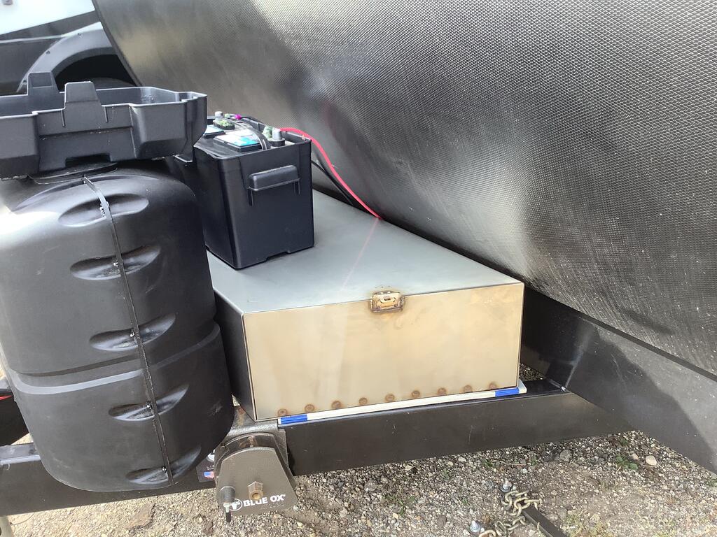

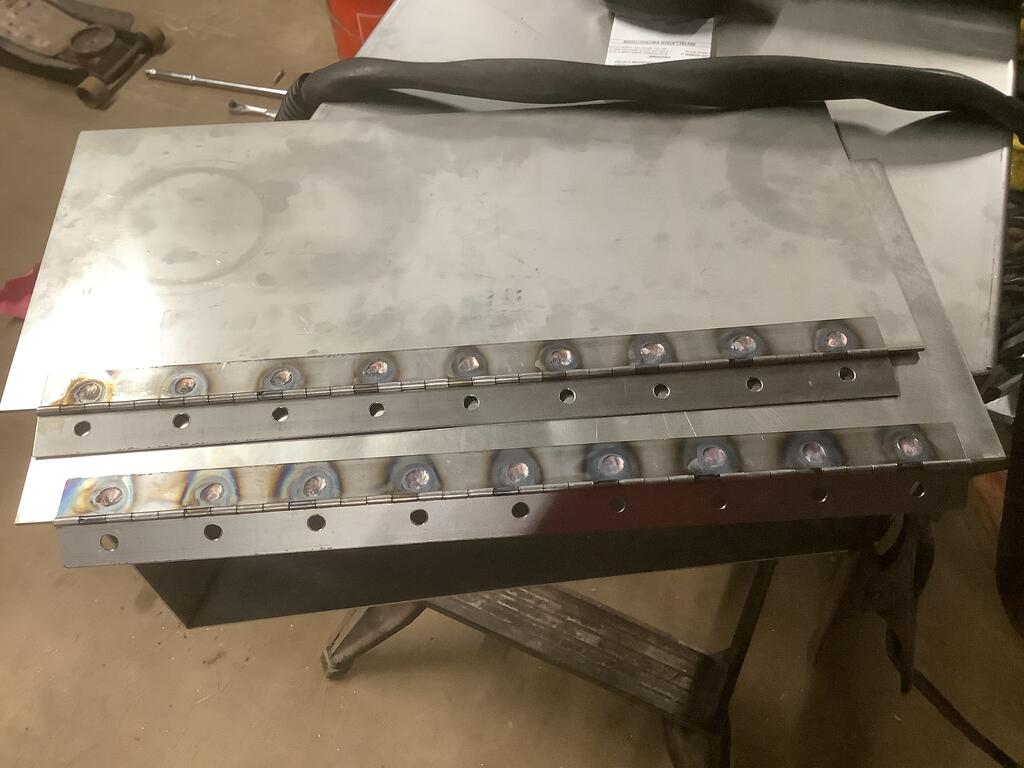

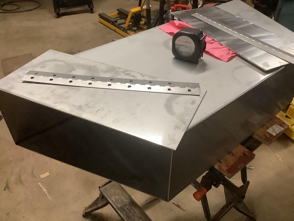

Pullstart 71,288 #1 Posted September 30, 2022 (edited) This box will accompany the tongue of a camper trailer. I need to fab the doors, latches and some mounts for the camper. Of course, I can’t weld on the trailer frame so everything will bolt on. I’ve got one set of hinges drilled and chamfered for plug welds. Edited September 30, 2022 by Pullstart 7 Share this post Link to post Share on other sites
ri702bill 13,084 #3 Posted September 30, 2022 7 hours ago, Pullstart said: drilled and chamfered for plug weld One of my favorite ways to attach two pieces of metal with a wire feed welder. - particularly two parts of different thicknesses. Gives a respectable finish and is a strong bond. You may wish to clamp it in place and begin welding in the middle first, otherwise the hinge may bend and buckle as it grows from the heat of welding. Think it is wise to seperate the leaves and reinstall the pin after?? Bill Share this post Link to post Share on other sites

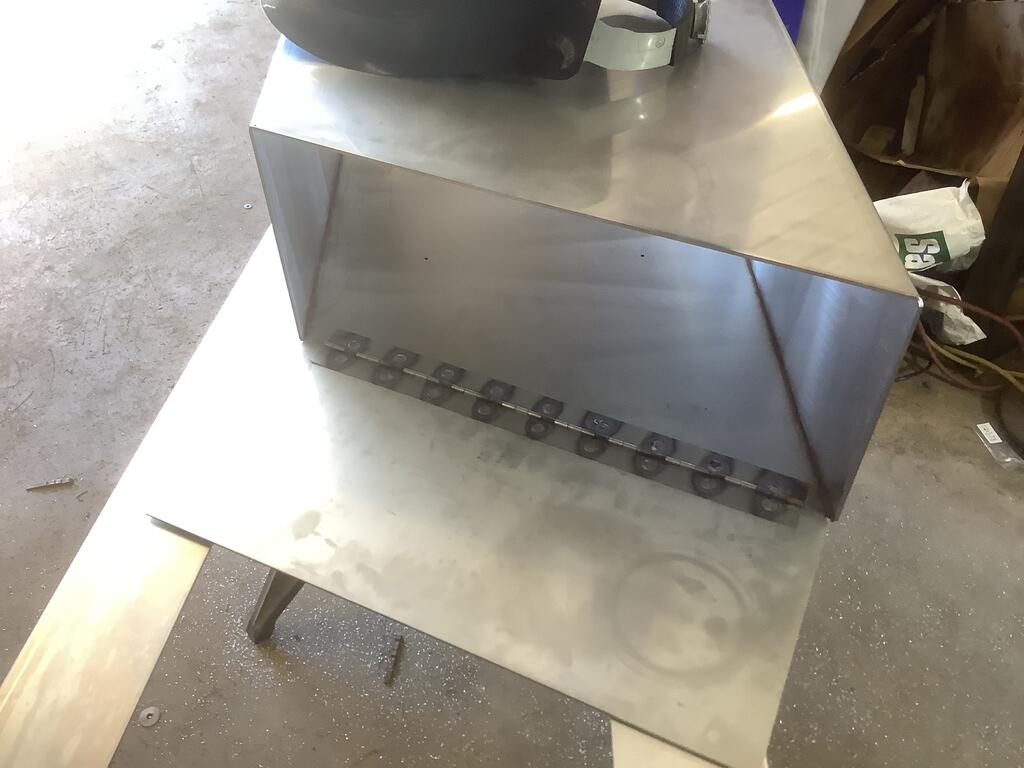

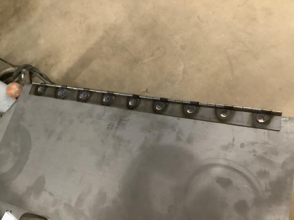

Pullstart 71,288 #4 Posted September 30, 2022 Hunting meese got me distracted last night. back at it! 15 hours ago, ri702bill said: wire feed welder. running the TIG on this one. It’s all stainless. Much cleaner in the end 6 1 Share this post Link to post Share on other sites

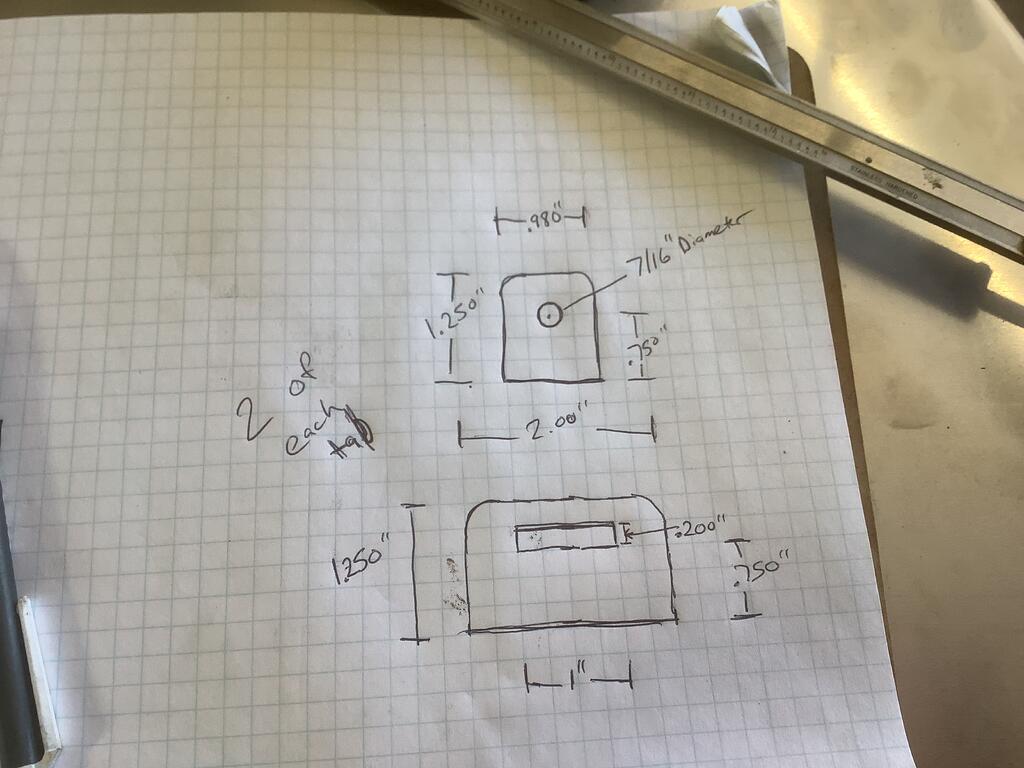

Pullstart 71,288 #5 Posted October 1, 2022 It’s dark outside and I need some daylight to do planning for the camper side of things. I need to verify mounting position before welding the doors to the box, need to verify clearance on a few things, etc. It’s good to have the TIG machine back up and going. I borrowed the plug from it for another something at some point so I grabbed another from the store and started laying beads. 5 Share this post Link to post Share on other sites
ri702bill 13,084 #6 Posted October 1, 2022 Good consistant welds, localized heat and no burn thrus. Hands, eyes, and foot co-ordination required. Ya could do that for a living if that farmin' thing don't work out.... 1 1 Share this post Link to post Share on other sites

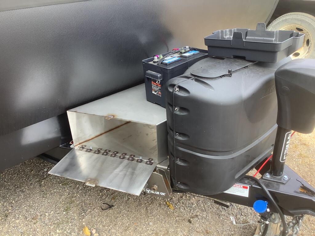

Pullstart 71,288 #7 Posted October 3, 2022 The customer came over yesterday and we did a dry fit up. It’s gonna work out better than expected! I need a couple tabs cut for the latches and it should finish up just sweet. 2 Share this post Link to post Share on other sites

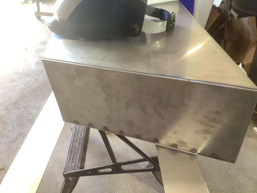

Pullstart 71,288 #9 Posted October 6, 2022 I just need to cut the blue tape off the spacer plates! 2 Share this post Link to post Share on other sites
