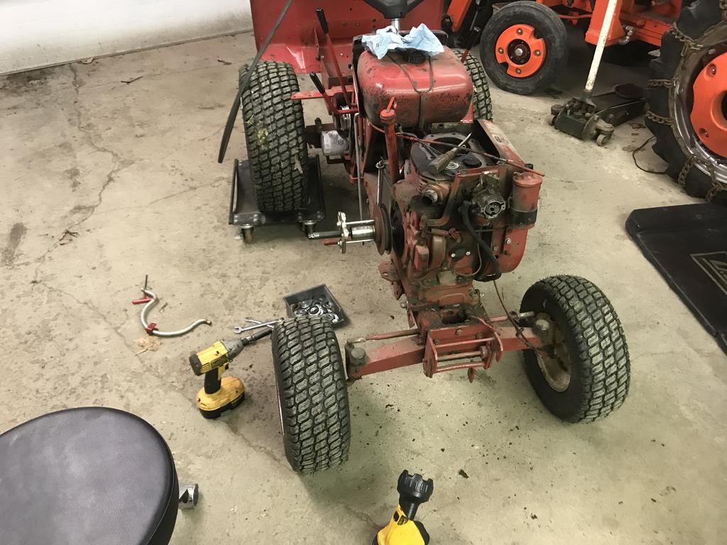

elcamino/wheelhorse 9,363 #26 Posted October 22, 2022 The pulley has a big piece missing from it , did not see it until I took off the drive belt which was eaten on one side. Ordered a new pulley and clutch from K&B. 1 1 Share this post Link to post Share on other sites

elcamino/wheelhorse 9,363 #29 Posted October 23, 2022 I have taken a good look at the sleeve but I don't think I could get behind it as it is now , may need to modify the pulley ( portaband, sawzall , cutting or grinding wheels ) . Need to think on it a bit more. Share this post Link to post Share on other sites
ebinmaine 81,289 #30 Posted October 23, 2022 6 minutes ago, elcamino/wheelhorse said: I have taken a good look at the sleeve but I don't think I could get behind it as it is now , may need to modify the pulley ( portaband, sawzall , cutting or grinding wheels ) . Need to think on it a bit more. I've only done this battle once that I can recall. Seems to me I didn't even realize what I was dealing with until the piece was part way off. I'm wondering if the piece that's actually stuck is that @#&$_() sleeve, not the pulley. Can you get a small diameter but strong punch in to the key? Share this post Link to post Share on other sites
elcamino/wheelhorse 9,363 #31 Posted October 24, 2022 Haven't tried that yet . Sound like a good idea. Share this post Link to post Share on other sites
elcamino/wheelhorse 9,363 #32 Posted October 24, 2022 I was able to push the key all the way back , dosed it with PB blast. How did you finally get the sleeve off ? Share this post Link to post Share on other sites
ebinmaine 81,289 #33 Posted October 24, 2022 5 minutes ago, elcamino/wheelhorse said: I was able to push the key all the way back , dosed it with PB blast. How did you finally get the sleeve off ? I know everybody has preferences and different experiences. Just as an FYI... I stopped using PB because I was not finding it worked very well at all. I've had much better results with either good old-fashioned Liquid Wrench old formula or WD-40 Penetrating Oil. NOT the regular WD. I will now step off my soapbox. IIFF that crankshaft has a keyway all the way out you may be able to get that groove cleaned out below the PTO sleeve. I do remember using pretty good amounts of heat to get that sleeve to move. That was a few years ago now so I'm not positive but I feel like I was using a three jaw puller on the back of the pulley. Another way of doing it would be to drive a large screwdriver down behind the pulley against the block. Do that on each side of course. That can put some serious pressure on the pulley in the outward direction. There are those that would suggest getting the screwdrivers behind the pulley and the three jaw puller all working together and then give the end of the puller a decent smack. I would have some concerns about doing that for fear of damaging crankshaft bearings. 1 Share this post Link to post Share on other sites
squonk 48,429 #34 Posted October 24, 2022 (edited) Pulley has screw holes for the clutch. You need a bolt grip (Harmonic balancer) puller. Use the holes i nthe pulley and seat the puller bolts well. May need to chase the threads in the pulley. A little heat and the pulley and sleeve will come off together. Do not use a 3 jaw puller!!! Edited October 24, 2022 by squonk 3 Share this post Link to post Share on other sites

elcamino/wheelhorse 9,363 #40 Posted October 27, 2022 A few days have passed and the fun did not continue . Got all the rims primed and painted ,had them in the shed near the wood stove to bake. (Monday & Tuesday ). Have been using a HF bearing puller on the brown welded pulley and bearing sleeve. Yesterday I did my normal grocery shopping and stopped in at the blue box store for map gas.None to be found or cylinders of propane. Ended up at my brother's for a BS session and where can I buy map gas. He answered blue box store , gave him the answer NO. Out comes his fancy phone. Scroll , scroll , son of a gun. He digs around in one of his magic 5 gallon buckets ( @Ed Kennell did not know you gave lessons on magic buckets ) and pulls out 2 cylinders of map gas and torch . Hot dog I am ready for today. Took a while for me to start moving and finally made it to tractor house. Decided to add more pressure to puller , big bang and now I have another big of pulley missing. Son of &&*((&*^ dig in to all bolts I have to find right size to try @squonk suggestion on removing pulley. Another trip to blue box store found 4 bolts and bought 2 extras just in case. Ate lunch and took a nap. Waldomobile can wait another day. 1 2 1 Share this post Link to post Share on other sites

elcamino/wheelhorse 9,363 #42 Posted October 28, 2022 (edited) The score is Waldo big fat zero and the pulley laughed . Applied heat for a long time about an hour,may have moved the pulley a 1/16 of an inch more like a 1/32 of an inch. Looked on line at harmonic balance remover from HF , but it only has 2 slots for bolts not 4 as @squonk 's . The portaband or Sawzall is looking like the answer to my problem. Guess I will have to order a new seal for the crank if I ever get the $%^&*() pulley off. Will work again tomorrow on the cast iron devil. Did get the front wheels back on the mobile and primed the inside of the hood ( bonnet ) for the other side of the pond. Rest period now in order . Edited October 28, 2022 by elcamino/wheelhorse left out word 1 Share this post Link to post Share on other sites

squonk 48,429 #44 Posted October 28, 2022 1 hour ago, elcamino/wheelhorse said: The score is Waldo big fat zero and the pulley laughed . Applied heat for a long time about an hour,may have moved the pulley a 1/16 of an inch more like a 1/32 of an inch. Looked on line at harmonic balance remover from HF , but it only has 2 slots for bolts not 4 as @squonk 's . The portaband or Sawzall is looking like the answer to my problem. Guess I will have to order a new seal for the crank if I ever get the $%^&*() pulley off. Will work again tomorrow on the cast iron devil. Did get the front wheels back on the mobile and primed the inside of the hood ( bonnet ) for the other side of the pond. Rest period now in order . This is the style puller you need Waldo. Only use the 2 holes across from each other. I have the Snap on version which is now close to 45 yrs. old. Napa #7769062 $16 You will probably break it. Just throw the tractor in the truck and drive 10 hrs. up here. I'll only charge you dinner out at the BBQ joint up the road. You can stay At @rjg854's. I'm sure he won't mind. I won't even tell him you're coming. It will be a surprise! 1 2 Share this post Link to post Share on other sites
