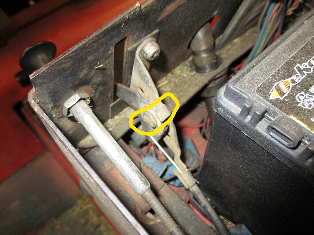

pfrederi 21,302 #4 Posted September 22, 2022 If the throttle handle moves very easily take it out give the pivot a couple whacks with a hammer while blocked against something ...or drill it out use a bolt and nylock nut 3 2 Share this post Link to post Share on other sites

c-series don 12,656 #6 Posted September 22, 2022 My 416-H does the same thing. I tried squeezing the pivot point with vice grips but it didn’t help. I’ll have to try @pfrederi’s idea and take it out and smashing it! 1 1 Share this post Link to post Share on other sites

pacer 3,181 #8 Posted September 22, 2022 I suspect @pfrederi solution will be what you will end up having to do. It works strictly on friction and with age it slowly loosens. Hopefully a "whack" will tighten it up, but just may have to put a bolt/washers there. 3 Share this post Link to post Share on other sites

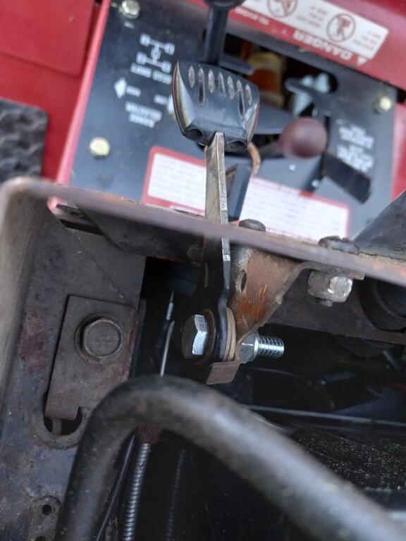

Handy Don 17,671 #9 Posted September 23, 2022 On 9/22/2022 at 3:36 PM, pacer said: I suspect @pfrederi solution will be what you will end up having to do. It works strictly on friction and with age it slowly loosens. Hopefully a "whack" will tighten it up, but just may have to put a bolt/washers there. I'm a fan of a shoulder bolt, flat washer, and nylock nut (with all the original washers and spacers in their original positions). The shoulder keeps the pivoting lever and bracket from getting worn by the sharp threads and the nut lets you adjust the friction to your liking easily. 2 1 Share this post Link to post Share on other sites
Rick3478 477 #10 Posted September 24, 2022 On 9/22/2022 at 1:24 PM, c-series don said: My 416-H does the same thing. I tried squeezing the pivot point with vice grips but it didn’t help. I’ll have to try @pfrederi’s idea and take it out and smashing it! I've used the vice grip method myself with success. You have to use a large one to get enough mash on the rivet. The advantage is that you don't have to take anything apart. Bolt & nut is probably best long term. 5 Share this post Link to post Share on other sites

Panther416-8 342 #15 Posted September 25, 2022 I drilled out the large rivet as per @pfrederi using a 1/4" bit , kept the fiber washers and used a bolt and nylon lock nut. Works perfectly now, stays wherever i set it. Thanks all for the suggestions. 2 1 Share this post Link to post Share on other sites

gwest_ca-(File Mod) 12,533 #21 Posted September 27, 2022 1 hour ago, kpinnc said: My 520-H does the same thing. I never considered adding a bolt and nylock. That's a great idea, and I will be doing this myself! Use a bolt with enough unthreaded shank to go all the way through the assembly plus a bit. Add flat washers to the outside so the nylock nut has room for future adjustment. You can reach in with two wrenches to adjust as necessary. 2 Share this post Link to post Share on other sites
Horse Newbie 7,405 #22 Posted September 27, 2022 (edited) On 9/22/2022 at 12:28 PM, pfrederi said: If the throttle handle moves very easily take it out give the pivot a couple whacks with a hammer while blocked against something ...or drill it out use a bolt and nylock nut Because my throttle knob did not want to come off easily and I was about to tear it up, and the fact that to drill it out you have to probably take the throttle lever mechanism completely out to drill it, I reached in there with some vice grips and squeezed the pivot rivet a little and that made it tight enough to where mine on my 520 H stays where I put it now… Edited September 27, 2022 by Horse Newbie 1 Share this post Link to post Share on other sites
