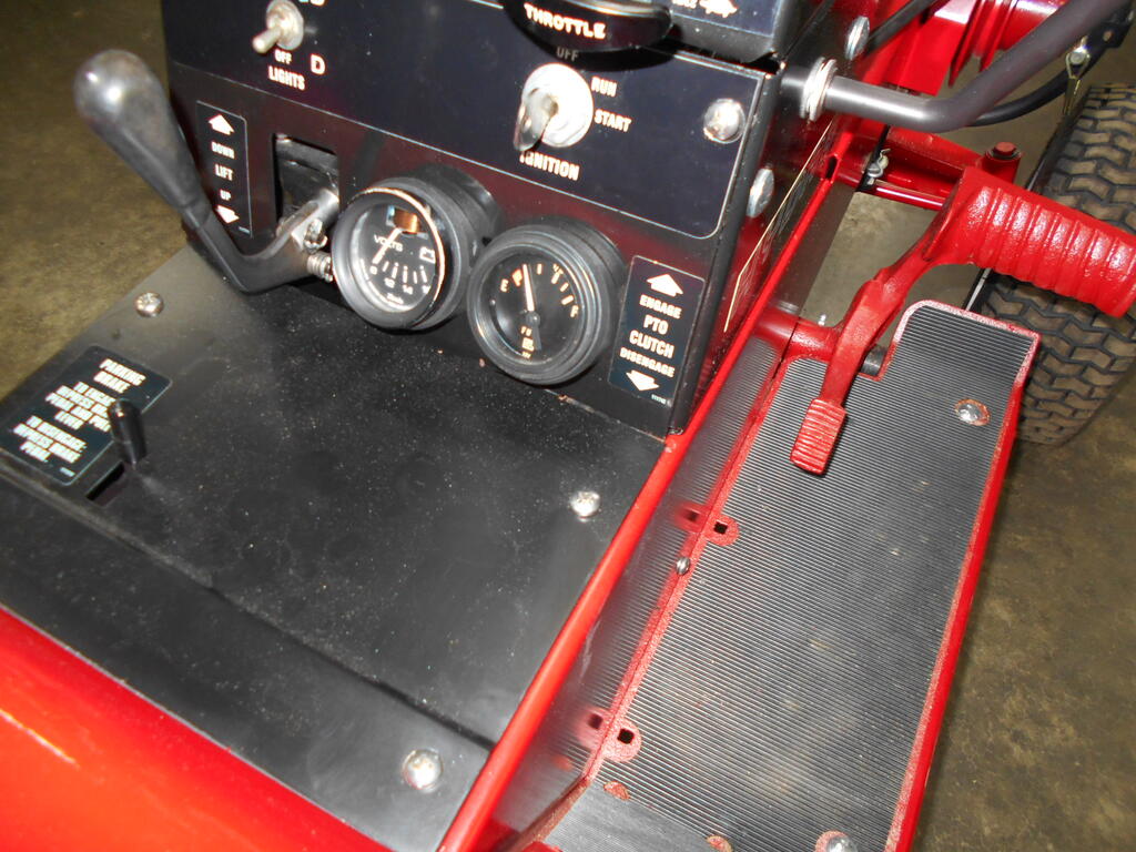

Handy Don 17,484 #26 Posted September 21, 2022 Just now, WHX?? said: Wow and I thought I was a 520 hog.. I had five but give one to Dan just to share the misery. Might be mistaken EB but same tank across the 3 4 500s. Take a 520 tank with the sending unit and slide it under a 300 and add the gauge & appropriate wiring. Hey EB, just happen to have a tank with a sending unit (no gauge, though). 1 Share this post Link to post Share on other sites
ebinmaine 80,759 #27 Posted September 21, 2022 2 minutes ago, WHX?? said: Wow and I thought I was a 520 hog.. I had five but give one to Dan just to share the misery. Might be mistaken EB but same tank across the 3 4 500s. Take a 520 tank with the sending unit and slide it under a 300 and add the gauge & appropriate wiring. Neat. I have three 400 series tractors here. All have the gauge in the fuel cap on the tank. Didn't know the 520s had a separate gauge on the dash. I'd like to find a universal one with a universal sending unit that I could wire up into Cinnamon Horse and also Colossus. Two very different size tanks though. 1 Share this post Link to post Share on other sites
Handy Don 17,484 #28 Posted September 21, 2022 1 minute ago, ebinmaine said: Neat. I have three 400 series tractors here. All have the gauge in the fuel cap on the tank. Didn't know the 520s had a separate gauge on the dash. I'd like to find a universal one with a universal sending unit that I could wire up into Cinnamon Horse and also Colossus. Two very different size tanks though. The sending units on the WH tanks fit into a separate opening on the tank. Nothing fancy, but the plastic around it was molded smooth so the gasket would seal properly. A while back @Ed Kennell found a source for sending units of different sizes and with adjustments for different sending voltage ranges but I can't find the thread just now. Gauges are about $25 new all over the net. 1 1 Share this post Link to post Share on other sites
Bow_Extreme 584 #29 Posted September 21, 2022 51 minutes ago, WHX?? said: Wow and I thought I was a 520 hog.. I had five but give one to Dan just to share the misery. Might be mistaken EB but same tank across the 3 4 500s. Take a 520 tank with the sending unit and slide it under a 300 and add the gauge & appropriate wiring. I might have a few….lol. 520-8 520HC 520 Power Steering Prototype 520H Custom 1 2 Share this post Link to post Share on other sites
ebinmaine 80,759 #30 Posted September 21, 2022 2 minutes ago, Bow_Extreme said: Power Steering Prototype That's a cool one 2 Share this post Link to post Share on other sites

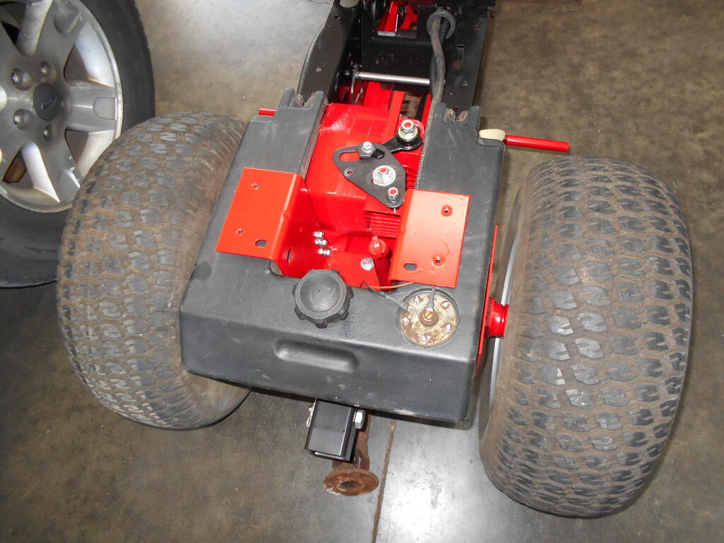

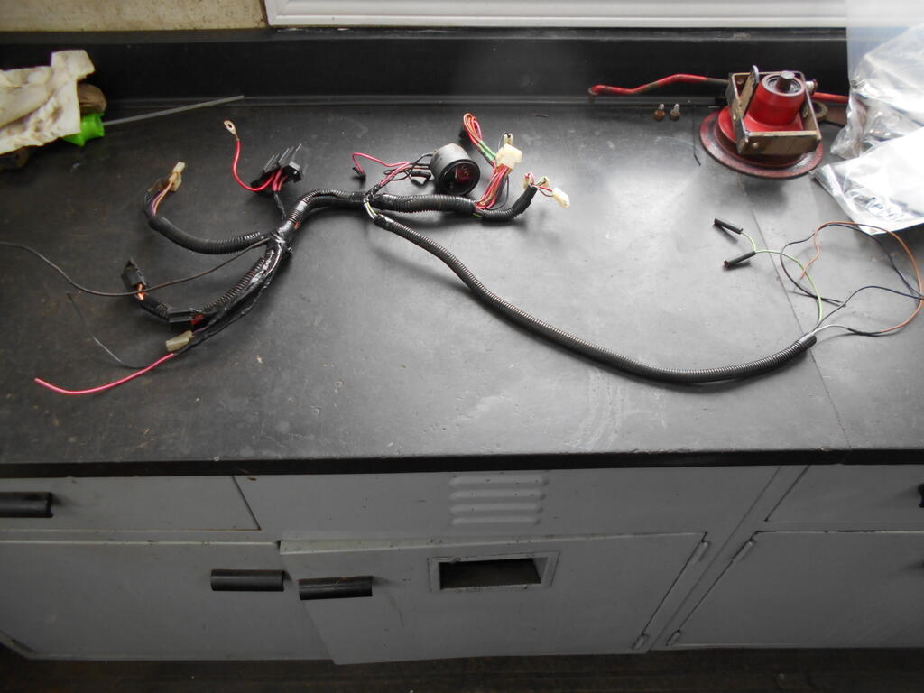

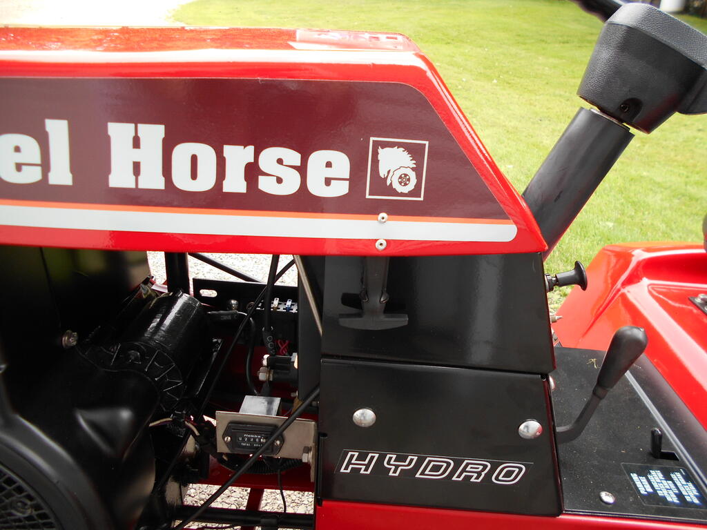

cleat 9,337 #31 Posted September 21, 2022 2 hours ago, ebinmaine said: Got any info on that? I used a 520H fuel tank and gauge in my 312H. Just had to add the appropriate wires to the harness and I mounted the gauge where the hourmeter was and installed a small hourmeter in an alternate location. Here is the fuel gauge in the dash with angle rings so I can see it easier. Here is the 520H fuel tank with sender unit. It fits the same as the original tank. Here is the small hour meter. Fuel gauge.pdf This is the wiring diagram This is the wire harness almost complete, just needs the last connectors installed. 1 1 Share this post Link to post Share on other sites
cleat 9,337 #32 Posted September 21, 2022 2 hours ago, ebinmaine said: Got any info on that? I used a 520H fuel tank and gauge in my 312H. Just had to add the appropriate wires to the harness and I mounted the gauge where the hourmeter was and installed a small hourmeter in an alternate location. Here is the fuel gauge in the dash with angle rings so I can see it easier. Here is the 520H fuel tank with sender unit. It fits the same as the original tank. Here is the small hour meter. Fuel gauge.pdf This is the wiring diagram This is the wire harness almost complete, just needs the last connectors installed. 1 Share this post Link to post Share on other sites
cleat 9,337 #33 Posted September 21, 2022 2 hours ago, ebinmaine said: Got any info on that? I used a 520H fuel tank and gauge in my 312H. Just had to add the appropriate wires to the harness and I mounted the gauge where the hourmeter was and installed a small hourmeter in an alternate location. Here is the fuel gauge in the dash with angle rings so I can see it easier. Here is the 520H fuel tank with sender unit. It fits the same as the original tank. Here is the small hour meter. Fuel gauge.pdf This is the wiring diagram This is the wire harness almost complete, just needs the last connectors installed. 1 Share this post Link to post Share on other sites
cleat 9,337 #34 Posted September 21, 2022 Don't know why that was posted 3 times. Can a moderator delete the extra posts please. 1 2 Share this post Link to post Share on other sites
Ed Kennell 47,398 #35 Posted September 21, 2022 5 hours ago, Handy Don said: The sending units on the WH tanks fit into a separate opening on the tank. Nothing fancy, but the plastic around it was molded smooth so the gasket would seal properly. A while back @Ed Kennell found a source for sending units of different sizes and with adjustments for different sending voltage ranges but I can't find the thread just now. Gauges are about $25 new all over the net. I don't remember this Don. But....now where are my glasses? 2 2 Share this post Link to post Share on other sites
ebinmaine 80,759 #36 Posted September 21, 2022 35 minutes ago, Ed Kennell said: I don't remember this Don. But....now where are my glasses? Check the top of your head. That's where mine usually are when I've lost them...... 1 2 Share this post Link to post Share on other sites

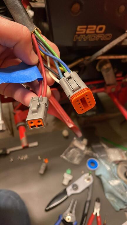

Horse Newbie 7,405 #37 Posted September 21, 2022 10 hours ago, Bow_Extreme said: DT & DTP connectors Can we get a pic of those ? 1 Share this post Link to post Share on other sites

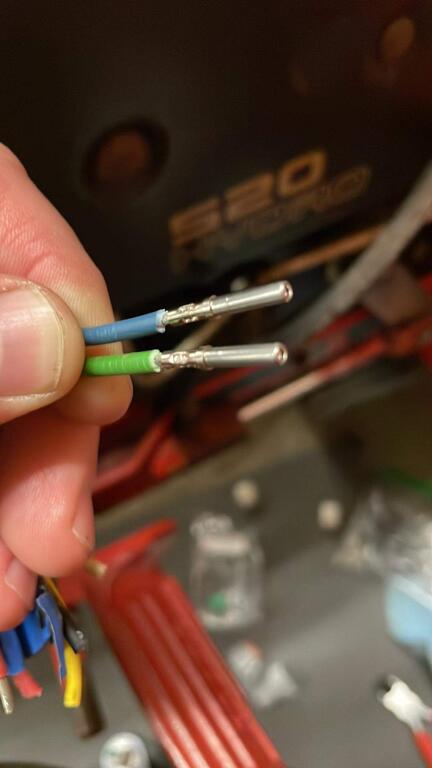

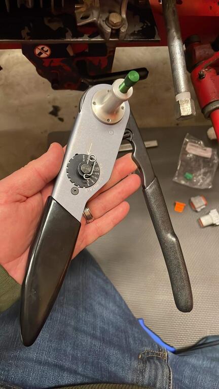

Bow_Extreme 584 #48 Posted September 26, 2022 On 9/21/2022 at 6:09 PM, Horse Newbie said: Can we get a pic of those ? 1 1 Share this post Link to post Share on other sites
