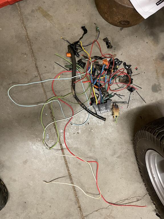

Bow_Extreme 583 #1 Posted September 21, 2022 Well, slowly gaining on a full repair. This is the mess I took out. Will most likely be the last of it, I hope. 2 Share this post Link to post Share on other sites
ebinmaine 80,083 #2 Posted September 21, 2022 Nothing quite like a nice multi color birds nest. 2 Share this post Link to post Share on other sites
Bow_Extreme 583 #3 Posted September 21, 2022 4 minutes ago, ebinmaine said: Nothing quite like a nice multi color birds nest. Agreed! Pretty typical on most 520’s. 2 Share this post Link to post Share on other sites
ebinmaine 80,083 #4 Posted September 21, 2022 Just now, Bow_Extreme said: Agreed! Pretty typical on most 520’s. Yessir. Some of the 70s rigs we've gotten into had some interesting PO "repairs" on the wiring. 1 1 Share this post Link to post Share on other sites
Pullstart 71,004 #5 Posted September 21, 2022 You da wiring man Matt! 1 2 Share this post Link to post Share on other sites
Rob J. 1,942 #6 Posted September 21, 2022 10 minutes ago, ebinmaine said: Yessir. Some of the 70s rigs we've gotten into had some interesting PO "repairs" on the wiring. I just don’t understand why people mess with original stuff like wiring. It’s one thing to replace a wire because it’s worn or frayed but to turn what once was neat and organized into a rats nest is beyond me. 4 1 Share this post Link to post Share on other sites
ebinmaine 80,083 #7 Posted September 21, 2022 Just now, Rob J. said: I just don’t understand why people mess with original stuff like wiring. It’s one thing to replace a wire because it’s worn or frayed but to turn what once was neat and organized into a rats nest is beyond me. We had a '73 12 Auto here that I was dismantling for parts. The ignition switch has been replaced with a 4 position automotive switch and ALL the wires were hacked off at the end. Uninsulated butt connectors everywhere. Just. Silly. The cost of all that garbage was likely twice that(+) of a correct plug n play switch. 4 Share this post Link to post Share on other sites

Bow_Extreme 583 #9 Posted September 21, 2022 (edited) 23 minutes ago, ebinmaine said: We had a '73 12 Auto here that I was dismantling for parts. The ignition switch has been replaced with a 4 position automotive switch and ALL the wires were hacked off at the end. Uninsulated butt connectors everywhere. Just. Silly. The cost of all that garbage was likely twice that(+) of a correct plug n play switch. Where would we all be without projects like this?….lol. That’s right, enjoying more seat time and probably buying more tractors…lol Edited September 21, 2022 by Bow_Extreme 4 Share this post Link to post Share on other sites

ri702bill 12,696 #13 Posted September 21, 2022 And I only see one toasted connector!! As @peter lena would tell you, now is the time to add additional grounds and use the dielectric grease... 3 2 Share this post Link to post Share on other sites
Bow_Extreme 583 #14 Posted September 21, 2022 1 hour ago, ri702bill said: And I only see one toasted connector!! As @peter lena would tell you, now is the time to add additional grounds and use the dielectric grease... Standard procedure. All connectors are cleaned, replaced if needed, and packed full of di-electric grease before reassembly. The engine harness connector is replaced with Deutsch DT & DTP connectors. The Deutsch connectors are the only not original items on the tractor. I’m trying to keep this one original as possible. 2 5 Share this post Link to post Share on other sites
