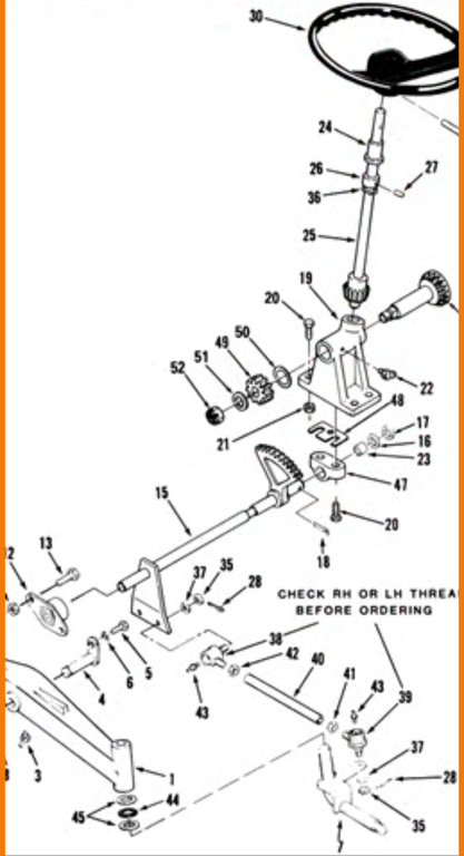

ebinmaine 79,638 #109 Posted October 28, 2023 Just posting this link for future reference. We'll be installing a gear reduction steering system and I wanted to see what exactly it looks like. 2 Share this post Link to post Share on other sites
Horse Newbie 7,405 #110 Posted October 28, 2023 What exactly is the difference between a gear-reduction set up and a regular set up. I can’t see a difference, but maybe there’s a component in there I am missing… 1 Share this post Link to post Share on other sites
ebinmaine 79,638 #111 Posted October 28, 2023 4 minutes ago, Horse Newbie said: What exactly is the difference between a gear-reduction set up and a regular set up. I can’t see a difference, but maybe there’s a component in there I am missing… In the above pic, item 19 steering block carries a cross shaft the mates the gear on the lower end of the vertical steering column which goes to the wheel. That cross shaft has an extra gear that doubles the amount of turns for the steering wheel, thereby cutting the required effort of the operator in half. 1 Share this post Link to post Share on other sites
Horse Newbie 7,405 #112 Posted October 28, 2023 5 minutes ago, ebinmaine said: In the above pic, item 19 steering block carries a cross shaft the mates the gear on the lower end of the vertical steering column which goes to the wheel. That cross shaft has an extra gear that doubles the amount of turns for the steering wheel, thereby cutting the required effort of the operator in half. Physics…and geometry…? 2 Share this post Link to post Share on other sites
Handy Don 16,938 #113 Posted October 28, 2023 Just now, Horse Newbie said: Physics…and geometry…? Half the force, twice the distance = same work! 3 Share this post Link to post Share on other sites
Horse Newbie 7,405 #114 Posted October 28, 2023 The extra turns on the steering wheel is worth it… feels like power steering.. 1 2 1 Share this post Link to post Share on other sites
ebinmaine 79,638 #115 Posted October 28, 2023 Just now, Horse Newbie said: feels like power steering.. That's what we're going for. 1 Share this post Link to post Share on other sites
