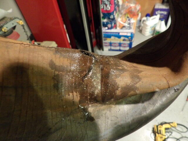

Evguy 567 #26 Posted September 29, 2022 12 hours ago, Snoopy11 said: This was... more than a slow leak... Don Stick a patch on, its fine 1 Share this post Link to post Share on other sites

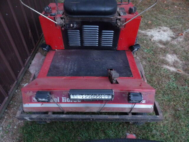

Snoopy11 5,731 #27 Posted October 2, 2022 Snoopified... and added some extra lights... (I realized that I couldn't see the sides of the mowing deck when I run the machine in the dark)... Don 2 6 Share this post Link to post Share on other sites

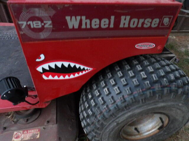

Snoopy11 5,731 #28 Posted October 8, 2022 'das bright.... Don 5 4 Share this post Link to post Share on other sites

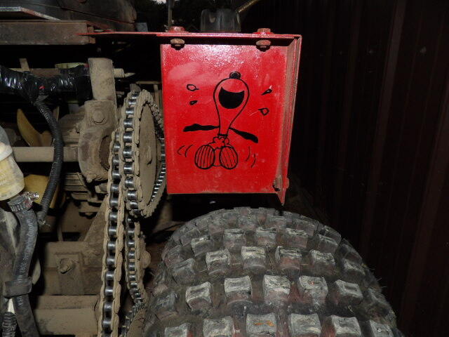

peter lena 10,103 #29 Posted October 9, 2022 @Snoopy11 like your progress , just steadily getting after everything! would get after related belt drive bouncing on deck , maybe add a couple of idler pulleys ? same idea on the long unsupported chain drive set up , maybe a bolt on bracket with a chain idler sprocket just to control that chain flop , detail in those front swivel wheels , often have serious drag issues . that w/d 40 spray definitely helped looks , paint feed . also detail in those drive levers , probably loaded with play/ sloppy action . pete 1 Share this post Link to post Share on other sites
Snoopy11 5,731 #30 Posted October 9, 2022 (edited) 9 hours ago, peter lena said: @Snoopy11 like your progress , just steadily getting after everything! would get after related belt drive bouncing on deck , maybe add a couple of idler pulleys ? same idea on the long unsupported chain drive set up , maybe a bolt on bracket with a chain idler sprocket just to control that chain flop , detail in those front swivel wheels , often have serious drag issues . that w/d 40 spray definitely helped looks , paint feed . also detail in those drive levers , probably loaded with play/ sloppy action . pete Thanks @peter lena... I appreciate the pep talk. There is a bit of slop in the drive levers. I haven't quite decided what I want to do about that. When I move them together to start moving, they touch each other... it's a little annoying, honestly... In other news... you know... Pete I started growing a beard a couple of months ago... just to top off the goatee... and I use Lucas grease to keep it all slicked back and under control.... Don Edited October 9, 2022 by Snoopy11 1 2 Share this post Link to post Share on other sites
Evguy 567 #31 Posted October 9, 2022 to start moving, they touch each other... it's a littleannoying, honestly... I had a thought of cutting 1/2 inch off each. Or a bit of weld on the stop block. Jerry 1 1 Share this post Link to post Share on other sites
Snoopy11 5,731 #32 Posted October 9, 2022 3 hours ago, Evguy said: I had a thought of cutting 1/2 inch off each. Or a bit of weld on the stop block True, I thought about a bit of weld as well. I didn't think about cutting them... maybe another good option... Honestly though... after a full day of mowing with it... I really don't ever notice it to be an issue... funny how you can unconsciously train yourself... Don 2 Share this post Link to post Share on other sites
