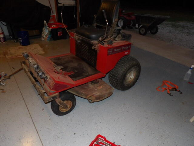

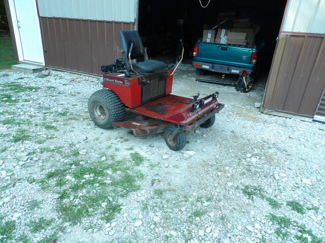

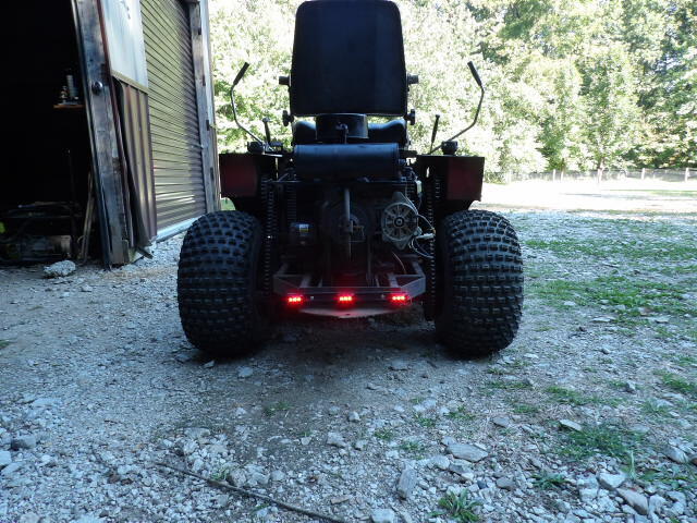

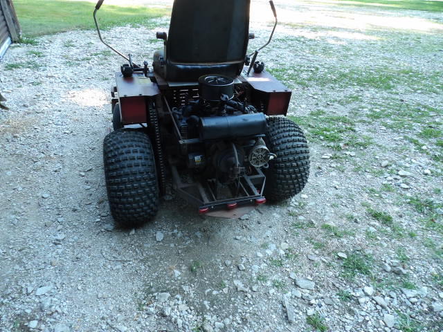

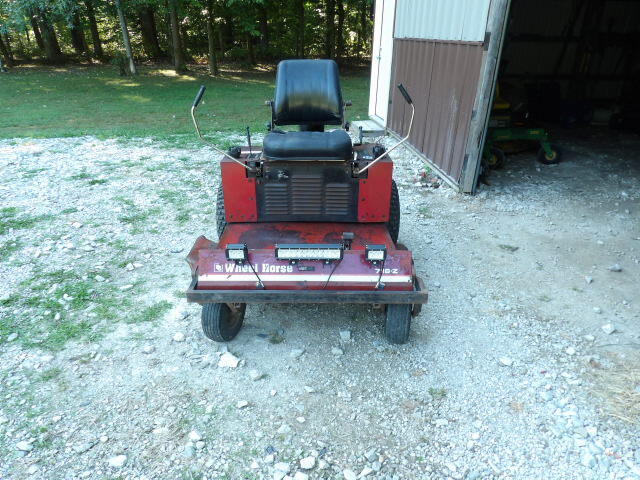

Snoopy11 5,731 #1 Posted September 18, 2022 (edited) Hello my good people, A few of you know that I have been wanting to add something new and red to the shop. WELL, on Friday, I moved the money into my PayPal account from the savings to buy @Evguy's Wheel Horse 718-Z... which I feel lucky and privileged to be buying. I have some pictures of it, and some goodies for you guys to drool over. Jerry is going to bring it down to me on the 24th... Belt for alternator: It can also fly... I am creating this thread now, hopefully some of you will be able to offer some additional information/advice on this machine before it comes home. Otherwise, this will be a project that I begin after the leaves die down some and I get a chance to do some painting and such. Jerry has done some excellent electrical work on this machine with the alternator... time for me to continue to improve it. I have already bought a light kit and a few other goodies for it... LOL Hopefully this machine will be around for a good long time! Don Edited September 18, 2022 by Snoopy11 2 6 Share this post Link to post Share on other sites

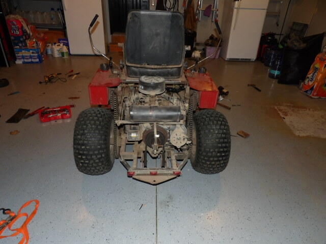

Snoopy11 5,731 #4 Posted September 18, 2022 Things that Jerry has already gone through on this machine (he's pretty good, isn't he?) Battery replacement Rear Tires replaced Muffler patch small holes Chains tensioned, shortened Alternator installed, heat shield added Repair wiring, regulator ground Free up deck, lubricate, add missing spring Lube brake and PTO levers for proper operation . Grease fittings greased Lubricant pivot points Starter lubricate, loose front bushing Pto disc replacement and adjust Adjusted parking brakes Motor axle drive woodruff keys replaced Oil change and filter, 30 weight Hydraulic motor oil change, 30 weight Chains lube Seat pan, add support plate Adjusted motion control levers and stops Don 2 1 Share this post Link to post Share on other sites

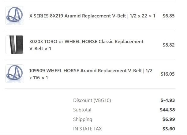

Snoopy11 5,731 #5 Posted September 19, 2022 Sent Jerry payment for the zero turn this morning, and got some belts ordered from V-belt guys Don 1 1 Share this post Link to post Share on other sites

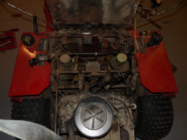

Heatingman 977 #6 Posted September 19, 2022 Thats pretty cool. I wonder if the manual has a brakedown of the wheel drive set up. I tried looking it up, but everything looks more modern. Ive been wondering about what it would take to make a DIY version of a zero turn, using just pulleys and belts. Back in my tire changing days when the landscapers would pul up with the commercial zero turns, those seemed to just use levers to engage the wheels one way or the other, or not at all based on lever action. Probably more to it then I remember, but definitely probably easier or less expensive to replicate then using hydraulics and wheel motors. 1 Share this post Link to post Share on other sites
Snoopy11 5,731 #7 Posted September 19, 2022 Do this help... @Heatingman? Tractor 1987 718-Z Z1-18KE02 TIPL-1.pdf Don Share this post Link to post Share on other sites
Heatingman 977 #8 Posted September 19, 2022 5 minutes ago, Snoopy11 said: Do this help... @Heatingman? Tractor 1987 718-Z Z1-18KE02 TIPL-1.pdf 2.51 MB · 2 downloads Don Maybe, but that looks different then I imagined. Looks like their is a single central gearbox that drives independent gear boxes per wheel. So…not sure how that work to be able to rotate the wheels in opposite direction, or one at a time. 1 Share this post Link to post Share on other sites

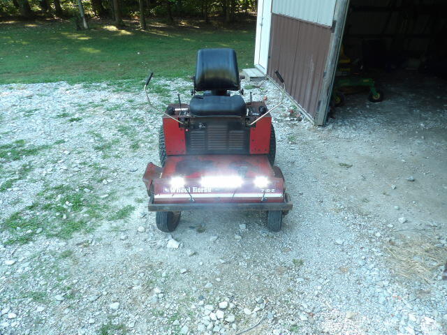

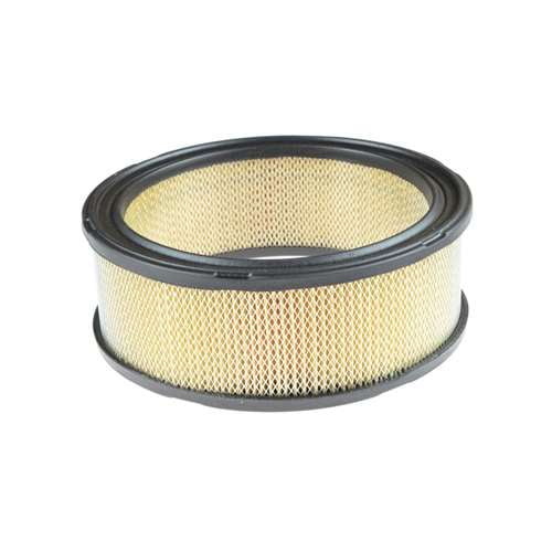

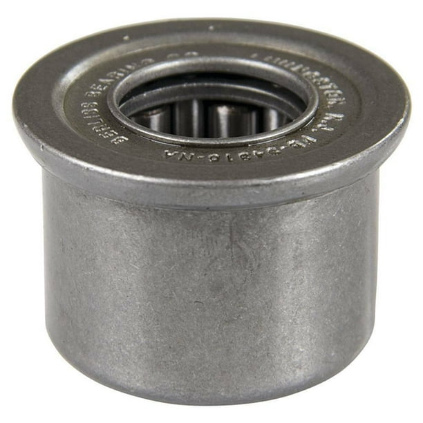

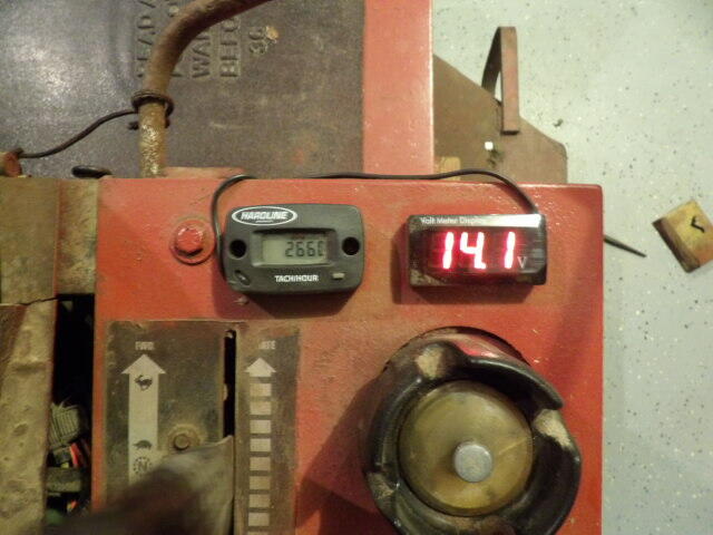

Snoopy11 5,731 #14 Posted September 20, 2022 Things I have bought so far for Z LOTS AND LOTS AND LOTS of primer and paint (just to have on hand) regal red and high heat for the engine parts. Some wire loom (and good wire) Tachometer (1 for Z, 1 for the tractor of my choice): Voltage gauge (1 for Z, 1 for the 416-8): Stens 215-267 Needle bearings (I am out of stock of these in the shop, so I bought 4 of them). @peter lena... I have some good red Lucas grease in the shop for these. A light kit, complete with front lights, rear lights, and marine switches: As well as the belts that I have mentioned above. I also bought a few maintenance items... air filter... oil (just because I am getting low in the shop stock) and I'll get some spark plugs and such once I have the machine in the shop. Blades: Let's just say, I've been doing a lot of binnus' with Walmart.com... LOL This machine is going to be and I'm just getting started. Don 1 1 Share this post Link to post Share on other sites
Heatingman 977 #15 Posted September 20, 2022 Those flanged needle bearings, for the wheels? Share this post Link to post Share on other sites
Snoopy11 5,731 #16 Posted September 20, 2022 2 minutes ago, Heatingman said: Those flanged needle bearings, for the wheels? Yessir. I have a thread about them... and they are absolutely awesome... I haven't had a set of them fail... ever... Don 2 Share this post Link to post Share on other sites
Snoopy11 5,731 #17 Posted September 20, 2022 5 minutes ago, Heatingman said: for the wheels? For the front wheels... I should add... Don 1 Share this post Link to post Share on other sites

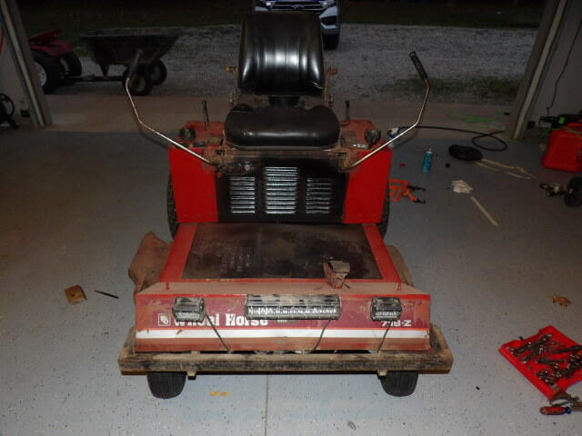

Snoopy11 5,731 #20 Posted September 24, 2022 @Evguy swung by and dropped off Z. Unfortunately, as much as I wanted to... I didn't get to really meet you, Jerry... (personal reasons which you and a few other members on the forum are aware of). Maybe some time in the future we can get together... maybe even give me a call some time! Anyway... I'm not sure if you hurt that front tire or not, Jerry when you unloaded it. It didn't hold air the first time I pumped it up... seems to be holding now though... I found a large crack in the right fuel tank which I repaired... was weeping a bit of fuel. Sprayed the machine down with some WD40... which made it look a million times better... Don 2 4 Share this post Link to post Share on other sites
Snoopy11 5,731 #21 Posted September 24, 2022 Oh, I also got some of the engine parts painted with high heat Rustoleum... which you can see in the pictures. @Evguy... this machine didn't have a fuel filter for whatever reason. It does now. I will say, I took Z for a little spin... it is WAYYYYY different than the JD zero turn... and WAY faster... going to take some "getting-used-to" Don 2 Share this post Link to post Share on other sites

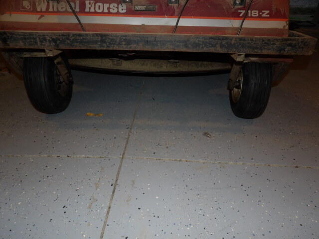

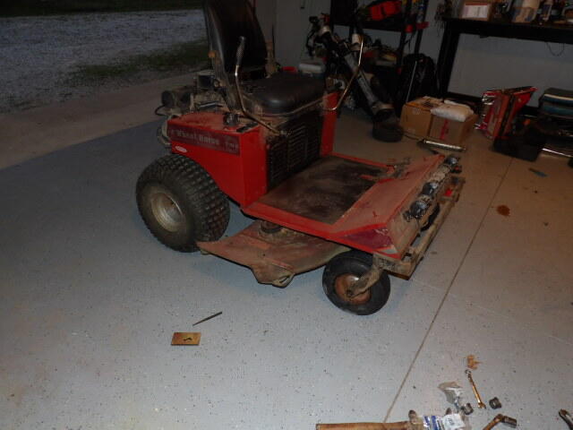

Snoopy11 5,731 #24 Posted September 29, 2022 New front shoes. @ebinmaine... I used a tube on 1 of the front tires, I screwed up the other tube, but was able to get the bead to seat on the one that doesn't have a tube. I had to use the... "light 'em up" method... starter fluid and a lighter... but I got it done... Other than that, I got everything lubricated... straightened out all the wiring... and got everything up to par. New blades, fresh paint on the machine... new voltage gauge and tachometer. New shoe guard installed so I don't scuff up the paint on the floorboard area... Don 3 2 Share this post Link to post Share on other sites
