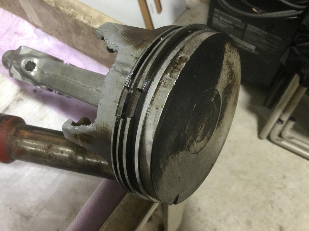

ebinmaine 81,139 #21 Posted October 10, 2022 So just to keep you folks updated. I remove the cylinder head. Never been bored. Piston is marked std. Fair amount of wear in the Piston to wall clearance.. Still made the noise no matter where the Piston was in it's up and down movement. I removed the carburetor and messed around with the governor linkage just for kicks. Left that still and it still makes the noise. I removed the breather cover and I can see the valves quite clearly. They are going up and down and settling and rotating just like they should. I can make the noise whether the valves are moving or not. So I do not believe it to be the valves. I'll dig in further when I can... Share this post Link to post Share on other sites
