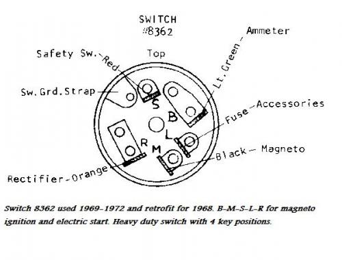

Terminals on 8362 magneto ignition switch may not be identified

Uses 8362 (Threads 9/16"-24) 5-terminal 4-position (L-B-M-S-R) breakerless ignition switch

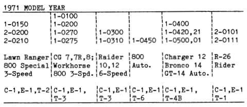

Transmission drive belt 8334 - (B x 84.8" or 5/8" x 84.8") Listed in belt chart

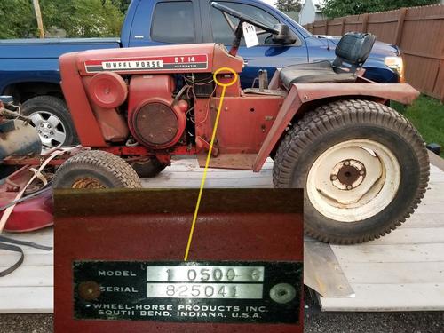

1971 GT-14 model 1-0500
1971 serial numbers that have shown up for the 1-0500
751423
755823
755860
755915 - Model 1-0500-6
755928
790510
790513 - Model 1-0500-6
790559 - Model 1-0500-6
790589
790618
790622 - Model 1-0500-6
790634
790676
790678 - Model 1-0500-6
790743
807214
825041 - Model 1-0500-6
825066
Transmission drive belt 8334 - (B x 84.8" or 5/8" x 84.8") Not listed in belt chart
