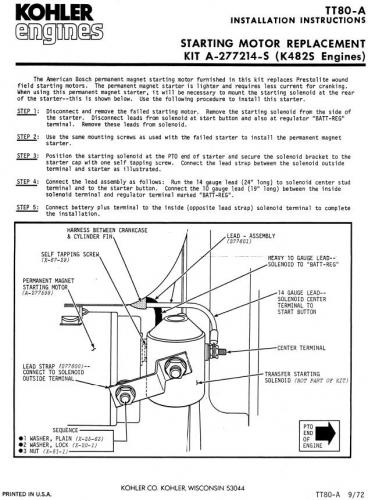

    Engine Kohler Carburetor throttle shaft kit #TT321-A.pdf
    Instructions for throttle shaft kit
    3 pages 3.8MB

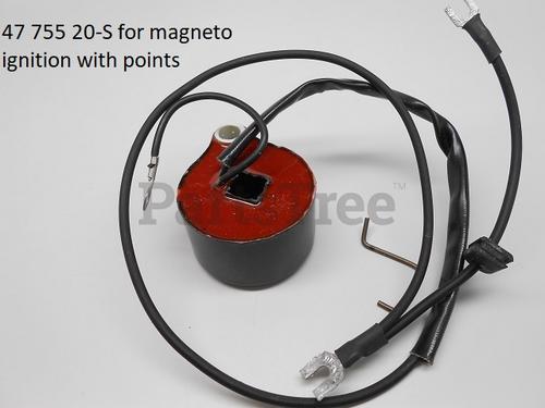

    Engine Kohler Coil Magneto ignition with points and condenser 47 755 20-S.jpg
    Magneto ignition coil used with points and condenser 4775520-S
    Used in the K301S-47147b with Bendix starter and 10 amp stator. Conflicting info in the Kohler parts manuals.
    1968 Charger 12 model 1-7231 - Late production but tractor model number stayed the same
    1968 Raider 12 model 1-6231 - Late production but tractor model number stayed the same
    1968 Electro 12 model 1-7235
    164 downloads

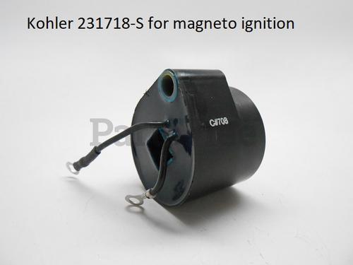

  10. Free
    Fits K181 with magneto ignition
    Kohler 231718-S
    120 downloads

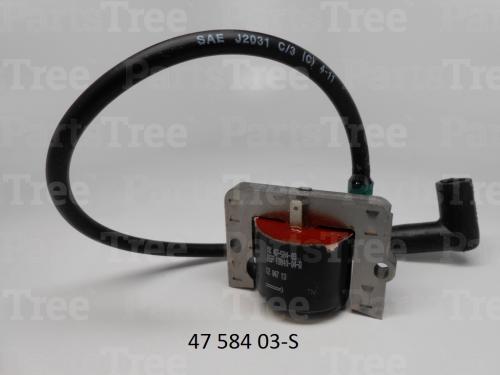

  11. Free
    Taken from #492-4509 Electrical Manual
    KH10321 Kohler magneto ignition coil
    Replaced by 47 584 01 replaced by 47 584 02 replaced by 47 584 03 replaced by 47 584 03-S
    Fits models M10 thru M16
    168 downloads
