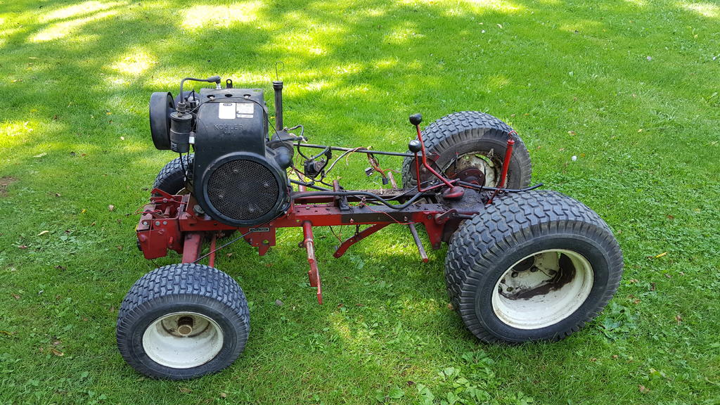

Thanks for all the warm welcomes!:woohoo:  Today I got the engine taken off and have it pretty much down to the frame. The next step is to replace a leaky transmission axle seal. Does anyone have any advice on the easiest way to do this? I do not have too much experience with transmissions.

Remove the set screws from the hub.  If they are socket head set screws, be aware some mechanics stack the screws to act as a lock.
Remove the hub with a puller.  Most use another hub or a custom made puller using all 5 of the hub bolts.  If you use a 2-3 jaw puller, you risk breaking the flange on the cast iron hub.
    Do not beat on it with a hammer.....there is a snap ring on the other end of the axle inside the transmission that you could damage.
Deburr and file smooth any rough spots on the axle so the hub slides back on easily.  This will ensure the new seal will also slide on w/o damage.
Some also wrap the keyway with mylar or shipping tape to help guide the seal lip over the keyway.
The old seal can be removed with a seal removal pick.   Image result for seal removal pick
Please check the axle bearings first.   Most seal failures are caused by a bad axle bearing.   Up to 1/8"  Axial (in and out) movement of the shaft is OK.
A 1/16 radial (up and down) movement indicates the bearing is worn and probably exceeding the seal limits causing it to leak.

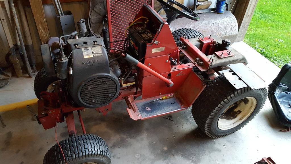

Thanks for the help so far everyone! On to the next step... I drained the oil out of the transmission and the fluid that came out looked orangeish. To me it looks like there is moisture in it. I guess this is an indication for me I should crack the transmission and check the insides. I have never opened a transmission before, so any tips or things to look out for would be greatly apreciated. Pictures will be soon to come!
You don't necessarily need to open up the transmission because of the weird fluid, and you can certainly replace seals without opening it up.  You could flush it with kerosene or diesel, and it might be fine.
On the other hand, I've never opened up either of mine, but I've talked to enough people here on RedSquare to know that it's a pretty straightforward job, and I would feel confident doing it.  Help is always available here.
Have you checked the axle bearings like Ed suggested in post #13 above?  You should.  And are there any other problems with the transmission that you know about?

Okay, well I just got the back tires off tonight, and am still trying to figure out the best way for me to get the hubs off (I dont curently have any types of pullers):think:. There doesnt seem to be any up and down play in the axle, but its kinda hard for me to tell. I think i am just going to open up the transmission anyway. Not that anything is wrong with it, but I just feel that i would kick myself for not seing the inside of it while I have everything this far apart.
  • Like 1
  • Confused 1
You will have to make a puller using all 5 of the bolt holes in the hub,  or you will break the hub.
Go to browse forums, and do a search for "hub pullers".    You will get several hundred ideas.
