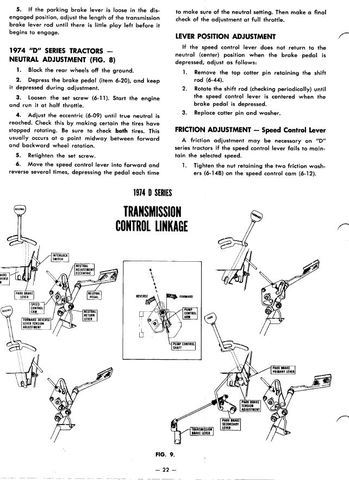

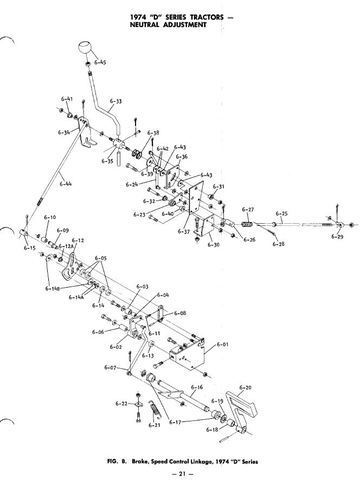

Well adjusted the linkages, didn't help. Then I undid the linkages and pushed the transmission lever all the way back, still goes slowly. Any other suggestions?

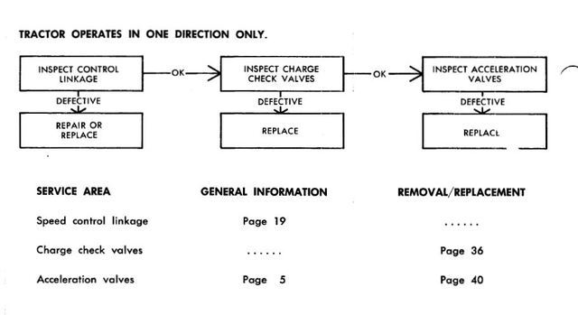

Sounds like you're gonna have to start checking valves and springs. See the trouble shooting guide posted above.
