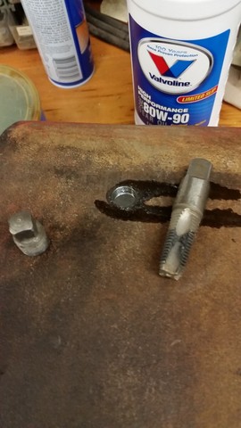

I have a 1960 suburban 400. Can anybody tell me what fluid belongs in the transmission and how much of it? Do i pour in top plug until it comes out of side plug under axle? I have used the search function but got multiple answers and left me more confused. Thanks for the help.

Yup, multiple answers because Wheel Horse changed their minds :rolleyes:
The manual stated up to the oil check hole on the side. Do that and you'll be fine.
Then they said 1 1/2 quarts. Do that and you'll be fine.
They call for SAE 90. I use 80w90. Some go heavier. Do any of that and you'll be fine.
Oh yea, please ignore the blurb in the original owners manual about how to shift while moving. Do that and you won't be fine.

You can not go wrong with what has been stated.  You want something that equals 90Wt.  To fill, I like to take out those 2 9/16ths bolts that hold on the seat and fenders.  Place a funnel in one of those holes and pour in the oil until it starts to seep out the fill plug by the trans axle...replace the plug and if you want a little more oil in there...add another 2 or 3 oz.  I would say no more then that.  :)

Your suburban has the 3 piece transmission...really a completely different animal from the 2 halves transmission in like the 1055.  One big difference is the bronze bearings for the outer axles and the differential carriage in the suburban #5010 trans as opposed to ball bearings and needle bearings in the newer trans.  The 2 piece trans has all needle bearings except for the #1533 ball bearing holding the differential.  The 3 piece uses all open and closed ball bearings.  I think the heavier 90wt oil would be better in the suburban trans...just because of the bronze bearings by themselves.  :)  I think you would want the heavier viscosity.

I pull the shift lever out to dump it in, that way I get to check the setting of the dog point set screw. I have my 5010's done up with a magnetic plug so in my royal analness I can change it. Probaly won't have to considering how they get get used but what the heck it was cheap & easy.

I do believe that the heavier viscosity was used for the last 55 years so I played it safe and filled with the 80-90.
