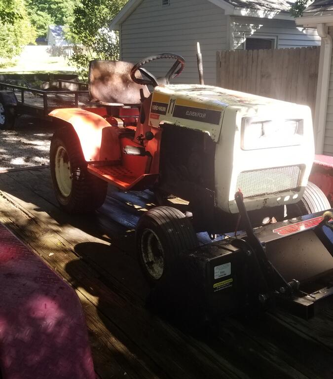

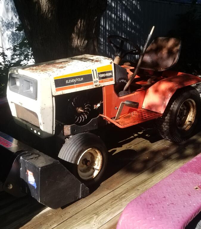

DZG 32 #1 Posted September 10, 2022 (edited) I know this is a wheelhorse forum...and i dont own a wheel horse but... I have a vintage Yardman (1977ish) tractor that has massive sentimental value and would really like to get running. The reason im here is it needs an engine. Its an 11hp, L head horizontal briggs model # 253417. I literally cannot find ANYTHING on these engines. It has low compression and gouges in the cylinder wall. I need at minimum a bare block but would prefer a bolt in ready to go engine. What brings me here is i believe i can use the somewhat more common model 252417 block like whats in my 78 MTD 860. This engine was also used in the wheelhorse C111. I think i could actually even use the 252 engine complete with some slight changes. The 253417 seemed to only be used in Cub cadet 1100's and Bolens G11xl's. This yardman i have ive been told is rare as its a model 14910 with an 11hp and Peerless gear drive. Most my style had 16/18hp twins with hydros. Ive browsed the classifieds on this site, craigslist, ebay, all the usual suspects and came up with zero. Does ANYONE know any places i could look? Im getting desperate here lol. Attached are a couple pics of the tractor. Thanks in advance. Edited September 10, 2022 by DZG 1 1 Share this post Link to post Share on other sites

Heatingman 977 #14 Posted September 10, 2022 Can you take some pictures under the hood? or at least hood open and both sides of the machine. Do you need to drive a mower deck? 1 Share this post Link to post Share on other sites
Heatingman 977 #15 Posted September 10, 2022 From here it looks like almost ANY horizontal shaft motor with the same shaft size and similar HP could be made to work. Or one of a smaller shaft and a bushing to get to the drive pulley, or just a new pulley of same OD that fits the replacement motor 1 1 Share this post Link to post Share on other sites
DZG 32 #16 Posted September 10, 2022 1 hour ago, Snoopy11 said: There are a lot of options for your tractor. Don't get discouraged if you haven't found anything yet. You could go with a newer engine from Carroll Stream company... but that may require some modifications on your end. Anything is possible, welcome to the forum! Don I ran across carrol steam when i was looking. Are the decent motors? I read that the electric start one was out of stock though. 1 hour ago, Heatingman said: Can you take some pictures under the hood? or at least hood open and both sides of the machine. Do you need to drive a mower deck? Yes i can....probably tomorrow. Its in my dads polebarn at the minute i gotta go out there tomorrow anyways...and negatory on the mower deck, i just want to get it running, paint it up, etc. 1 hour ago, Heatingman said: From here it looks like almost ANY horizontal shaft motor with the same shaft size and similar HP could be made to work. Or one of a smaller shaft and a bushing to get to the drive pulley, or just a new pulley of same OD that fits the replacement motor I believe its a 1 inch shaft. If i turn up empty on finding a briggs id like to look into maybe a K301 kohler? I wanna keep it period correct if i can. Just the wireing is the biggest thing that scares me. Share this post Link to post Share on other sites

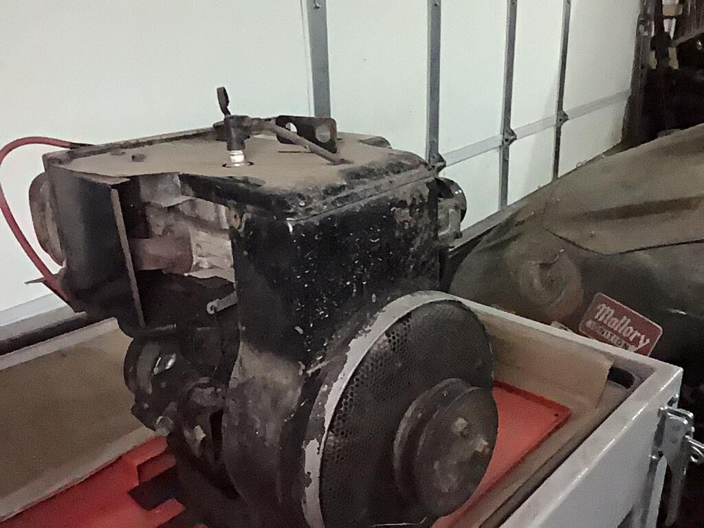

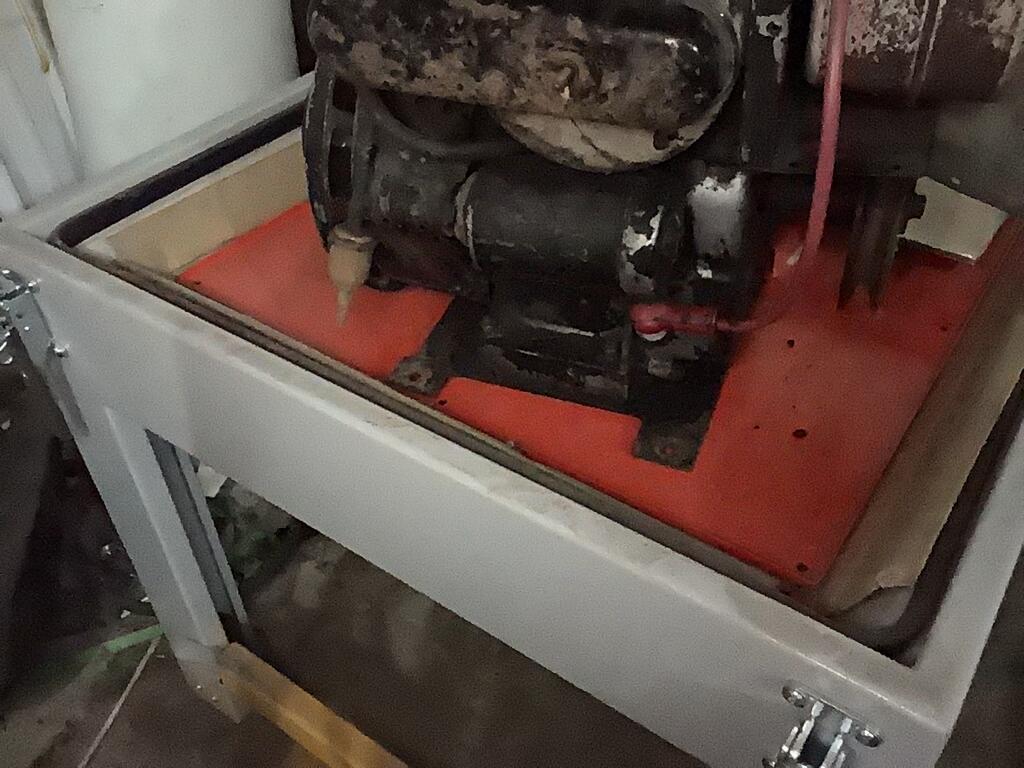

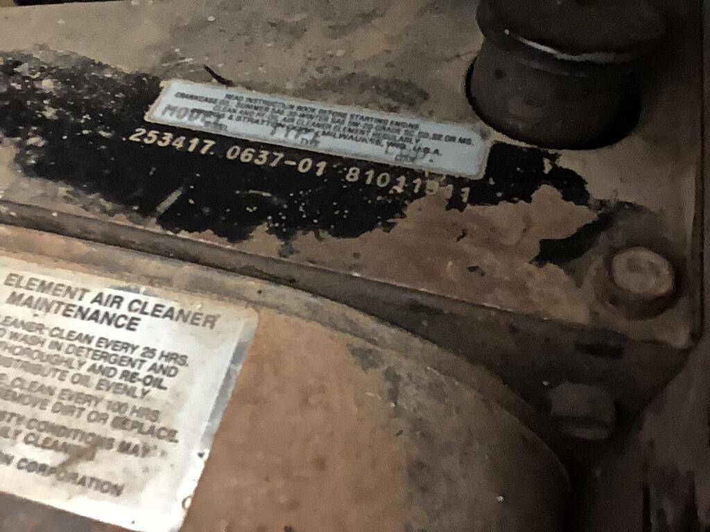

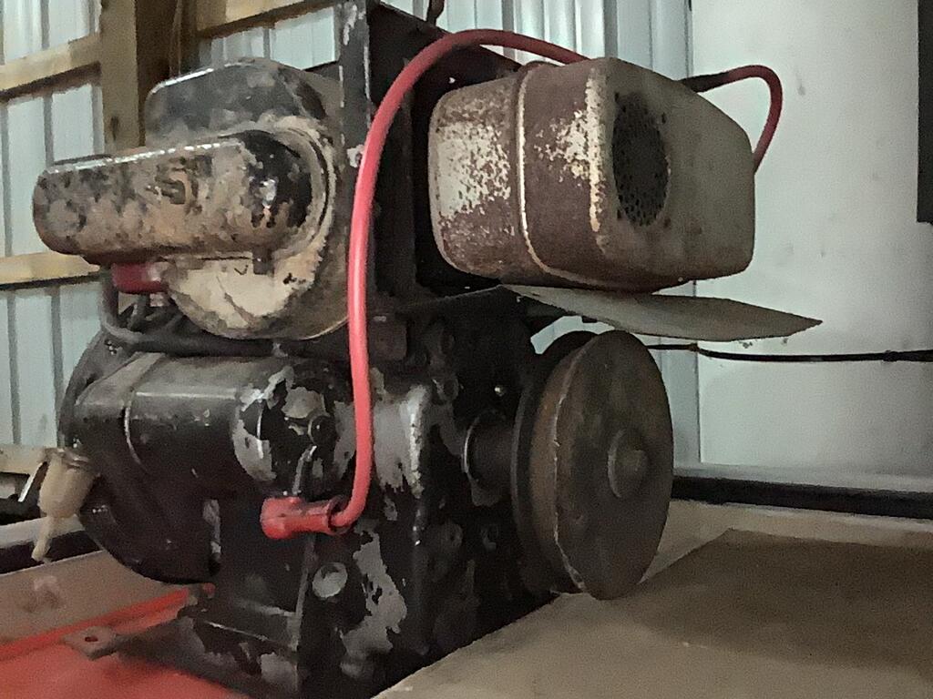

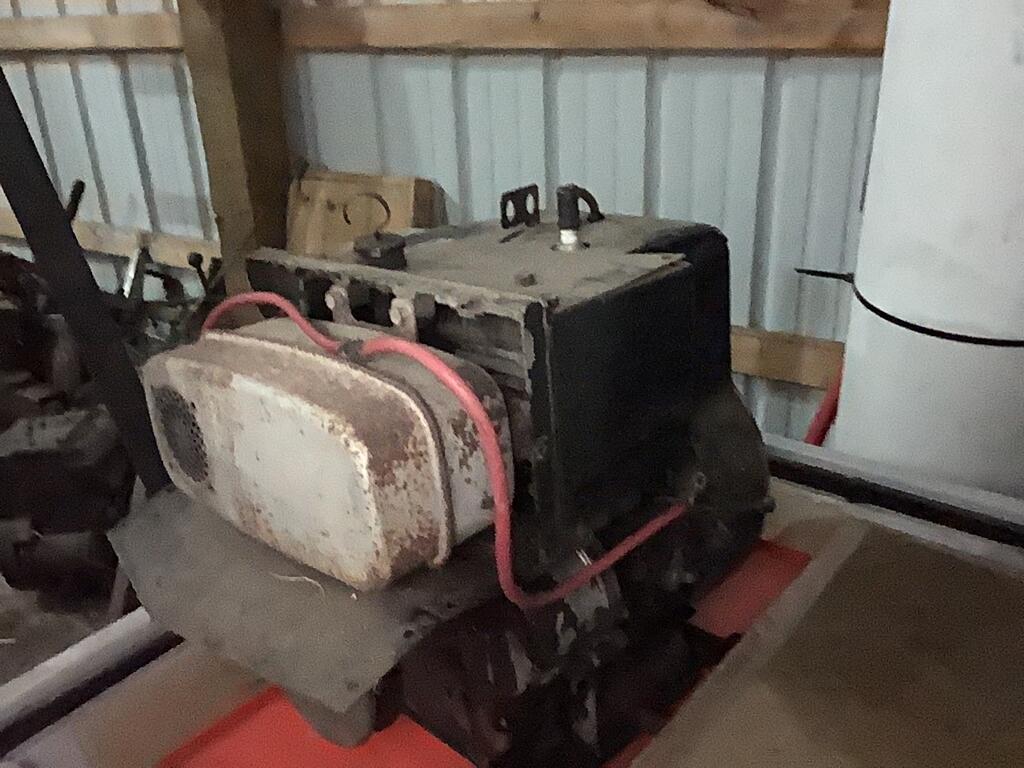

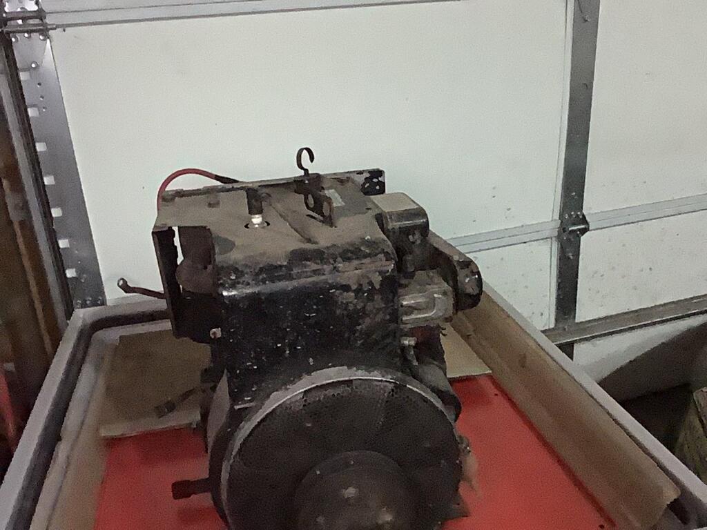

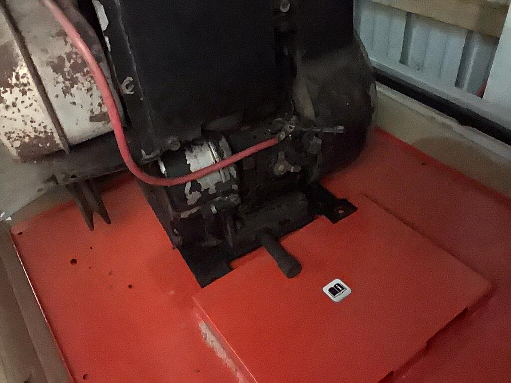

Pullstart 70,757 #24 Posted September 11, 2022 3 hours ago, DZG said: Well that guy flaked out on me...oh well. The search continues. BTW...thanks for welcoming me in and helpin me even if i aint got a WH. As friendly as yall are i might buy one when im ready for yet another project Is this of any use to you? I bought the tractor at a charity type auction in WI. @WHX?? and @Achto saw me drive it around. It was quite a powerful bugger once I threw my battery in it! 3 Share this post Link to post Share on other sites
Heatingman 977 #25 Posted September 11, 2022 4 minutes ago, Pullstart said: Is this of any use to you? I bought the tractor at a charity type auction in WI. @WHX?? and @Achto saw me drive it around. It was quite a powerful bugger once I threw my battery in it! What an odd location for a main power terminal for the starter. Share this post Link to post Share on other sites
