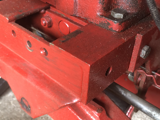

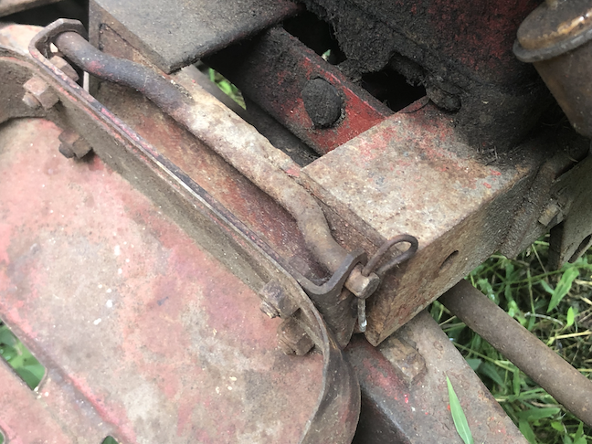

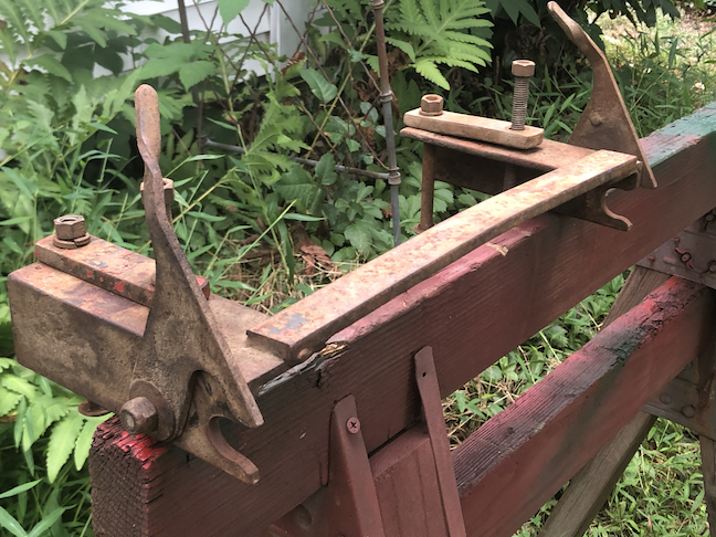

Handy Don 15,901 #19 Posted September 7, 2022 1 hour ago, stevasaurus said: Most of the frames were welded channel, but I seem to remember (I want to say the 854) was a molded or stamped frame ??? This is my 854. Welded angle iron and welded-in front axle plates (the bolts in the rear plate are holding a flanged bearing I added for the lower steering shaft). This is the 1045 from similar angle. Only difference I can see after looking under and around is the welded-on pivot for the hood. @gwest_ca & @JPWH This is the style of bracket I was wondering about. I've never seen it mounted. Do the slots face forward or backward? Or is this a tiller mount and not a plow mount? Share this post Link to post Share on other sites
ri702bill 11,246 #20 Posted September 7, 2022 (edited) 1 hour ago, Handy Don said: Do the slots face forward or backward? Neither !!! That mounts with the slots facing down and the levers towards the rear (just like Dad's 702) The 854 i have came with a plow - simiar mount, faces down, BUT has the HY-3 Hydraulic cylinder mount welded to the left side.... Edited September 7, 2022 by ri702bill Share this post Link to post Share on other sites
Handy Don 15,901 #21 Posted September 7, 2022 20 minutes ago, ri702bill said: Neither !!! That mounts with the slots facing down and the levers towards the rear (just like Dad's 702) The 854 i have came with a plow - simiar mount, faces down, BUT has the HY-3 Hydraulic cylinder mount welded to the left side.... So a royal PITA to mount the plow having to hold it up in the slots while closing a lever. Or I guess one could attach the lift and hoist it up into the slots. 3 Share this post Link to post Share on other sites
ri702bill 11,246 #22 Posted September 7, 2022 (edited) 6 minutes ago, Handy Don said: So a royal PITA to mount the plow having to hold it up in the slots while closing a lever. Or I guess one could attach the lift and hoist it up into the slots. Actually, Don, not that bad. The hardest thing is getting the plow frame squared and centered under the tractor mount - once you lift the frame, you can"rock" it front to back a small amount to engage it, close the levers, and pin them. Then move to the lift mechanism... Edited September 7, 2022 by ri702bill 3 Share this post Link to post Share on other sites

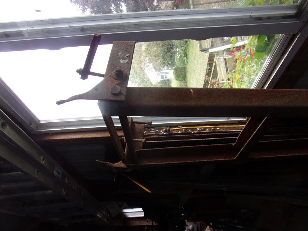

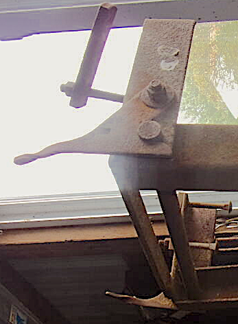

Ed Kennell 44,823 #23 Posted September 7, 2022 Here's a pic of the one I took off my 953. The flat clamp bar fits vertical on the rear and the angle with the pin slot at the bottom mounts vertical to the front of the axle. 2 Share this post Link to post Share on other sites
Ed Kennell 44,823 #24 Posted September 7, 2022 5 hours ago, Handy Don said: I am curious about the "front of the axle" notch brackets. I've been thinking they were for the A-frame plows on short frame tractors. Are below-axle notch brackets also usable and if so, on which plow frames? Please school me! My 953 (48" long frame) has a short plow frame( the true "A" shape) and the axle bracket with the notch in front of the axle. See the above pic. I don't see any reason this arrangement would not work on any long frame tractor except the forward swept 520s. 2 Share this post Link to post Share on other sites
Handy Don 15,901 #25 Posted September 7, 2022 3 minutes ago, Ed Kennell said: Here's a pic of the one I took off my 953. The flat clamp bar fits vertical on the rear and the angle with the pin slot at the bottom mounts vertical to the front of the axle. Showing it with the plow locked in sure makes it clearer! Thanks So I guess it could be used with any plow that fits the tractor frame that had the cross rod mount on the plow frame (i.e. not the early "bolt on" plows)? Share this post Link to post Share on other sites
