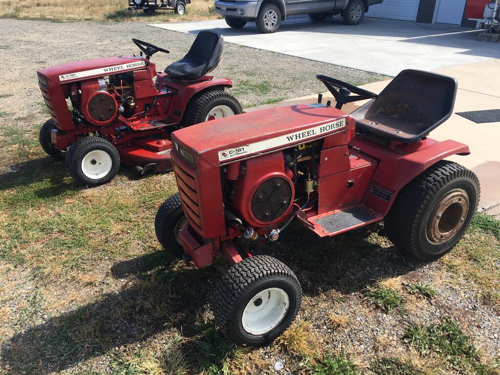

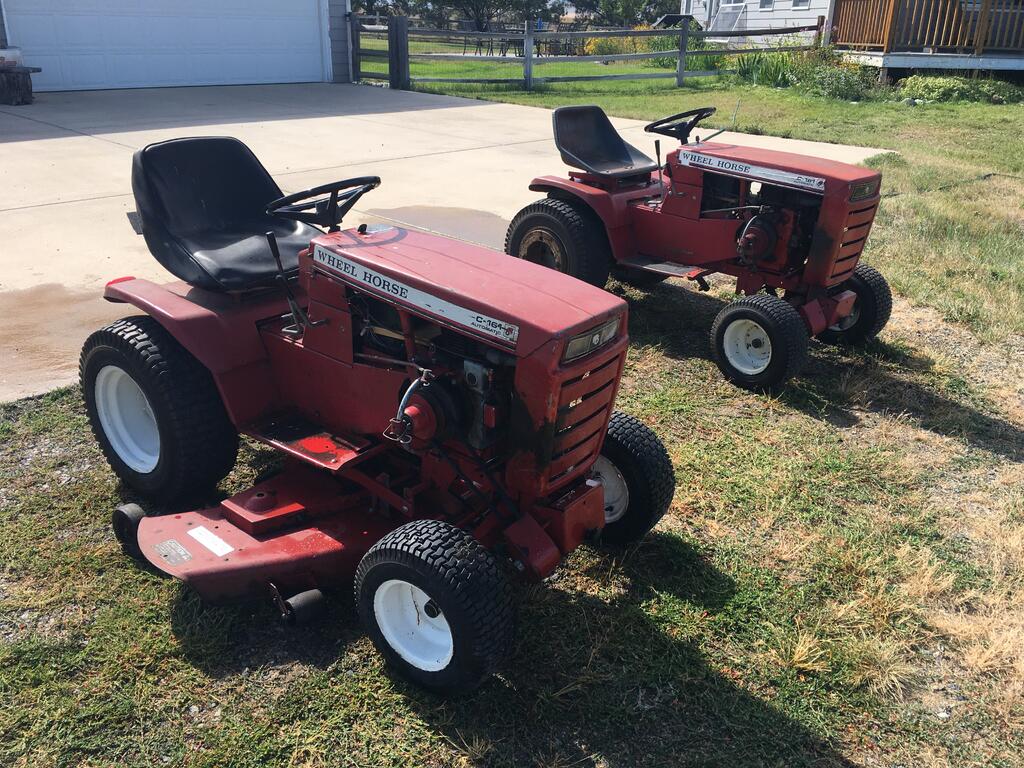

twodogs 55 #1 Posted September 4, 2022 I recently had my 520h pop the valve seat and subsequently hammer the daylights out of the engine block. That thread is here. I did some searching for a replacement engine (e.g., Onan, Briggs, Kohler, etc.), but the best I could come up with was a rebuilt Kohler Command Pro for $1300. Soooooo, I decided to see if I could come up with another WH that didn't require me to fabricate powering with a different engine. I picked up these two C-161 rigs from a gentleman for $960 (no idea if that's way above the market for these things). They came with two 48" mower decks, and two snowblowers. They both fire right up, and seem to operate fine, with a few things I'll address over the winter. One doesn't have any leaks, and it will be the one that I'll task with my snow blade. I've already replaced the oil in it with Rotella SAE 30, and the axle with 10w-30. The other has a small leak on the hydraulic hose going to the lift cylinder. I'll start by replacing the o-ring. I'll probably just go through that engine first....just because. That leads me to a question. There is a sticker on it that it's a short block and to use that information before ordering parts. It shows a Spec and Serial Number, but I haven't been able to cross reference that information to anything I could use for ordering. Please take a look at the short block sticker and let me know if it means anything to you. Thanks! So far I'm liking these over my 520h. They seem to have plenty of power, and I like the simplicity of the engines and the electronics. I'll reserve final judgment for a bit, however.... 5 7 Share this post Link to post Share on other sites

Ed Kennell 47,268 #4 Posted September 4, 2022 (edited) 1 hour ago, twodogs said: $960 (no idea if that's way above the market for these things) $960 is close to the price of two 48" decks and two blowers in my area. You got two free tractors with the best Kohlers made. I am not a fan of the rubber engine mounts. Check the condition of the rubbers...they can be replaced with solid mounts. Look for twisting of the engine when engaging the PTO. This will happen with worn rubber mounts. Edited September 4, 2022 by Ed Kennell 2 Share this post Link to post Share on other sites

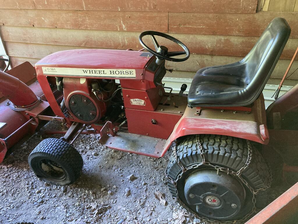

Blasterdad 3,168 #13 Posted September 4, 2022 Great score! A pic of my C-161 snow beast awaiting her fall maintainance & new front tire, ( and a bath ). I have 2 C-160's in the shop now being worked on ahead of her. The C-161 is one of my favorites, you're going to love them! 1 Share this post Link to post Share on other sites

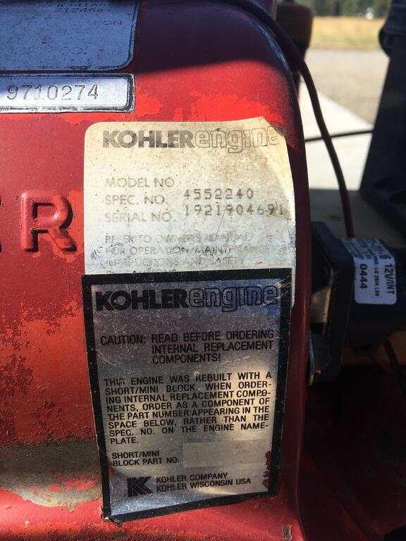

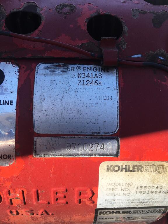

RJ Hamner 1,029 #14 Posted September 4, 2022 4 hours ago, twodogs said: It shows a Spec and Serial Number, but I haven't been able to cross reference that information to anything I could use for ordering. Please take a look at the short block sticker and let me know if it means anything to you. Thanks! Probably doesn't help much but the only reference to spec #4552240 is that it is a factory short block. Which is listed as NLA Share this post Link to post Share on other sites
Blasterdad 3,168 #15 Posted September 5, 2022 Many parts are the same, this will tell you what you need to know. Great thread, it's pinned at the top of the engines catagory... Share this post Link to post Share on other sites
twodogs 55 #16 Posted September 5, 2022 5 hours ago, Blasterdad said: Great score! A pic of my C-161 snow beast awaiting her fall maintainance & new front tire, ( and a bath ). I have 2 C-160's in the shop now being worked on ahead of her. The C-161 is one of my favorites, you're going to love them! Nice looking rig! I do like the lines on the C-series. I was surprised at the amount of torque they put out. Your pic reminded me that I need to source some good tire chains. Another punch list item. 1 Share this post Link to post Share on other sites
twodogs 55 #17 Posted September 5, 2022 2 hours ago, Blasterdad said: Many parts are the same, this will tell you what you need to know. Great thread, it's pinned at the top of the engines catagory... Thanks for that link! I haven't done a close inspection of the short block, but I'll do so tomorrow with your information at hand. This thread alone made me realize that I needed to become a supporter of this site. There's just too much good information in one place, and I needed pony up...so to speak. 3 Share this post Link to post Share on other sites

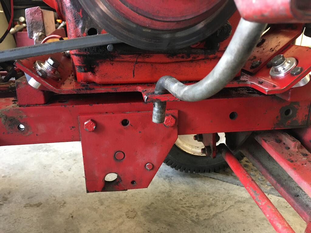

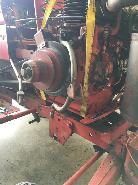

twodogs 55 #23 Posted September 8, 2022 After looking at the deteriorated rubber mounts, I decided to tackle the solid mount replacements today. I used my cherry picker to lift the engine a few inches so that I wouldn't have to wrestle the engine as much. It wasn't too bad, but I still had to fight one of the bolts a bit. It was well worth the effort because now the engine doesn't shift when I engage the PTO. I finished the mounts, installed a 48" mower deck, and was pleased to see everything engage and align like it should. The condition of those rubber mounts were really nagging at me. 3 5 Share this post Link to post Share on other sites
