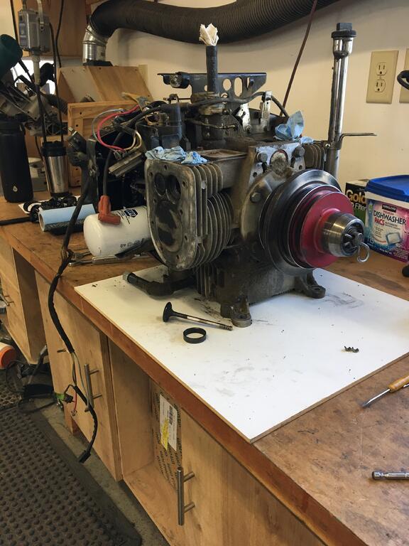

twodogs 55 #1 Posted July 16, 2022 My 520h has been running a bit rough the past couple of weeks, so I decided to check the compression on both cylinders. The front is showing about 85 psi, whereas the rear has a paltry 30 psi. Of course, I'm assuming it's blown valve seat, but my fingers are crossed that it's something else. Just 60 hours ago (per the tractor's hour meter), I performed the following maintenance (and it was running like a top after it): - new intake and exhaust manifold gaskets - new head gaskets - new valve box gaskets - cleaned the crankcase breather - adjusted intake and exhaust valves/tappets - decarboned the heads - new plugs Aside from tearing the engine apart to determine the problem, does anything come to mind that I should look for as I head down this rabbit hole? (I'm a novice at this stuff but have been pretty successful so far on the DIY aspect). Thanks for any insight (and condolences?) you can provide! 1 Share this post Link to post Share on other sites

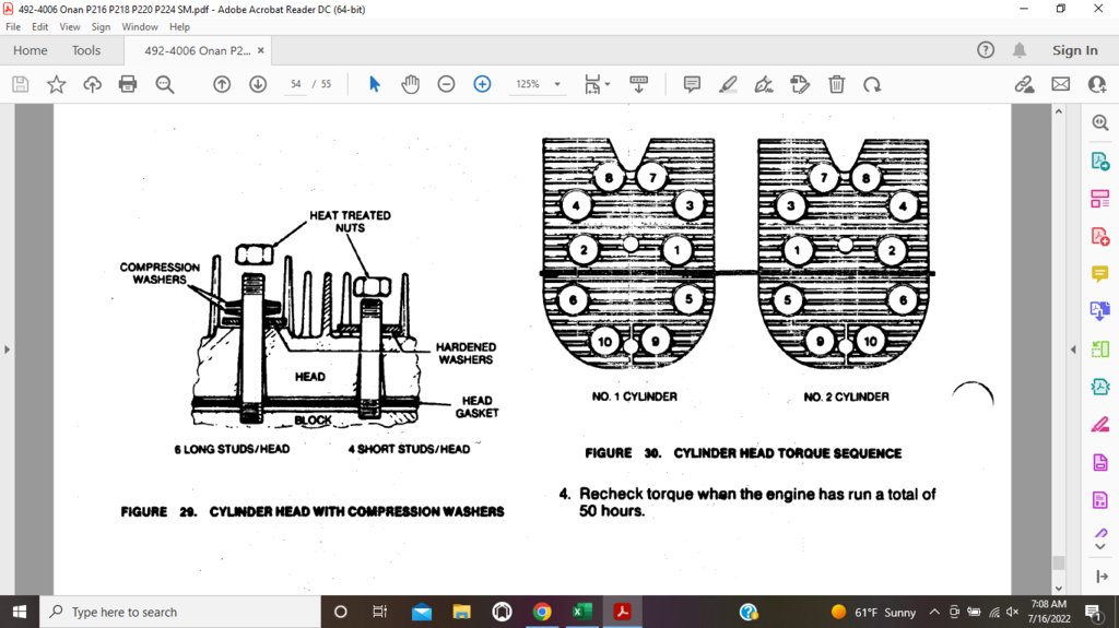

953 nut 67,376 #2 Posted July 16, 2022 (edited) After the service that you performed on the engine did you bring it up to operating temperature, let it cool off and then retorque the head bolts? That is an old school method that seems to not be mentioned in service manuals but is important. I just looked at the Onan Service Manual and they call for a retorque after 50 hours. I do it after a five minute warm up. Edited July 16, 2022 by 953 nut 4 Share this post Link to post Share on other sites
lynnmor 8,896 #3 Posted July 16, 2022 3 hours ago, 953 nut said: After the service that you performed on the engine did you bring it up to operating temperature, let it cool off and then retorque the head bolts? That is an old school method that seems to not be mentioned in service manuals but is important. I just looked at the Onan Service Manual and they call for a retorque after 50 hours. I do it after a five minute warm up. While it may be a good idea to re-torque the head bolts after the engine has been run, the manual does not specify that for the P220 engines. The P224 engine had studs, nuts and compression washers and they are to be re-torqued after 50 hours. I wonder if @twodogs checked for loose valve seats and burned valves while the heads were off. Running an engine with a fouled carburetor causes a lean mixture and it can lead to burned valves or worse. Share this post Link to post Share on other sites

twodogs 55 #5 Posted July 16, 2022 As you likely surmised, it was the intake valve seat. I decided to just remove the engine completely so I could work on it at bench level (and in the event it would have to go to a machine shop). I was also pretty certain it was the valve seat, so I figured I would save some labor costs by doing that work myself. Now that I know at least part of the problem, I'm hoping you all could give me a little guidance on my options. Do folks typically take the engines to a machine shop to see about getting it rebuilt? I'd like to keep it going if at all possible. I really rely on it with the 60" mower, and the plow to clear snow in the winter. I'd love to hear what you might consider for a rebuild/repair punch list. Thanks folks! 1 1 Share this post Link to post Share on other sites

twodogs 55 #12 Posted July 19, 2022 I went to four shops yesterday with the engine, and that was an exercise in futility. Three of them either had no interest in doing the work, or stated that the engine wouldn't fit in their machine. And the remaining shop said that I should strip it down to a bare block and they would think about it (again, about zero enthusiasm). I looked at the block again where the valve seat resides, and it's clear that the block was hammered pretty hard by that loose seat. I think that portion of the block would have to be built back up and then routed out for a new seat. If I had to guess, that seat hammered it 40 thousandths deeper into the block. Still can't believe I did it! I just made phone inquiries with shops in other towns that are hours away from me, and every one of them declined the work even before seeing it. At this juncture, I'm wrestling with re-powering with a different engine, or just selling the 60" mower deck, snow plow, and tiller. I know I have a rear axle issue that I'll need to address if I keep it. When I have the rear end lifted up, I can move the wheel back and forth, as if there are wheel bearings going out. Decisions, decisions... Share this post Link to post Share on other sites
