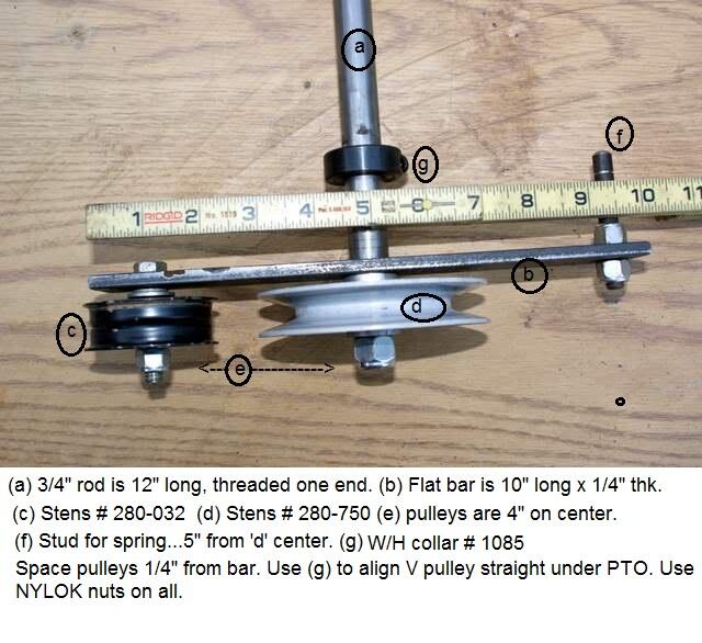

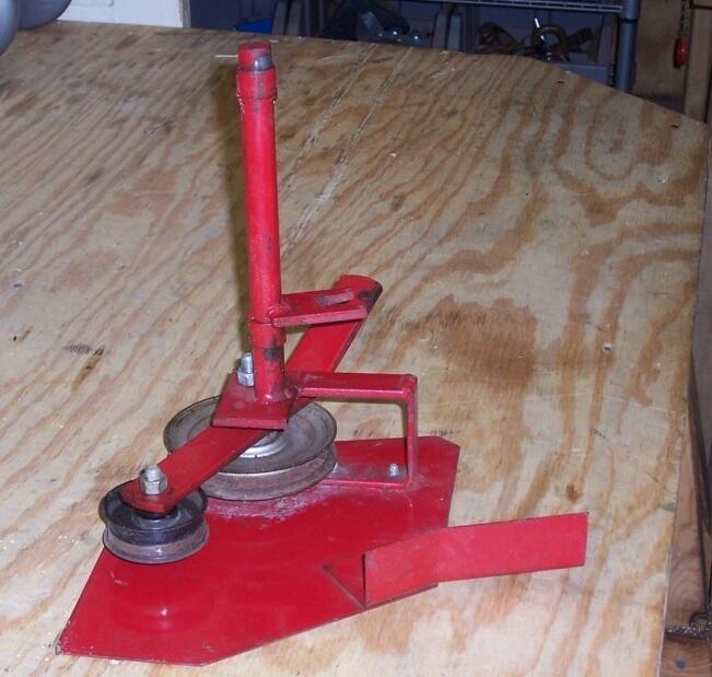

Goldnboy 1,147 #2 Posted August 31, 2022 I recall correctly 141" is for twin cylinder engines and 139" is for the single cylinder engine. Shown is one of two mid idler styles which is what I use with a single cylinder engine Share this post Link to post Share on other sites

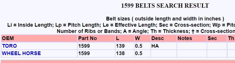

daveoman1966 3,884 #4 Posted August 31, 2022 As with mower decks, the V-BELT for the tiller is in the TILLER schematics. Your tiller model 7-1252 is an older model and the OEM drive belt for it is #1599. This belt is 139"L x 0.5"W. 1 Share this post Link to post Share on other sites

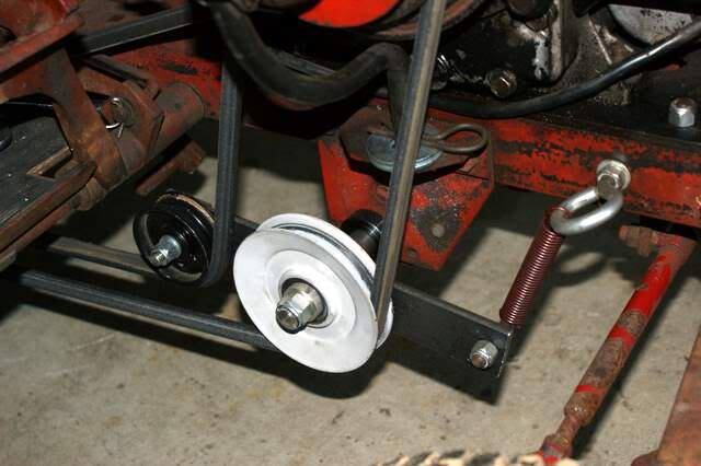

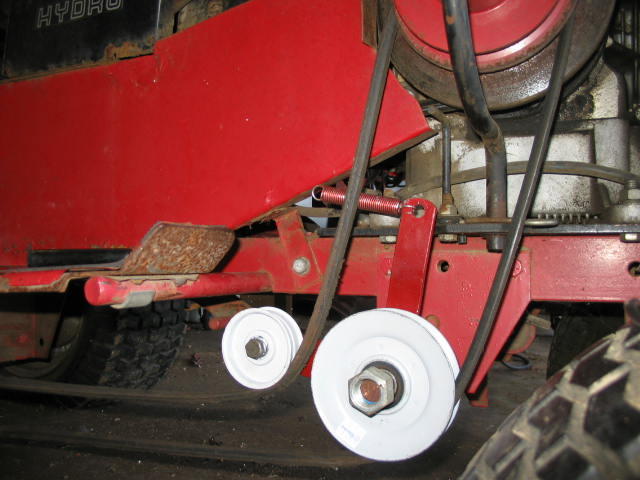

gwest_ca-(File Mod) 12,450 #6 Posted September 2, 2022 This one is used with the manual or electic pto clutch. The belt goes straight up from the large idler pulley to the front of the pto pulley and then down to the flat idler and back to the tiller. Share this post Link to post Share on other sites

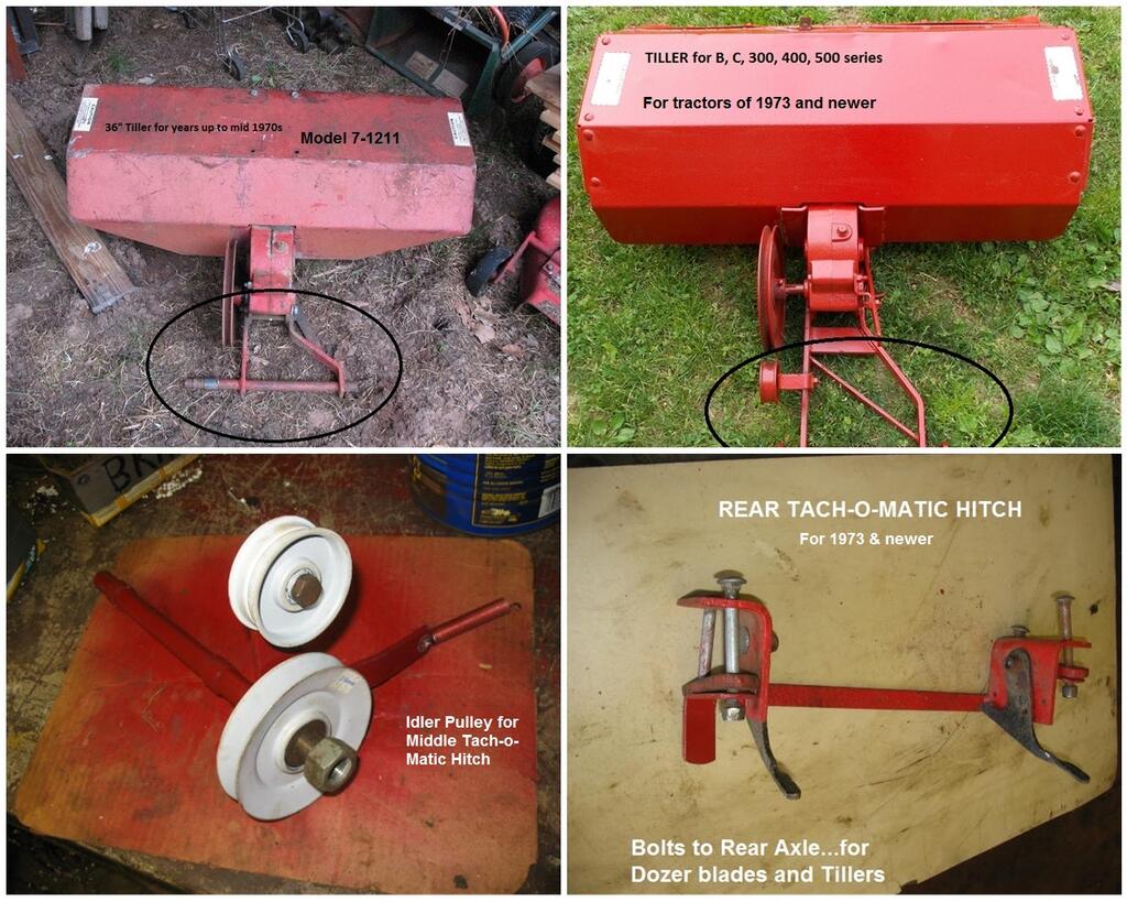

daveoman1966 3,884 #7 Posted September 2, 2022 Mid-tach-O-Matich hitch with Teller IDLER PULLEY ASSY installed. There are 3 or 4 variants to the Idler Pulley Assy, but they all attach in the same way. Share this post Link to post Share on other sites
peter lena 10,013 #8 Posted September 2, 2022 @daveoman1966 nice picture / description lay out , only thing I would change / upgrade is the pulley bearings , you cannot believe how easily those pulleys work / spin up with a bearing / lubricant change . once I made the change over , did that on , each / every belt driven pulley I have , also detailed in the pto lever rod function , smooth / easy / quiet pete 1 Share this post Link to post Share on other sites
