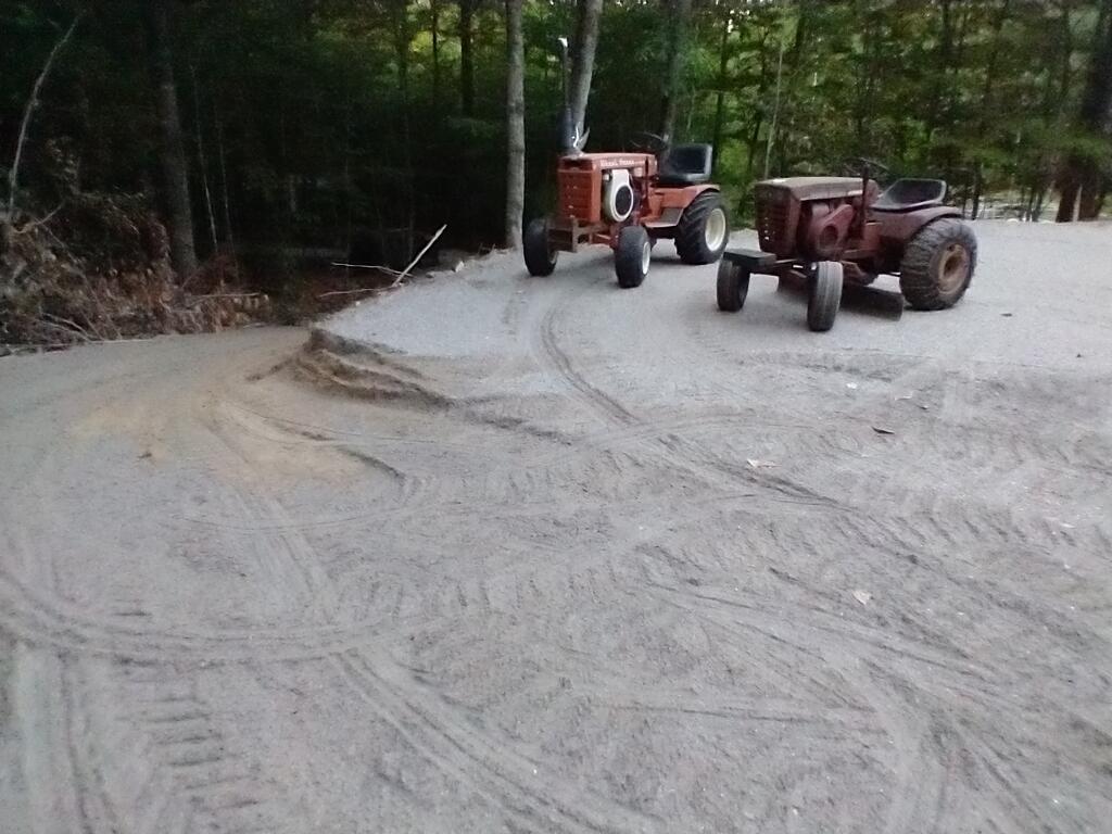

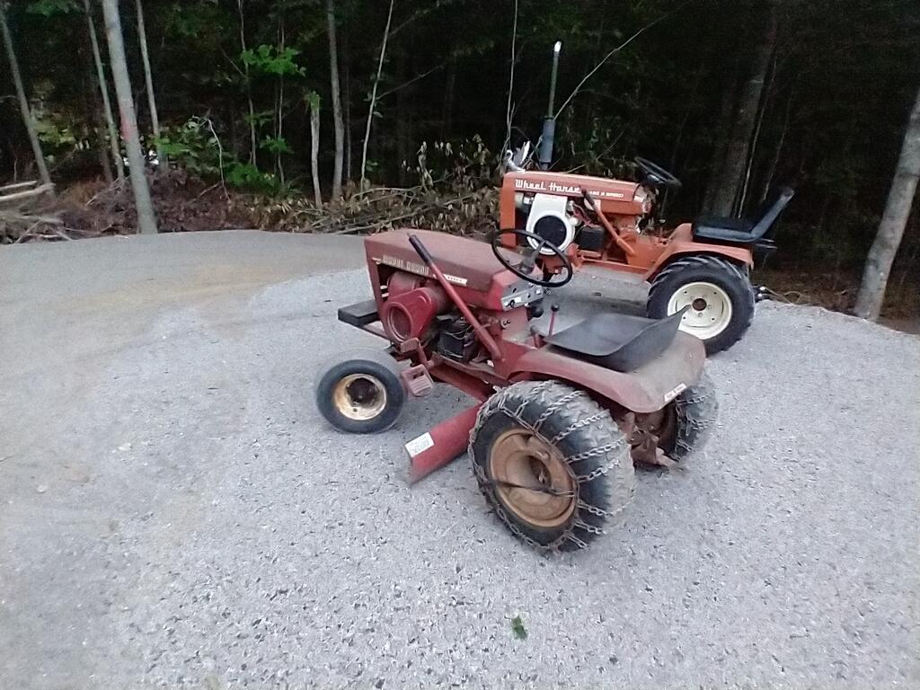

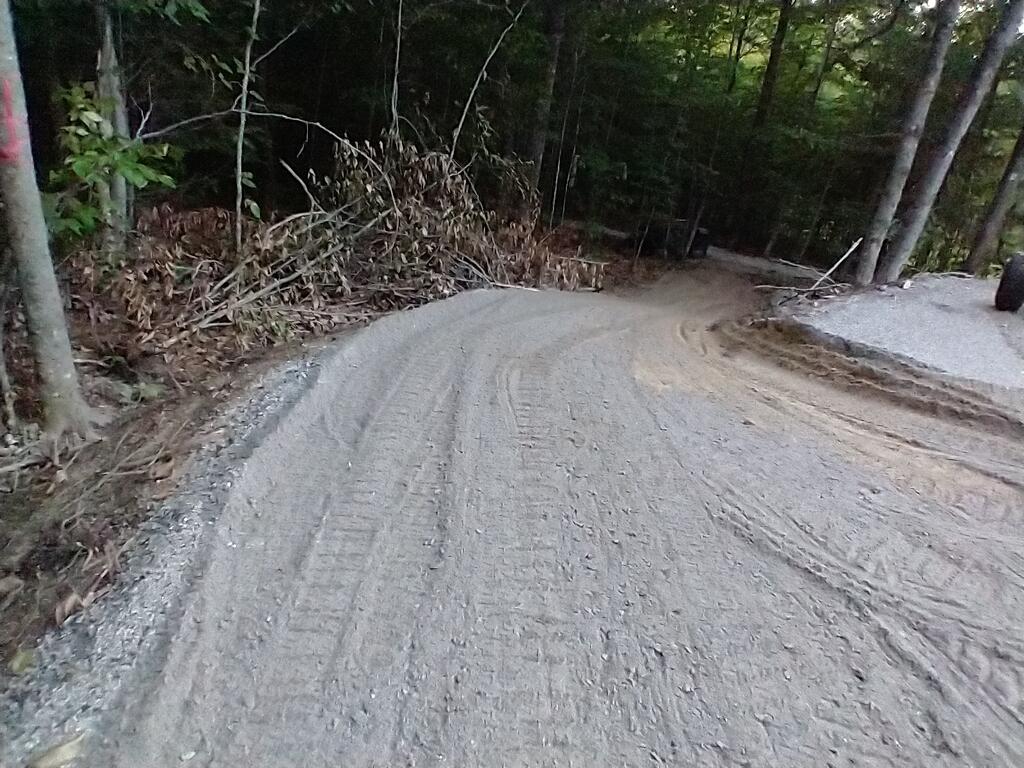

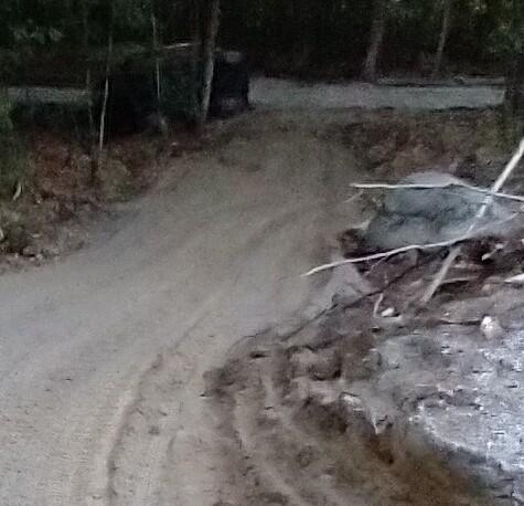

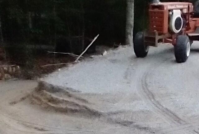

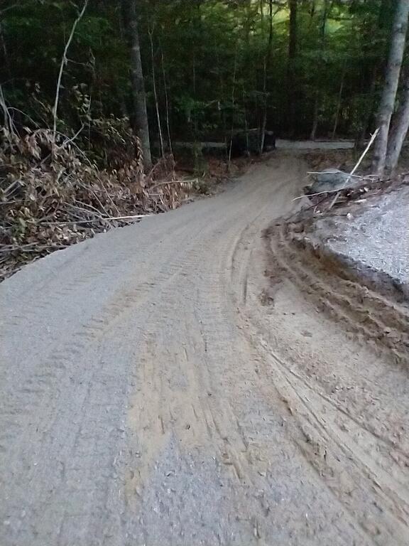

ebinmaine 78,101 #1 Posted August 30, 2022 The local female BBT person spent some time repositioning the ramp from the left rear of our new building site area down towards the forest. It was tilted a fair amount and too steep. You can see in the pics just how much she cut off the right side. Using my 18" front tire as a size reference she certainly sliced off at least that 18". Maybe 20. She moved that material slowly and gradually off towards the other side which also took the tilt out of the ramp. And also spread the scraped material downward adding to the bottom area thereby leveling out the grade. The end was at the big boulder on the right. Here you can see it's a good strong 18 to 22 feet past the boulder now. 7 10 Share this post Link to post Share on other sites

ebinmaine 78,101 #5 Posted August 30, 2022 6 hours ago, Blasterdad said: What kind of "material" is it? The tan colored underlayer is 4" max gravel. We found very few larger stones. Should compact nicely. The gray layer is what some call stone dust. Others I think ¾ Max. It's crushed stone but with the powder left in, not rinsed off. It will compact down with usage, time, and rain to near cement. 2 Share this post Link to post Share on other sites

Handy Don 16,203 #9 Posted August 30, 2022 8 hours ago, ebinmaine said: The tan colored underlayer is 4" max gravel. We found very few larger stones. Should compact nicely. The gray layer is what some call stone dust. Others I think ¾ Max. It's crushed stone but with the powder left in, not rinsed off. It will compact down with usage, time, and rain to near cement. And worth pointing out, this blade is running on an 867, right? 2 Share this post Link to post Share on other sites
ebinmaine 78,101 #10 Posted August 30, 2022 58 minutes ago, Handy Don said: And worth pointing out, this blade is running on an 867, right? Yes sir that's correct. Lightweight operator. 40 lb of Steel out in front and roughly 110 lb of wheel weights. Chains on turf tires. Standard Wheel Horse Limited Slip Differential.. 3 1 Share this post Link to post Share on other sites
