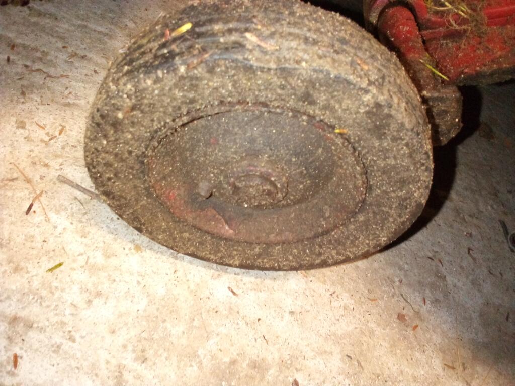

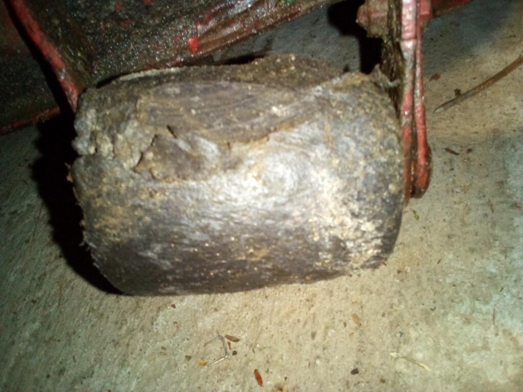

Forrest Carver 52 #1 Posted August 23, 2022 Hi there, can anyone recommend good quality aftermarket deck wheels and roller wheels? Mine are kind of tired. I saw some on Amazon but they looked chintzy Share this post Link to post Share on other sites

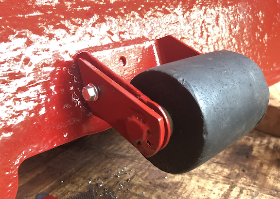

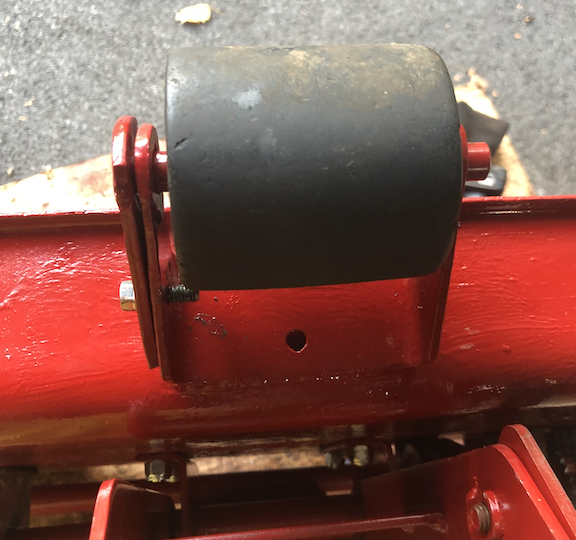

Handy Don 16,351 #9 Posted August 27, 2022 (edited) On 8/25/2022 at 1:37 PM, Lee1977 said: Cleat and I make ours Same idea! The RM-325 and RM-365 through RM-327 and RM-367 series mower decks from '65 through '67 have their anti-scalp rollers very exposed to the grass cuttings. To prevent the shaft from spinning in (and wearing out) the bracket, they rely on the cotter pin through the shaft to engage a pin welded to the bracket. On mine, the cotters, pins, brackets and shafts were all in dire condition. Taking a cue from WH's pin technique for later front axles and for anti-scalp shafts on the larger decks, I ground off the remains of the pin, welded heavy washers to the brackets to overcome the wallowing, and made new ½" shafts with flags that I secured from spinning via drilled and tapped holes in brackets using a ¼" locking flange bolt. By the way, I've gotten new direct replacement gage wheels with solid bushings and grease zerks from http://a-ztractor.com/. Worth it to me considering the load that these wheels carry, especially on the larger decks over bumpy lawns. Edited August 27, 2022 by Handy Don 1 Share this post Link to post Share on other sites
