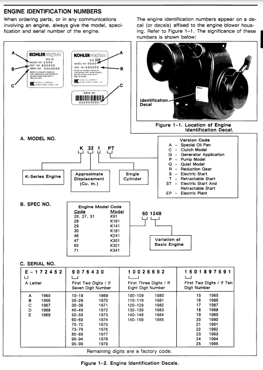

Jeff-C175 7,211 #3 Posted August 21, 2022 (edited) 23 minutes ago, ineedanother said: No internal differences Yep, I saw that chart in the service manual. Doesn't tell ya a whole lot though. For example, the "Variation of basic engine" breakdown. So you think the crank is the same and my PTO will fit right on? I know many gensets use a tapered crank end. I know for the external differences I'll be able to 'mix and match' those parts. For example, the oil fill tube, etc... But I did read that the engines with the 2 QT oil pan which this one has also have a longer dipper on the conn rod that needs to be modified. That's easy enough. The "AS" has a 'special oil pan' according to the chart. I believe because the C-125 is a shaker plate. I wonder if it's got the dreaded 'balance gears' ? I suppose I'm going to need to separate it (if I can figure out how!) and do a dissection. Edited August 21, 2022 by Jeff-C175 1 Share this post Link to post Share on other sites

Jeff-C175 7,211 #13 Posted August 22, 2022 (edited) OK then... after carefully going through the IPL that Garry posted and comparing the two engines... This "EP" engine does NOT have the balance gears. It has a "Stellite" exhaust valve and a 'rotator'. I believe this is a PLUS. I can't determine the differences on the carb... very confusing to me... but it's clear from looking at them both that the only differences may be just the linkages. The governor linkage is clearly different, and the genny of course does not have the remote throttle. The crankshaft is different. The IPL does not say what the difference is, but I have to presume that the genny engine has a tapered shaft. As stated by others, I can get an adapter, or use the crank from the "AS" engine. {edit: crankshaft details in later post, the EP engine DOES have a larger and tapered shaft end.} The connecting rod is the SAME in both engines, the dipper is the same. The fuel pump says it is different, but they sure look the same to me. No matter, it will end up with an electric fuel pump anyway. I didn't see any difference in the block casting part numbers so for the time being I'm going to assume that the bolt pattern may be the same. WRONG! The block is in fact different! Need to research this more, but it does not appear that the "AS" oil pan will fit the "EP" block. This is the EP pan: This is the AS pan: I may have to use the starter from the "AS" engine. {edit: YES. the "AS" block uses a high mounted starter while the "EP" block is flipped over and mounted low. I can't determine yet if the MOTOR is the same and I can simply change brackets. But it's a moot point if I can't use the old oil pan.} Everything else that I can determine is the same, so it appears I will easily be able to mix and match the parts between the two engines to get one good one with no balance gears. Maybe I'll get some shop time today to try and figure out how to separate the gen head from the engine. There are no visible bolts. I'm wondering now if there are any bolts. Is it possible that the bolts holding the engine and the gen head to the frame are what's actually keeping the two together? {no point in doing this if the oil pan won't interchange, is there?} @richmondred01 Edited August 23, 2022 by Jeff-C175 1 Share this post Link to post Share on other sites
