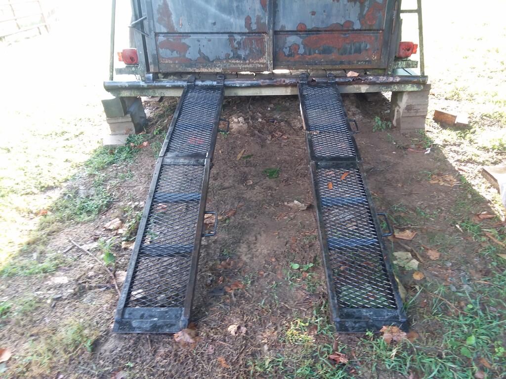

TJ5208 1,841 #12 Posted August 22, 2022 I have these for my shop which is a horse trailer they work perfect. They are heavy but they won't break. 2 Share this post Link to post Share on other sites

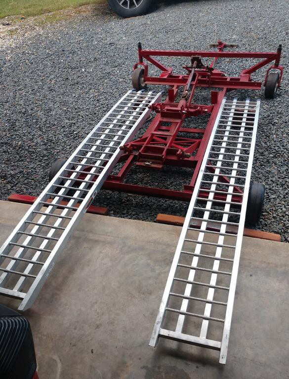

kpinnc 18,859 #15 Posted August 22, 2022 (edited) I'm not a fan of folding ramps, but that seems to be the most common on the market these days. I have an aluminum set that don't fold, and they are rated for 750lbs. They are very light, and work well. The pic below isn't on a truck bed of course, but they are useful in alot of places. I drove 200 miles one way to get them several years ago. Now that I know how well they work, I'd drive 1000 miles for a set of these! And I agree wholeheartedly with previous comments: whatever ramp you use, do NOT drive your tractor onto the bed. Walk beside it. Very few of us can bench press 500lbs. A tractor can flip off the ramps faster than you can get off the tractor. Edited August 22, 2022 by kpinnc 4 Share this post Link to post Share on other sites
