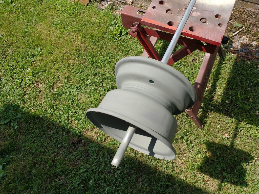

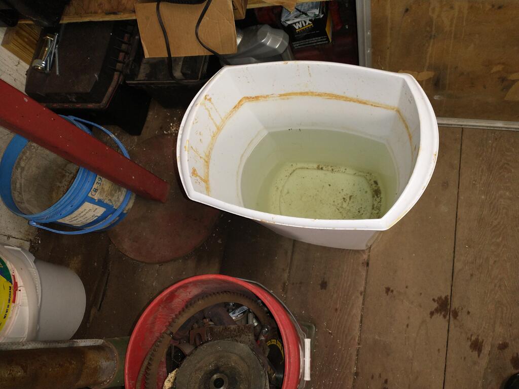

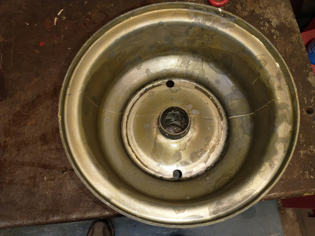

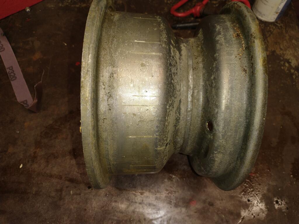

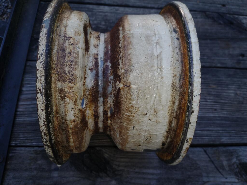

squonk 47,990 #1 Posted August 20, 2022 (edited) For those of you who might not want to do an e tank, don't have a good enough charger, or a good place to have a tank cooking, you can de-rust and strip paint with an office trash can and white vinegar. Plus your garage will smell like an Eye-Talin restaurant! I have this wheel I want to strip and paint. Not too bad a shape but bad enough I want to clean it up. This picture is how it looked after it soaked for 4 days. 4 gallons of white vinegar in my electrolysis /office circular file can. Put the wheel in Tuesday and pulled it out today. 5 minutes with the pressure washer Edited August 20, 2022 by squonk 5 9 Share this post Link to post Share on other sites

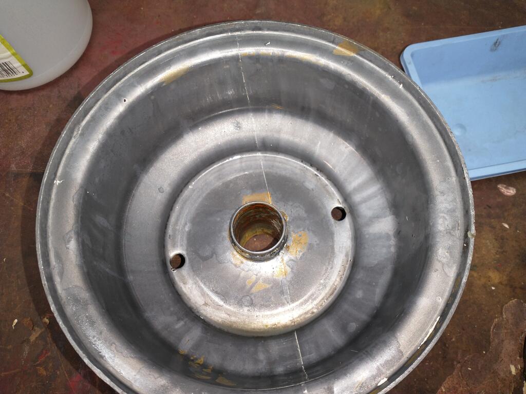

squonk 47,990 #5 Posted August 20, 2022 Coated it with etching solution. When it's dry. It will be time for prime. 7 Share this post Link to post Share on other sites

wallfish 20,553 #8 Posted August 20, 2022 More expensive (but not by much) but cider vinegar seems to work even better. Don't forget to rinse anything off well then rinse with a mild solution of water and baking soda to neutralize the acid and then dry immediately or it will continue to rust. This method works great for the inside of metal gas tanks. 7 Share this post Link to post Share on other sites

squonk 47,990 #10 Posted August 20, 2022 Primed for action! First coat of Almond Joy! 8 Share this post Link to post Share on other sites
squonk 47,990 #11 Posted August 20, 2022 1 hour ago, ACman said: …..plus when you’re done you can add epson salt some dish soap and have a good organic weed killer to use around the house . I have a nice big funnel with a screen. going to put it back in the jugs and save it for another time. 3 Share this post Link to post Share on other sites

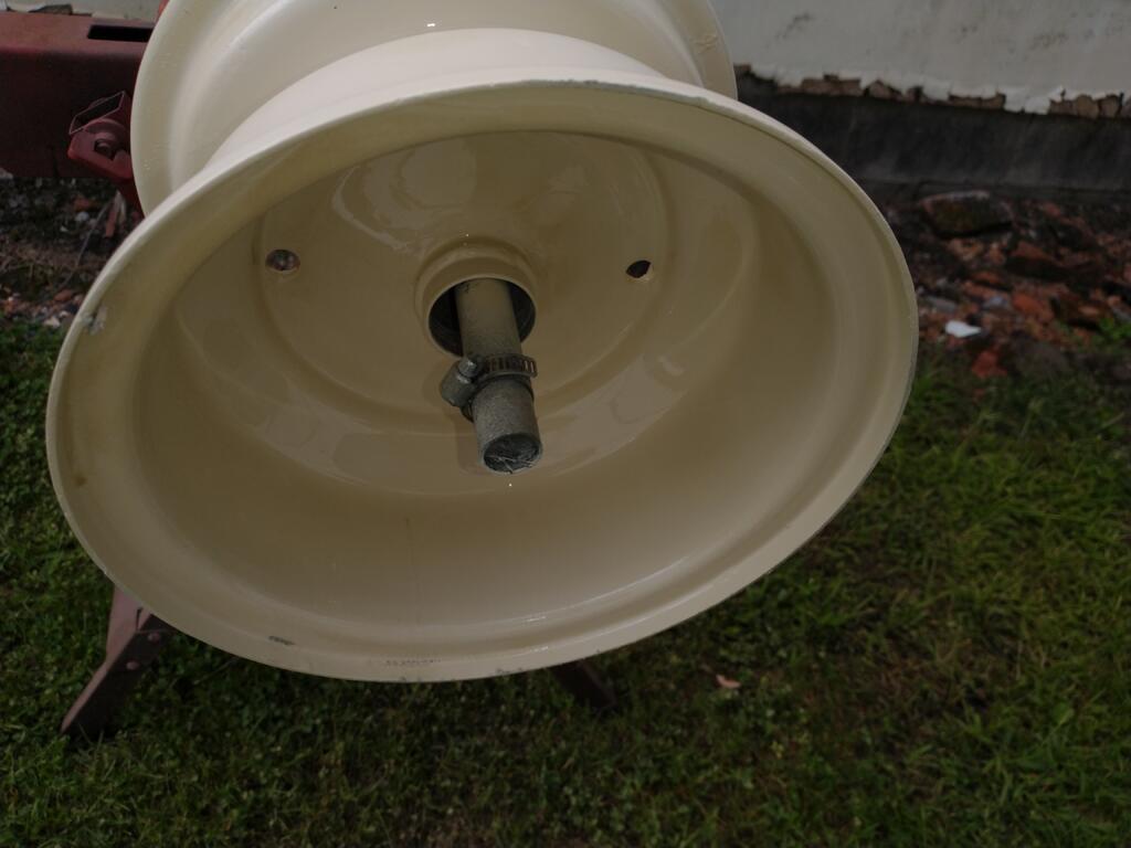

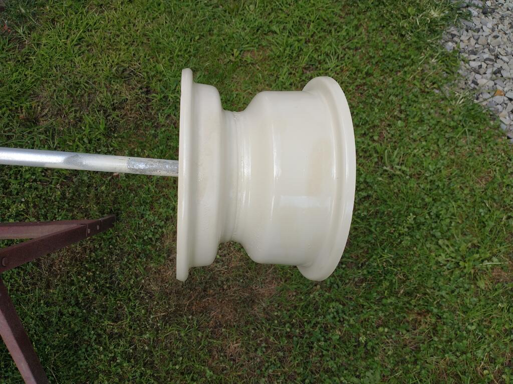

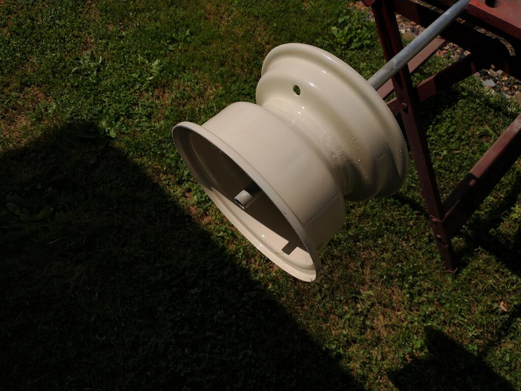

squonk 47,990 #14 Posted August 20, 2022 Almonded and cleared. 5 Share this post Link to post Share on other sites
Pullstart 71,160 #15 Posted August 20, 2022 31 minutes ago, squonk said: Yes you are! Now we know your kyrptonite! Vinegar would eat kryptonite! 1 Share this post Link to post Share on other sites
ri702bill 12,912 #16 Posted August 20, 2022 42 minutes ago, squonk said: Almonded and cleared. Did you clear coat the entire inside of the rim or just the edges and the outside?? 1 Share this post Link to post Share on other sites
squonk 47,990 #17 Posted August 20, 2022 Only the outside and edges Share this post Link to post Share on other sites
