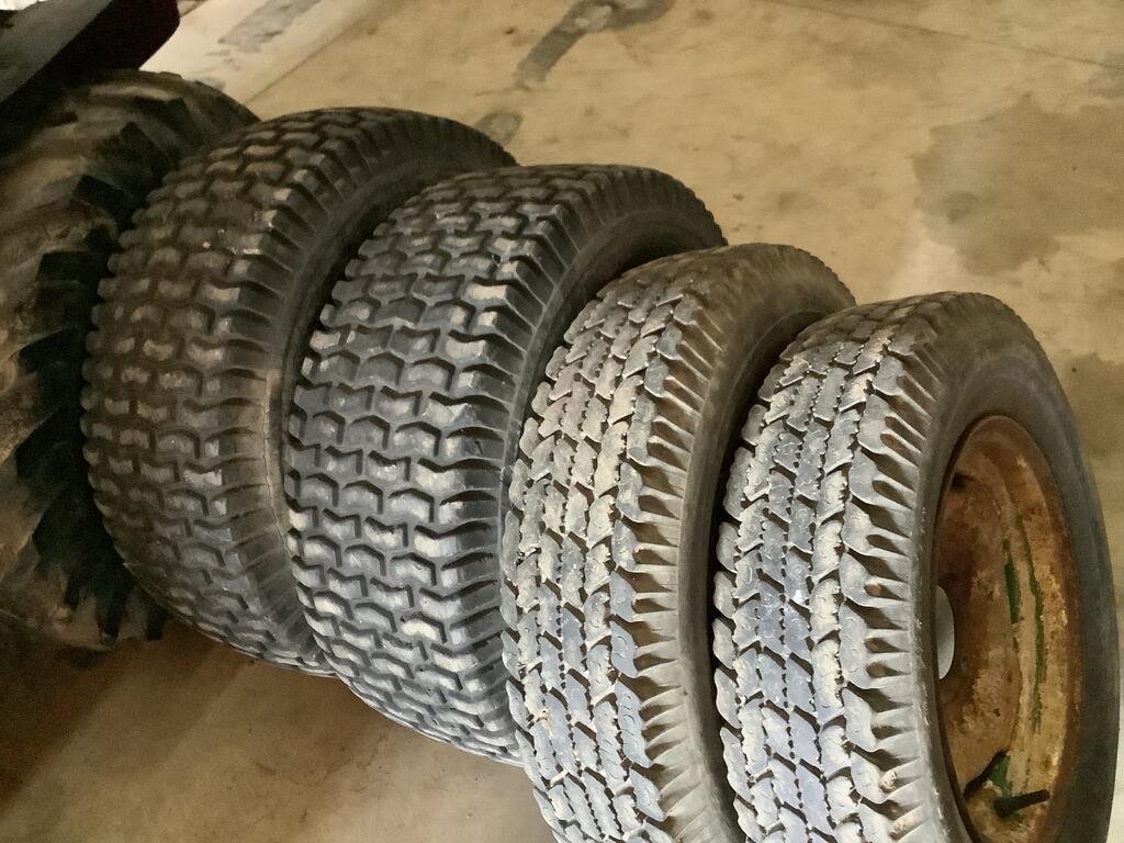

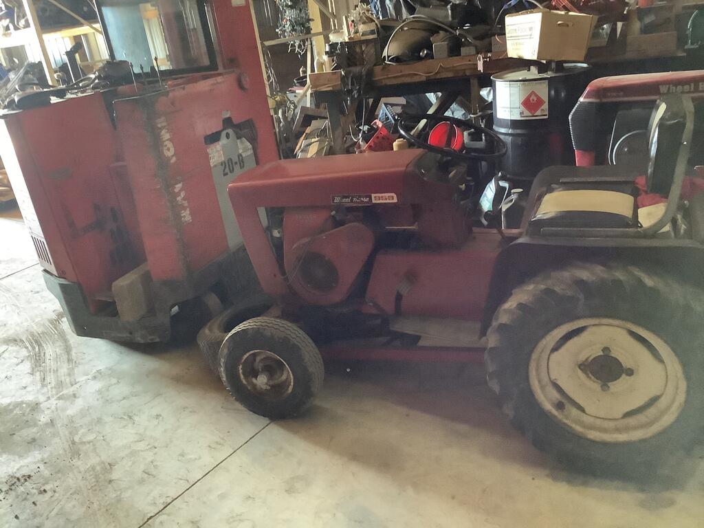

Pullstart 68,848 #1 Posted August 19, 2022 @jeremi3210 you mentioned that on many pulling tracks, you just run turfs. I have skinny ags on Chloe the 953 right now and she’s been the shop tug lately, pushing and pulling the hilo when it decides not to drive. I have some wide GT14 turf tires that I could use in place of ags. I also have some narrower car tires on 4 lug wheels. Would either likely provide more bite on the smooth surface or just be less psi to the ground? 3 Share this post Link to post Share on other sites

jeremi3210 743 #7 Posted August 19, 2022 For turfs I'd run the wider ones. And adjust the pressure pretty low so the rinkle a bit under load. I run about 8psi in mine but I believe that they are 6 ply tires. The guys I pull with are really loose on what they consider turf tire I think but if you want to be competitive you have to follow somewhat. 3 Share this post Link to post Share on other sites
Pullstart 68,848 #8 Posted August 19, 2022 Thanks @jeremi3210! I think I needed way more weight even though the tool box was full of lead, and maybe more gear reduction. 4 Share this post Link to post Share on other sites
jeremi3210 743 #9 Posted August 19, 2022 13 minutes ago, Pullstart said: Thanks @jeremi3210! I think I needed way more weight even though the tool box was full of lead, and maybe more gear reduction. My rear tires are filled also with bioballast. If my memory is correct they are about 100lbs each. I have some extra weights on it right now cause I we pull tomorrow! No worries! I will make sure you can see the videos this time! 1 1 Share this post Link to post Share on other sites
sjoemie himself 3,106 #10 Posted August 19, 2022 8 hours ago, Pullstart said: Like a drag car, more rubber to the road. Yep, should work. And lower tire pressure like @jeremi3210 suggested plus more weight are your best bet. Something like 'contact patch times pounds per square inch equals grip" 1 1 Share this post Link to post Share on other sites

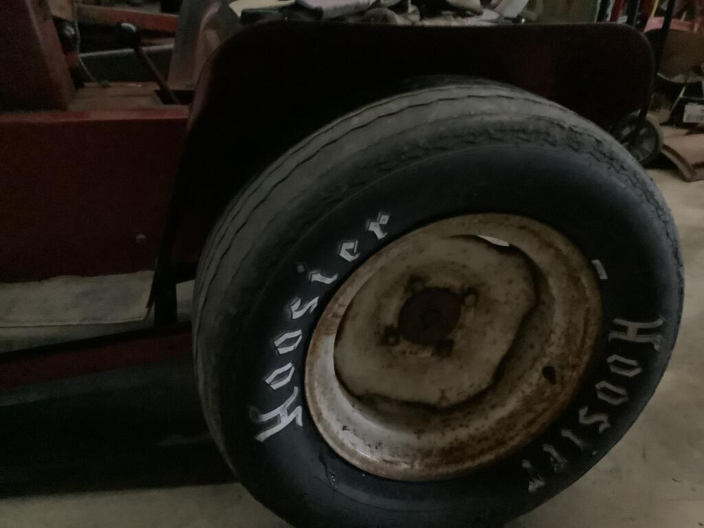

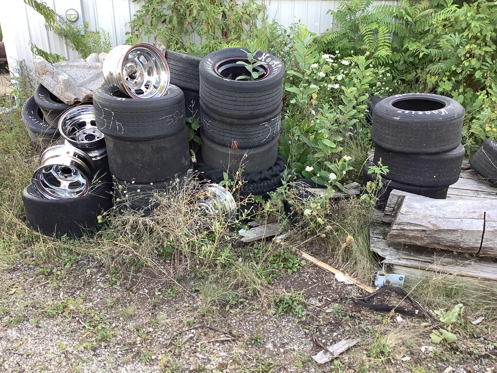

953 nut 64,073 #11 Posted August 19, 2022 7 hours ago, Mike'sHorseBarn said: I can't tell if those tires are original on your 953, but if they're old I imagine being dry rotted doesn't help the grip factor either lol Sixty year rubber tends to be a bit petrified, probably at least a 9 on the Mohs hardness scale. Kevin, you have a bunch of used roundy-round soft compound tires around, could be worth a try. 2 1 1 Share this post Link to post Share on other sites

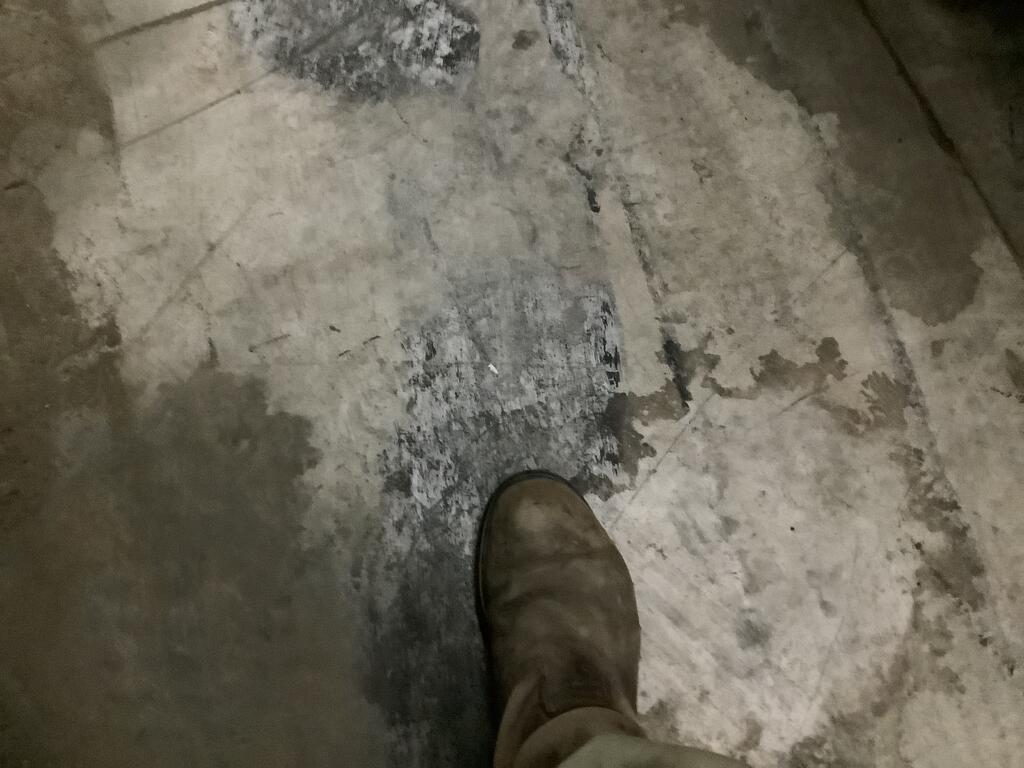

Pullstart 68,848 #12 Posted August 19, 2022 I pretty much just made wider marks on the ground! I’m more okay with smoking turfs off in the shop than perfectly usable ags though! 3 Share this post Link to post Share on other sites
Pullstart 68,848 #13 Posted August 19, 2022 3 minutes ago, 953 nut said: Sixty year rubber tends to be a bit petrified, probably at least a 9 on the Mohs hardness scale. Kevin, you have a bunch of used roundy-round soft compound tires around, could be worth a try. They’re even 15” tires too! GENIUS! 2 1 Share this post Link to post Share on other sites
953 nut 64,073 #14 Posted August 20, 2022 34 minutes ago, Pullstart said: GENIUS! 1 Share this post Link to post Share on other sites
Pullstart 68,848 #15 Posted August 20, 2022 @953 nut Mr. Richard, Rylee agrees. You’re pretty much a genius! These are 26.5x8-15’s and I have a handful of 27” tires too that would likely fit. I’ll keep the 26.5’s just for a little more low end grunt over the taller 27’s. I swear I had two spare 15” wheels but only found one. I’ll go back through pictures of taking delivery and see. 3 1 Share this post Link to post Share on other sites
