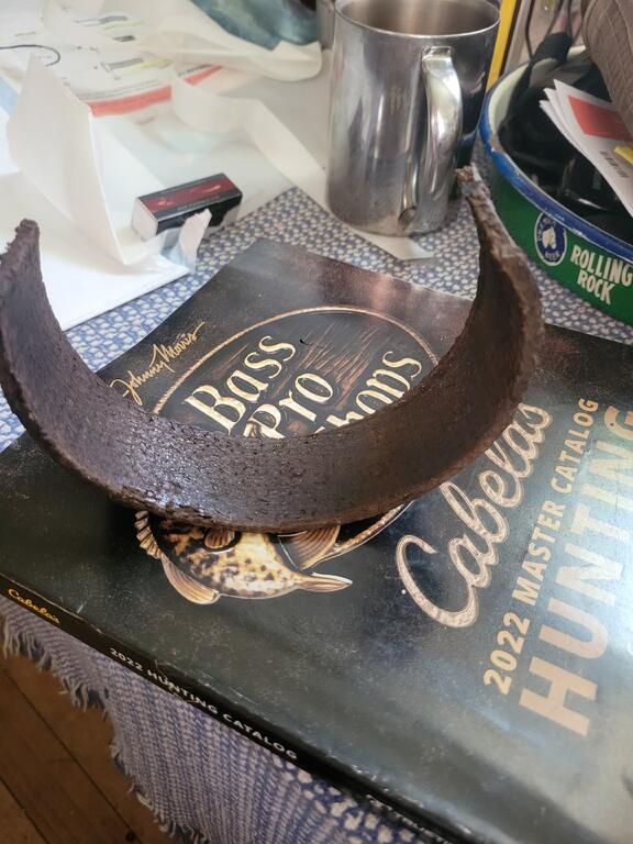

GreenMntRanger 38 #1 Posted August 13, 2022 How difficult is it to replace the the brake lining? Found mine on the lawn after I mowed HAHAHA Share this post Link to post Share on other sites

Snoopy11 5,731 #17 Posted August 14, 2022 @GreenMntRanger... can we see any pictures of your brake lining? You may not need to replace it... may just need to re-glue it back in... Don Share this post Link to post Share on other sites
GreenMntRanger 38 #18 Posted August 14, 2022 18 minutes ago, Snoopy11 said: @GreenMntRanger... can we see any pictures of your brake lining? You may not need to replace it... may just need to re-glue it back in... Don It's for the most part intact but super brittle. Knowing the former owner, it is safe to say it's OEM circa 1987 1 Share this post Link to post Share on other sites
Snoopy11 5,731 #19 Posted August 14, 2022 4 minutes ago, GreenMntRanger said: super brittle Yeppers... that's gonna need a replacement... Don Share this post Link to post Share on other sites
