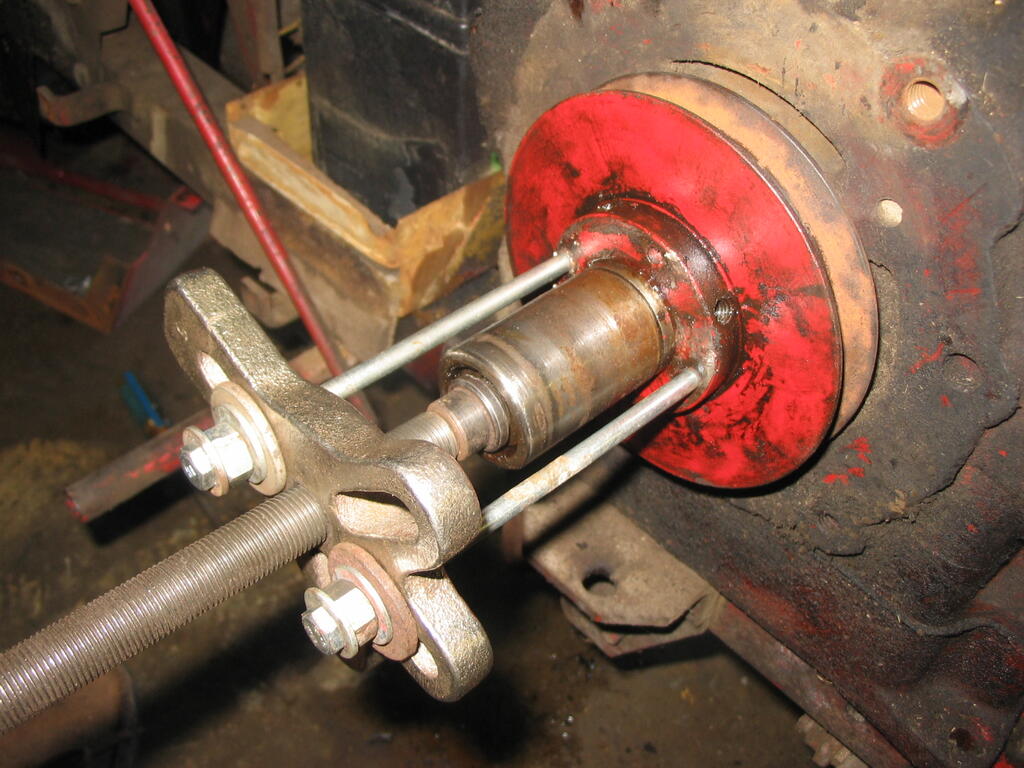

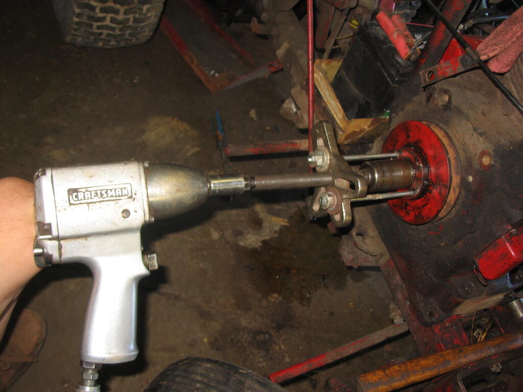

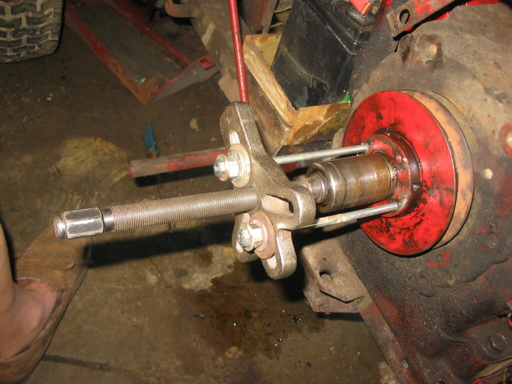

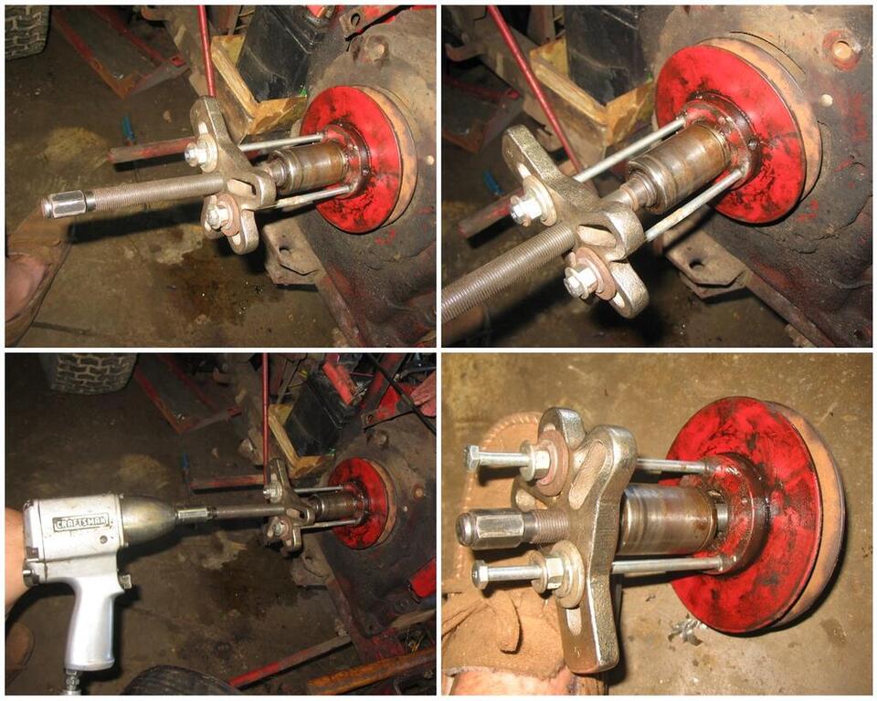

daveoman1966 3,884 #1 Posted August 12, 2022 3-jaw pullers will LIKELY break the engine V-pulley. This is the correct way to remove the V-Pulley, and ...in this case...a stuck Bearing Race. My Pneumatic Impact Wrench struggled some, but it did get the Race and Pulley off of the K301s Crankshaft ...without damage. In the video, I should have used my third hand to wedge the puller from spinning...but... 014.AVI 5 2 1 Share this post Link to post Share on other sites
ebinmaine 81,139 #2 Posted August 12, 2022 4 hours ago, daveoman1966 said: LIKELY break Agreed. Having tried it on a pulley that was worn and no loss I was surprised how easily it snapped. Engine pulley removal... The right way. Thanks Dave. 1 Share this post Link to post Share on other sites
ri702bill 13,316 #3 Posted August 12, 2022 Good setup there Dave, glad to see the setscrew(s) removed - allows you to get some penetrating juice down to where it needs to be. I prefer to use a socket and breaker bar with the puller rather than the impact - you can actually feel the progress, or lack of it - easier on the puller threads too ... Bill 1 Share this post Link to post Share on other sites

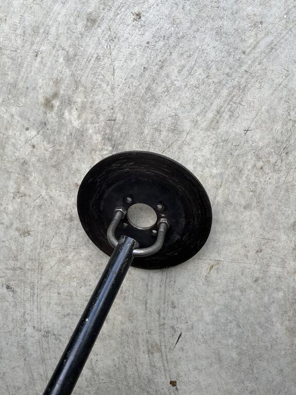

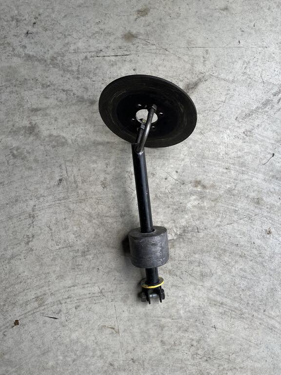

Evguy 567 #6 Posted August 26, 2022 While test fitting my pulley with a shaft sleeve I quickly tired of trying to remove it from the engine. While this probably wont budge a really stuck pulley, it has helped me a lot. I didn’t have a puller that would work so I built a slide hammer puller from pipe, old clutch disc, lead weight and exhaust clamp. One reason for this is I will need to remove pulley to service thrust bearing that will be between engine and pulley. It just bolts onto face of pulley with some longer 1/4 inch bolts. 2 Share this post Link to post Share on other sites
peter lena 10,107 #7 Posted August 26, 2022 @Evguy like that set up , very basic , yet that solid stop weight inertia impact , you can almost sense its ability to get something moving , had a gear drive pump , behind a large tank , very tight spot , once we got it freed up , used a towmotor , 20 ft of nylon strapping to drag it out , to add to the fun , that was on a call in , back in the day , pete Share this post Link to post Share on other sites
Evguy 567 #8 Posted August 26, 2022 I got tired of prying and tapping edge, It worked and didn’t take long to put together. Share this post Link to post Share on other sites
