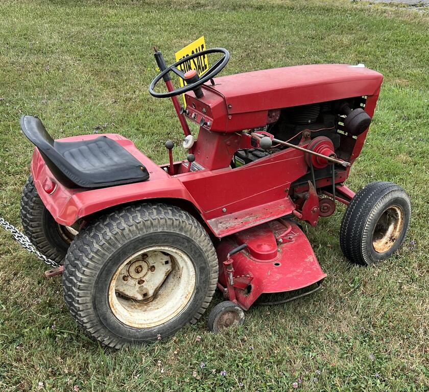

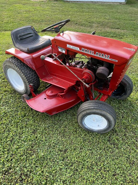

Prestons Hobby 76 #1 Posted August 10, 2022 First one of many to come. I looked a read a few threads on the paint and color others had chosen to go with. I myself found that I liked the Rustoleum Industrial Choice “SAFETY RED”. To me…. It looked like a perfect shade of red. I will attach before and after pics. I also wanted to add that, redoyourhorse.com made finding the decals very simple and easy to Order. 6 8 Share this post Link to post Share on other sites

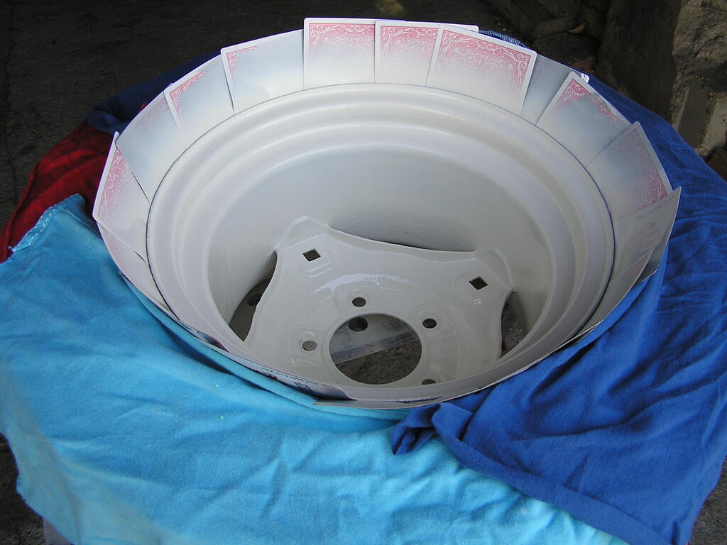

Pullstart 69,610 #6 Posted August 10, 2022 Looks good! I might suggest on your next one, cheap playing cards from the dollar store make for great solutions to deflate your tires, stick the cards between them and the wheels, then paint Much less overspray 5 Share this post Link to post Share on other sites

ri702bill 11,768 #9 Posted August 11, 2022 (edited) 13 hours ago, Prestons Hobby said: Definitely going to use the playing cards next time. 😂 everything works and runs like a champ. Mower deck is solid as can be and mows great. Thank you for the comments As @Pullstart mentioned, the playing cards give a crisp edge with no overspray. If the temperature is below 80 degrees or so, I place the rattle can in a pan of hot waper from the tap - thins the paint and raises the pressure inside the can for better results. Spent all of $1 at the local Dollar Store for the plastic coated Jumbo sized playing cards - once done, they are reusable for the next project... Edited August 11, 2022 by ri702bill 4 Share this post Link to post Share on other sites

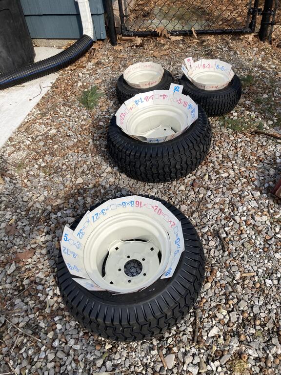

SylvanLakeWH 31,038 #10 Posted August 11, 2022 But I use math flash cards… something very therapeutic about painting over math problems… 1 7 Share this post Link to post Share on other sites

D_Mac 9,334 #15 Posted August 19, 2022 I would also recommend tying down some of those cables and fuel lines away from the debris screen. I use zip ties. Looks neater and keeping them in close will prevent brushing past a bush or branch and ripping them off. Also some blk duct tape or some plasti-dip on the seat corners will hide some holes. When I paint wheels i paint the inside and the outside the same color. Nice looking machine, good job. Share this post Link to post Share on other sites
