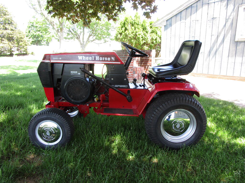

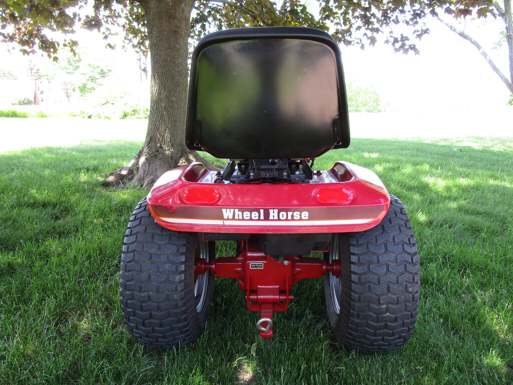

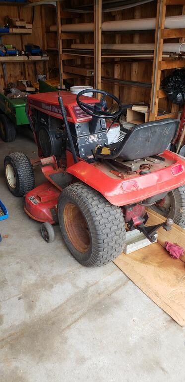

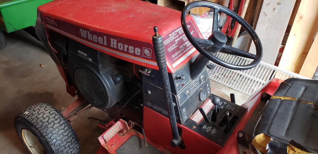

JCM 10,279 #4 Posted August 11, 2022 They are a great tractor. This one was headed to the scrap pile and I saved it. Not mint by any means but a great worker. Before and after pics. You will like it if you buy it. Good luck and to 5 Share this post Link to post Share on other sites

peter lena 9,340 #7 Posted August 11, 2022 @JCM nice clean up / save on that ! did you oil lubricate that finish ? a thorough baseline service and operational check of everything is your status . found that the time to look for problems , is when things are working , that way its a quick backtrack , to an area that had some issues , that needed help . also a regular look see , will keep the gremlins away . looks clean and solid , good luck with it , pete 1 1 Share this post Link to post Share on other sites

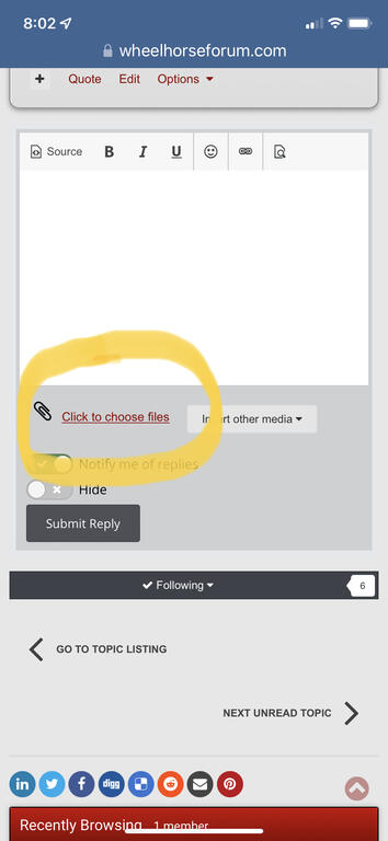

Terry M-(Moderator) 2,255 #11 Posted August 11, 2022 1 hour ago, Hampton said: Link removed. Don't know how to attach pictures. If your link was to a site such as Craig’s list ..those are not allowed per forum rules. use the red “click to choose files”towards the bottom left to add/down load pictures. 1 Share this post Link to post Share on other sites
Terry M-(Moderator) 2,255 #12 Posted August 11, 2022 Share this post Link to post Share on other sites

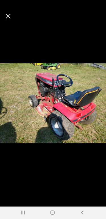

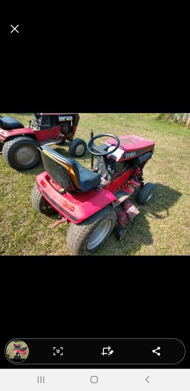

tunahead72 2,558 #14 Posted August 11, 2022 I just checked out his ad, and noticed a couple of things you'll want to check out and ask about... The mower deck looks a bit muddy, and may need pulley covers. And the left front tire looks like it's been scraped somehow. Actually, all the tires and the condition of the deck indicate that this tractor may have run on wet ground on some kind of regular basis. That's not a problem necessarily, but I would at least reach under the deck and see how much grass is clumped up in there. Also, the brake pedal appears to be too far forward, possibly because the footrest is bent at the corner there. That's usually easily fixed, but make sure there's no other problems in that area. $400 is a pretty fair price for a good running 310-8 and deck, at least around where I live, assuming it doesn't need anything major done. Good luck! 1 Share this post Link to post Share on other sites
Hampton 95 #15 Posted August 11, 2022 13 minutes ago, tunahead72 said: I just checked out his ad, and noticed a couple of things you'll want to check out and ask about... The mower deck looks a bit muddy, and may need pulley covers. And the left front tire looks like it's been scraped somehow. Actually, all the tires and the condition of the deck indicate that this tractor may have run on wet ground on some kind of regular basis. That's not a problem necessarily, but I would at least reach under the deck and see how much grass is clumped up in there. Also, the brake pedal appears to be too far forward, possibly because the footrest is bent at the corner there. That's usually easily fixed, but make sure there's no other problems in that area. $400 is a pretty fair price for a good running 310-8 and deck, at least around where I live, assuming it doesn't need anything major done. Good luck! I'll check those out but not planning to use it as a mower. Have a zero turn at home. This while be stored on another property at the garden 1 Share this post Link to post Share on other sites

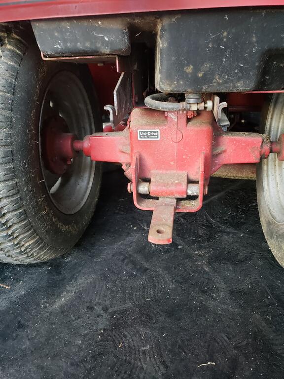

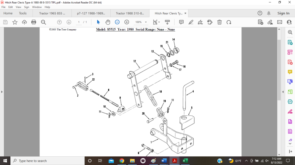

953 nut 60,928 #19 Posted August 13, 2022 On 8/11/2022 at 9:13 PM, Hampton said: Well, I went ahead and got it. Seems to be in workable condition. Now I need to figure out how to put a middle buster (potato plow) on it. Then find a tiller. You are in an area that was rich in dealerships so finding parts and accessories shouldn't be too hard. Depending on the brand of middle buster you will need a slot hitch or a Clevis hitch. I have attached a drawing of the parts and pieces of the clevis. The pivot point is the pin that holds your trailer hitch and you will also need a lift cable and conduit sold by @wheelhorseman. 1 Share this post Link to post Share on other sites

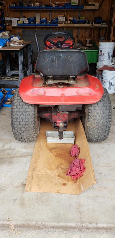

Hampton 95 #20 Posted August 13, 2022 (edited) 3 hours ago, 953 nut said: You are in an area that was rich in dealerships so finding parts and accessories shouldn't be too hard. Depending on the brand of middle buster you will need a slot hitch or a Clevis hitch. I have attached a drawing of the parts and pieces of the clevis. The pivot point is the pin that holds your trailer hitch and you will also need a lift cable and conduit sold by @wheelhorseman. This is what the back of mine looks like. Just saw a picture from wheelhorse website. Now I understand. Edited August 13, 2022 by Hampton 1 Share this post Link to post Share on other sites
Hampton 95 #21 Posted August 13, 2022 Found a hitch in marketplace. I'll just need the rest of the parts. 1 Share this post Link to post Share on other sites
