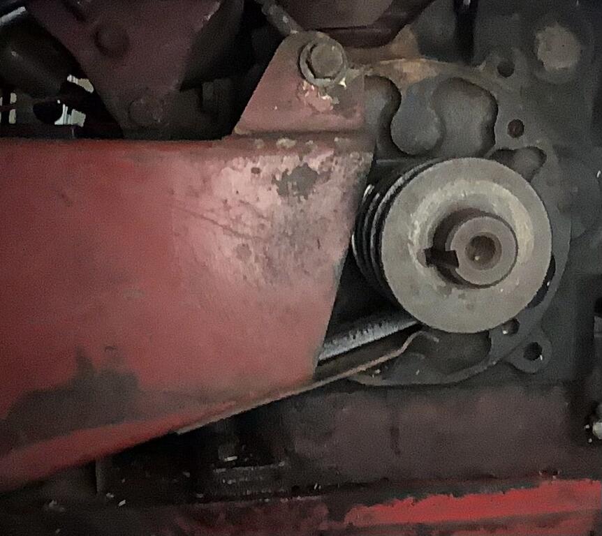

Pullstart 71,291 #27 Posted August 9, 2022 This is what your belt guard should look like to your engine pulley. Does it fit well? 1 Share this post Link to post Share on other sites

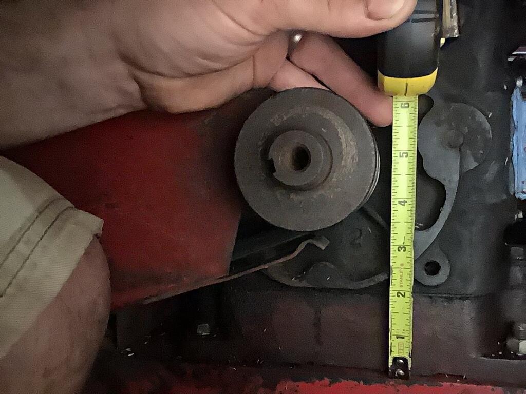

Pullstart 71,291 #28 Posted August 9, 2022 10 minutes ago, 857lover said: it’s 6 inches I measure 4-3/4” to the center of the crank. 1 Share this post Link to post Share on other sites

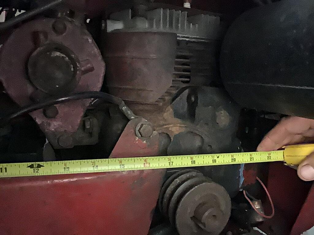

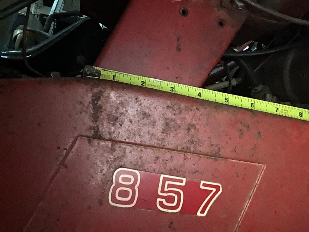

Pullstart 71,291 #29 Posted August 9, 2022 Measuring from the dash tower /shifter box to the centerline of the crank, it should be 17-3/4”. 1 Share this post Link to post Share on other sites

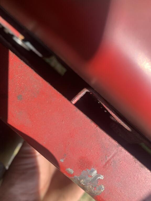

857lover 291 #34 Posted August 9, 2022 (edited) 1 hour ago, Pullstart said: I think we should position the crankshaft in the right spot, then figure out the belt. i just noticed that the “finger” on the idler is hitting the belt shroud why is that happening? Edited August 9, 2022 by 857lover added photo Share this post Link to post Share on other sites
Pullstart 71,291 #35 Posted August 9, 2022 Because the belt is too big for the engine location. 2 Share this post Link to post Share on other sites

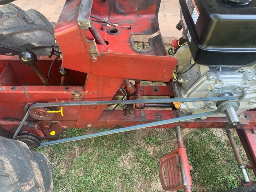

Snoopy11 5,731 #36 Posted August 9, 2022 All of the issues that Mike @squonk has noted in this thread are 100% correct. Normally, when I swap engines... swap pulleys or anything like that... engine belt guards have to be fabricated... and 1 major item has to be added to resolve this type of problem. Check out this edited picture. So, the top yellow mark is where the clutch idler pulley should be. The bottom yellow mark is where I advise putting a static flat idler pulley to tighten up the belt tension (move the clutch idler pulley forward)... and provide extra surface area for the transmission pulley. Put the flat idler pulley somewhere in that area, ensuring that there is clearance between the clutch pulley movement and this flat idler... Go to tractor supply or some farm store, and pick up a flat idler pulley like this: Here is what I cannot guarantee. I cannot guarantee that the belt that you currently have on that machine will work, you may need to pick up a longer belt after performing this modification. Having said that, to get the belt to stop... you may need to add more belt guards on the engine area like I did on my 800 Special... (you can check out my modified machines if you need some ideas. It is also POSSIBLE that you may need a belt guard on the backside of the transmission pulley to get the belt to fully disengage. All of this just depends on how modified your pulley system is, and how everything turns out. Don 1 Share this post Link to post Share on other sites

Snoopy11 5,731 #39 Posted August 9, 2022 I should clarify 1 more thing that Mike and Kevin touched on here... The clutch pulley tab should be ON TOP of the pulley... as... with the pulley all the way back where it is now, the tab itself is likely tagging the belt, wearing it on the top side... This is where it should be... Don 1 Share this post Link to post Share on other sites
