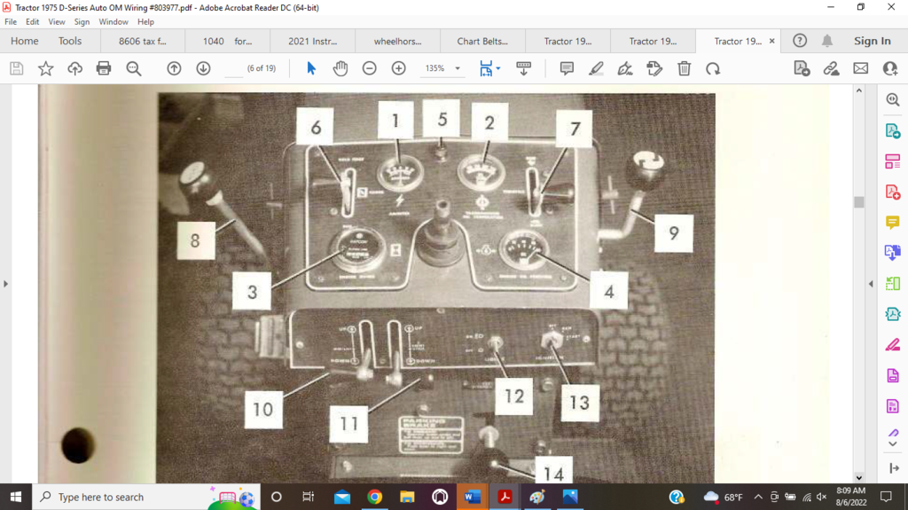

953 nut 68,518 #12 Posted August 6, 2022 Item # 8 in this photo is the PTO lever, if is not all the way back toward the operator the engine will not turn over from the ignition switch. The PTO switch is under the dash but we were thinking you may have forgotten to pull back on the PTO lever when the tractor ran out of gas. We have all done it at one time or another. 1 Share this post Link to post Share on other sites
