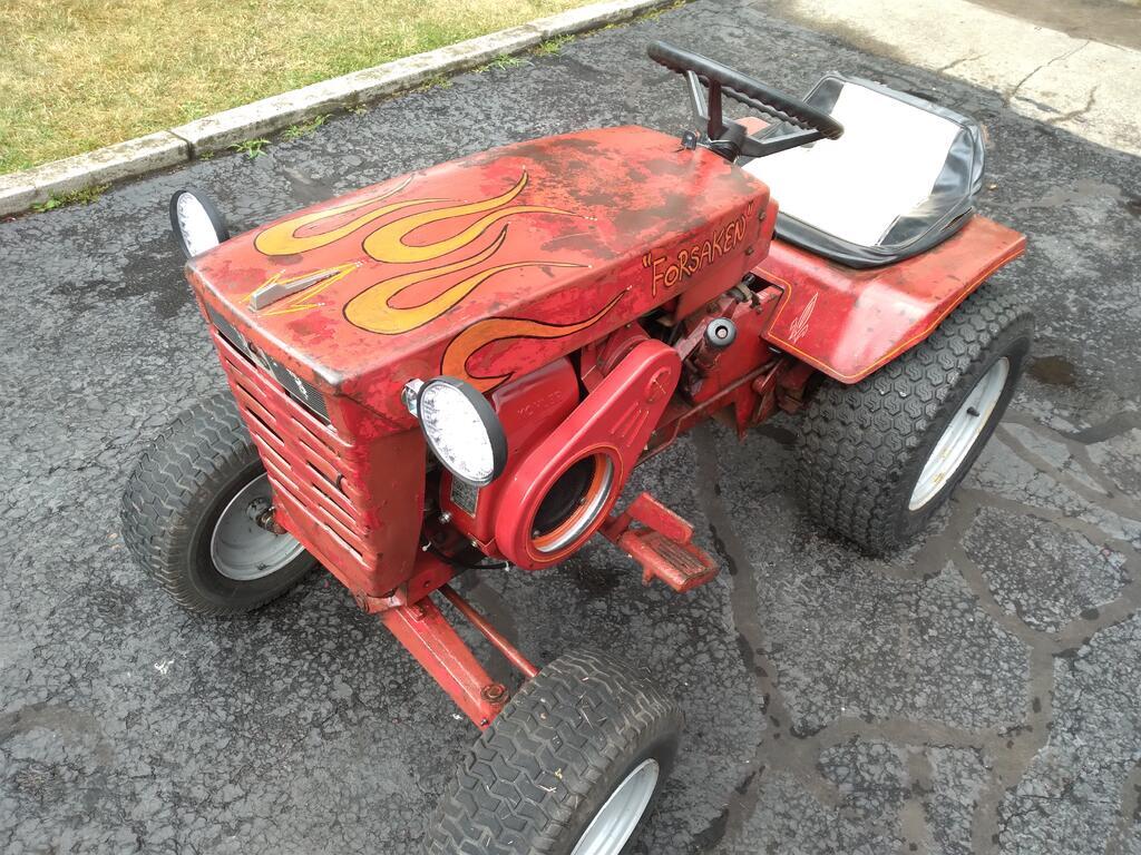

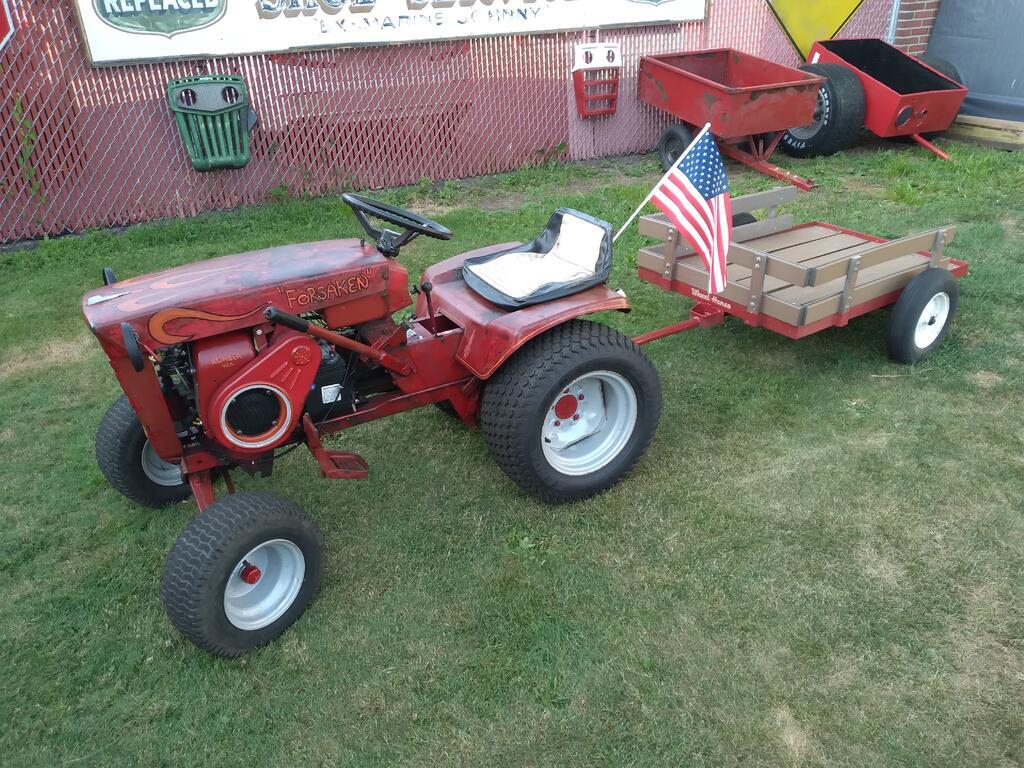

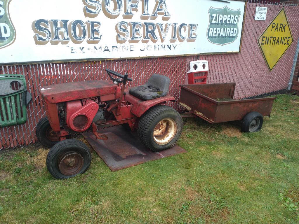

D_Mac 9,339 #29 Posted August 9, 2022 recheck that model number did you mean 855 or 856 ? The first number represents the horse power.. 8 being 8hp... the second number represents it being 3 forward gears, and reverse that number would be the 5. The last number represents the year.. 5 = 1965.... 6 = 1966... 7=1967... etc. The engine, lights and gas tank are not original. Looks like its been painted. If it runs and drives fine I would just buff out what paint is on and put it to work. Im guessing yours is an 856. I just fixed one up. Mine had original engine. Sometime in its life it was painted over. I removed what paint would come off and added the flames and pinstriping. I also painted the engine after servicing it. They dont all have to be shiney but if thats what you like go for it. 1 Share this post Link to post Share on other sites
