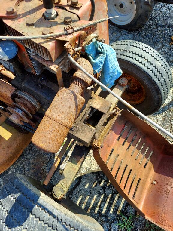

josephbruce11212@gmail.co 262 #1 Posted August 2, 2022 Hello, Currently working on a 605. I have the tractor apart in the process of cleaning and repainting. I want to replace the current exhaust on my Tecumseh 6HP. Looking for ideas and recommendations. I was thinking maybe a flapper or maybe a salt n pepper....just don't know. Thanks!! Pictures appreciated!!! Share this post Link to post Share on other sites

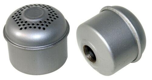

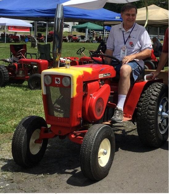

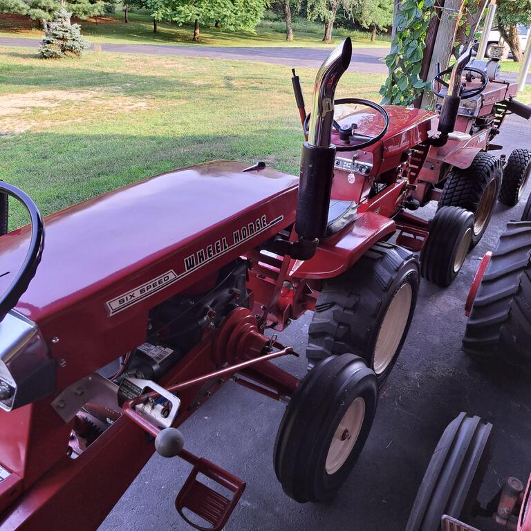

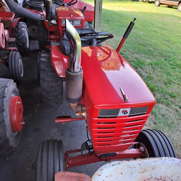

WHX?? 57,923 #8 Posted August 2, 2022 Ahhh OK.. stack you mean then. Far as those go only three types I would go with. One is one of Jim Kemps... member here & 1st & 2nd pic. His are 1 inch but you talk to him bet he could make one 3/4 thd if asked or use a reducer coupling and leave a strait pipe for a tink tink. Second is make my own. I have a bromance with @Achto that has a baffle press. Close third is a Cub stack. All over fleabay, affordable and have a nice mellow tone but need to cut off a mounting tab. Here again would need to bush down to 3/4. ... 3rd pic. The one on my avatar got round filed .... It just didn't fit the look. Store bought and a bit loud and tall. Same tractor with one of JK's and happy as a clam. 4th pic. 5 1 Share this post Link to post Share on other sites

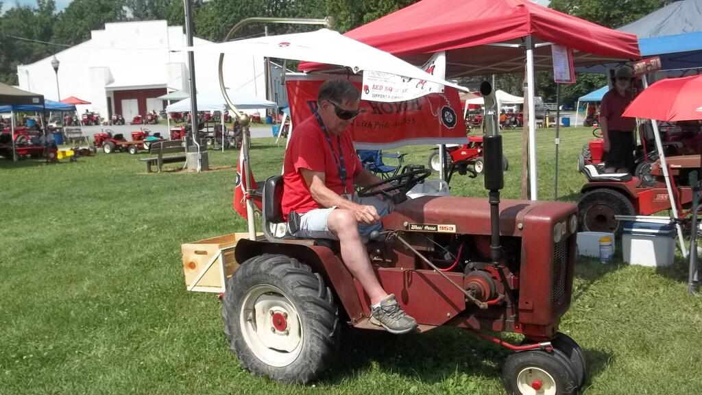

953 nut 68,827 #10 Posted August 2, 2022 @jimkemp makes a great muffler, I have one on a 953 and love the mellow tone. I used a 1" X 1/2" X 1" black iron pipe "Tee" with a 1/2" pipe plug drilled out to 1/4-20 to support that muffler. Another 953 I had a Harley muffler on, it is a bit heavier and slips over a 1 1/4" pipe, very mellow and looks good. My GT-14 has a Tractor Supply IH muffler (one inch) with a rain cap on it, when you throttle down it backfires, sort of cool for an old hotrodder like me. 2 4 1 Share this post Link to post Share on other sites
Heatingman 977 #11 Posted August 3, 2022 1 hour ago, 953 nut said: @jimkemp makes a great muffler, I have one on a 953 and love the mellow tone. I used a 1" X 1/2" X 1" black iron pipe "Tee" with a 1/2" pipe plug drilled out to 1/4-20 to support that muffler. Another 953 I had a Harley muffler on, it is a bit heavier and slips over a 1 1/4" pipe, very mellow and looks good. My GT-14 has a Tractor Supply IH muffler (one inch) with a rain cap on it, when you throttle down it backfires, sort of cool for an old hotrodder like me. I like that burgundy type color on the horse in the top photo. Was that a repaint many years ago, or how it came? Share this post Link to post Share on other sites

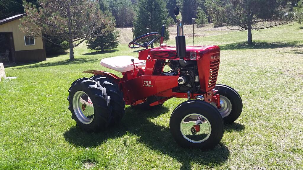

Achto 32,513 #12 Posted August 3, 2022 (edited) 11 hours ago, WHX?? said: Plenty of guys run a strait pipe Rob with no issues. Strait pipes are only beneficial when running wide open throttle. Something that a small engine rarely does under normal operation. Turbulence in the exhaust pipe benefits the performance of an engine through 95% of the operating range Below is a pic of the baffle for the stack that I made for one of my tractors. . Looking down the end of the pipe shows the louvers that causes the exhaust turbulence Finished product installed. Yes it's tall, keeps the fumes out of my face. Edited August 3, 2022 by Achto 7 2 Share this post Link to post Share on other sites

953 nut 68,827 #15 Posted August 3, 2022 10 hours ago, Heatingman said: I like that burgundy type color on the horse in the top photo. Was that a repaint many years ago, or how it came? I don't think it had been repainted, just a mix of RED paint and surface rust. If allowed to age to perfection this is the color it will eventually achieve. 4 1 Share this post Link to post Share on other sites
