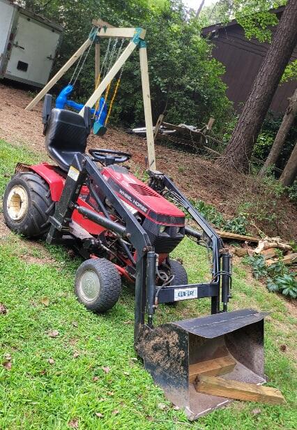

Jrblanke 976 #28 Posted September 6, 2022 (edited) Good morning. Just wanted to post an update. Basically, I love this thing. I’ve put about 6 hours on it this past month and boy is it a time saver! I can’t believe I let it sit so long without using it. I guess I let “perfect” get in the way of “better” when it came to my restoration/resurrection plans go. Anyways, old football and weight lifting injuries make it difficult to do things like shovel rock or lift 200+ lbs. I’m usually OK to lift heavy things as long as they are less than about 130 lbs. I used to be the guy everyone called to help move stuff. Times have changed, and as Dirty Harry would say, a man has got to know his limitations. This weekend was one of those times. Dad and I were going to lift the swing set we built for my kids, and I had to say no. This sucked, knowing that I’m 35 and he is 63, but he also doesn’t have the same issues that I have. Anyways, I used the loader to set it upright after construction, then move it into position. Man it sure did save my back. So what’s next? Well, a few things. Like I said I’ve put about 6 hours on it. 4 hours of which has been moving gravel. I’ve noticed a few things. 1. I am losing traction when I back up with a load. I believe this is because I don’t have enough weight, and because I am over loading the bucket. It’s the snow bucket, and from my crude calculations it will hold about 5 cubic feet of material. If a cubic foot of gravel weighs 100 lbs, then I am at least loading it to capacity if not over loading it. I have 240lbs of weight on the tractor (140 of the back, and 100lbs in wheel weights). According to the manual, it should have 280lbs of counterweight. So I could either remove the bulldozer tracks that I have bolted to the rear weight bar and get some suitcase weights, or I could load the tires. I’m tempted to load the tires but I need to do a little more reading. One thing I don’t want to do is overload the loader and cause things to bend, crack or break. It is difficult to steer under load. 2. The original turf Dico tires I believe are to blame for this. My 520H has the gear reduction steering so it should be more easy to steer. I would like to replace the front tires with some higher ply ribbed tires. I think that will improve my steering. 3. To keep the bucket from rusting out, I'm planning to power wash it after I finish moving the gravel, and spray paint the parts where the paint has worn off. I can tell where it had water standing in it for a long time, the bucket is pretty pitted. 4. The last issue is with the 520H itself. Its got 1160 hours on it, and while it runs well, I’ve noticed it puts out a puff of smoke on start up or if I rev it up when its not hot. Ive only put about 8 hours on the machine in about 6 years. It came with some kind of motorcycle oil. I can’t remember off the top of my head, but it might be AMS oil. I plan to change it soon and see what happens. It could be that it is just normal wear. This is my first Onan P220. Edited September 6, 2022 by Jrblanke 2 Share this post Link to post Share on other sites

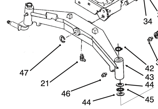

Handy Don 16,948 #37 Posted September 7, 2022 1 hour ago, lynnmor said: Since there are no bearings in the front axle those three grease fittings should be used often. Your '95 520 with the swept axle and 1" spindles should have load-bearing thrust bearings, (#45) in this image. @lynnmor's advice about hoisting the front when greasing will help the grease get down to those. Share this post Link to post Share on other sites
lynnmor 8,901 #38 Posted September 7, 2022 1 hour ago, Handy Don said: Your '95 520 with the swept axle and 1" spindles should have load-bearing thrust bearings, (#45) in this image. @lynnmor's advice about hoisting the front when greasing will help the grease get down to those. The larger worry is the #43 axle wearing, there are no bushings and to repair it you need to bore and install bushings. Boring the axle will weaken it. I install a #44 under the #42 snap ring to reduce play and help with keeping dirt and water out of the axle. Pumping grease in the #46 fitting till it comes flushes the axle will help get dirt out and reduce wear. 1 Share this post Link to post Share on other sites
Handy Don 16,948 #39 Posted September 7, 2022 40 minutes ago, lynnmor said: help with keeping dirt and water out of the axle Great point. I've put caps on top of the spindles to help with that as well. Share this post Link to post Share on other sites
