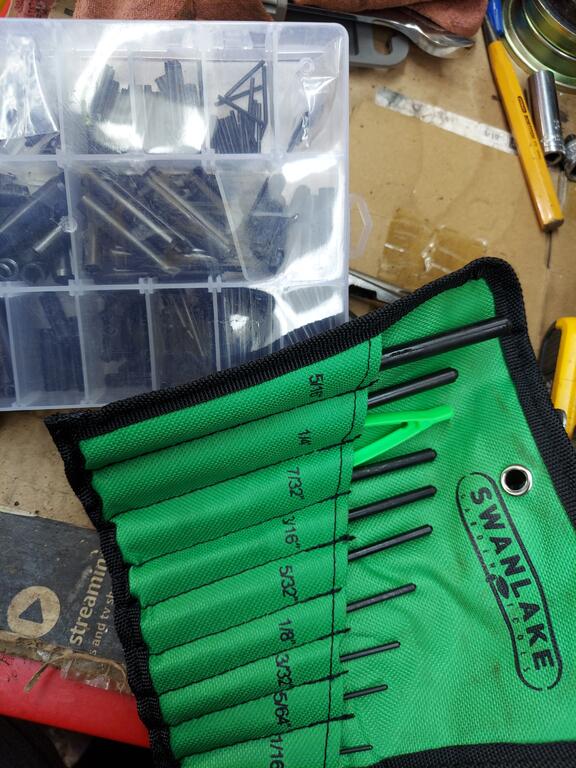

rjg854 13,082 #126 Posted August 1, 2022 I could be wrong but it looks like it's held on with a roll pin Share this post Link to post Share on other sites

josephbruce11212@gmail.co 262 #129 Posted August 1, 2022 20 minutes ago, rjg854 said: I could be wrong but it looks like it's held on with a roll pin It is held on by a roll pin. I will disassemble but once reinstalled I don't think that is the end with the issue...right? 1 Share this post Link to post Share on other sites

ebinmaine 79,141 #132 Posted August 1, 2022 8 minutes ago, josephbruce11212@gmail.co said: true, but with a roll pin already set through the shaft the hole in the shaft sorta becomes the "fixed" point? I could be over or under thinking this You are correct IIFF none of the parts are worn out. Check the ends of the shaft where it would be riding in the bushings to make sure that it still measures at or close to stock size which I think is 3/4? If you already have a warrant out main shaft there's no point in disassembly and rewelding. That being the case it would be better to disassemble... then weld on a new piece. 1 1 Share this post Link to post Share on other sites

rjg854 13,082 #134 Posted August 1, 2022 On my 854 I drilled for a larger size roll pin and that completed my fix, an easier way would be to set it where you want it and have it welded. 2 Share this post Link to post Share on other sites
josephbruce11212@gmail.co 262 #135 Posted August 1, 2022 2 hours ago, rjg854 said: On my 854 I drilled for a larger size roll pin and that completed my fix, an easier way would be to set it where you want it and have it welded. Good idea Share this post Link to post Share on other sites

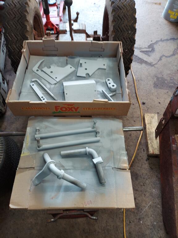

josephbruce11212@gmail.co 262 #136 Posted August 3, 2022 Got some of the small stuff primed....its getting there!! Wooooot! 2 Share this post Link to post Share on other sites

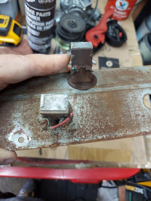

josephbruce11212@gmail.co 262 #137 Posted August 3, 2022 Can someone let me know what the 2 left side switches are? When I picked up the tractor it did have lights on the seat....but the 605 didn't have a battery 1 Share this post Link to post Share on other sites

953 nut 66,589 #140 Posted August 8, 2022 On 8/3/2022 at 12:36 PM, josephbruce11212@gmail.co said: let me know what the 2 left side switches are? When I picked up the tractor it did have lights on the seat....but the 605 didn't have a battery Previous owners sometimes do things that just make you go Hmmmm..... 1 1 1 4 Share this post Link to post Share on other sites

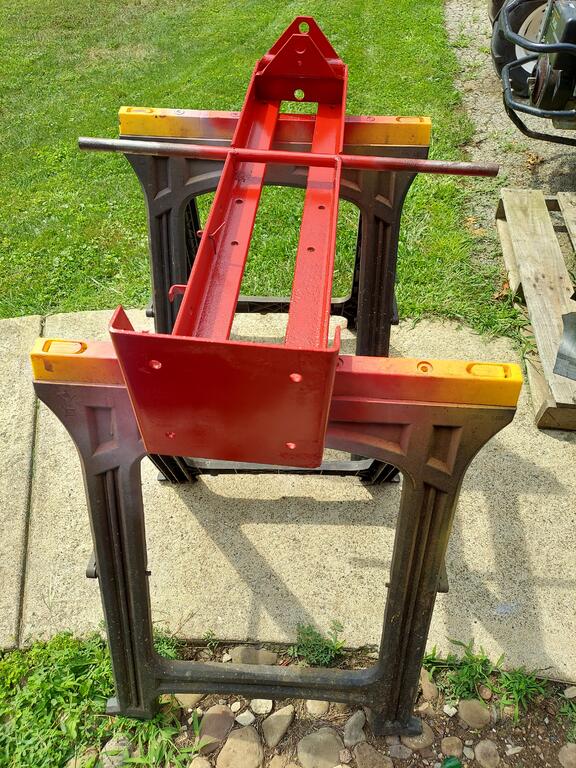

josephbruce11212@gmail.co 262 #142 Posted August 8, 2022 (edited) Did some painting today....Regal Red was the color of choice. Couldn't get the hitch off...it's on there good...painting with it on as best as possible. Edited August 8, 2022 by josephbruce11212@gmail.co 1 2 Share this post Link to post Share on other sites
