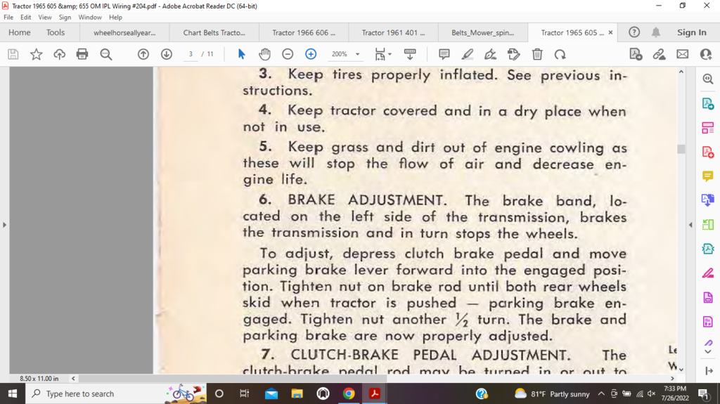

953 nut 67,488 #52 Posted July 26, 2022 The manual has a good brake adjustment write up. 1 Share this post Link to post Share on other sites

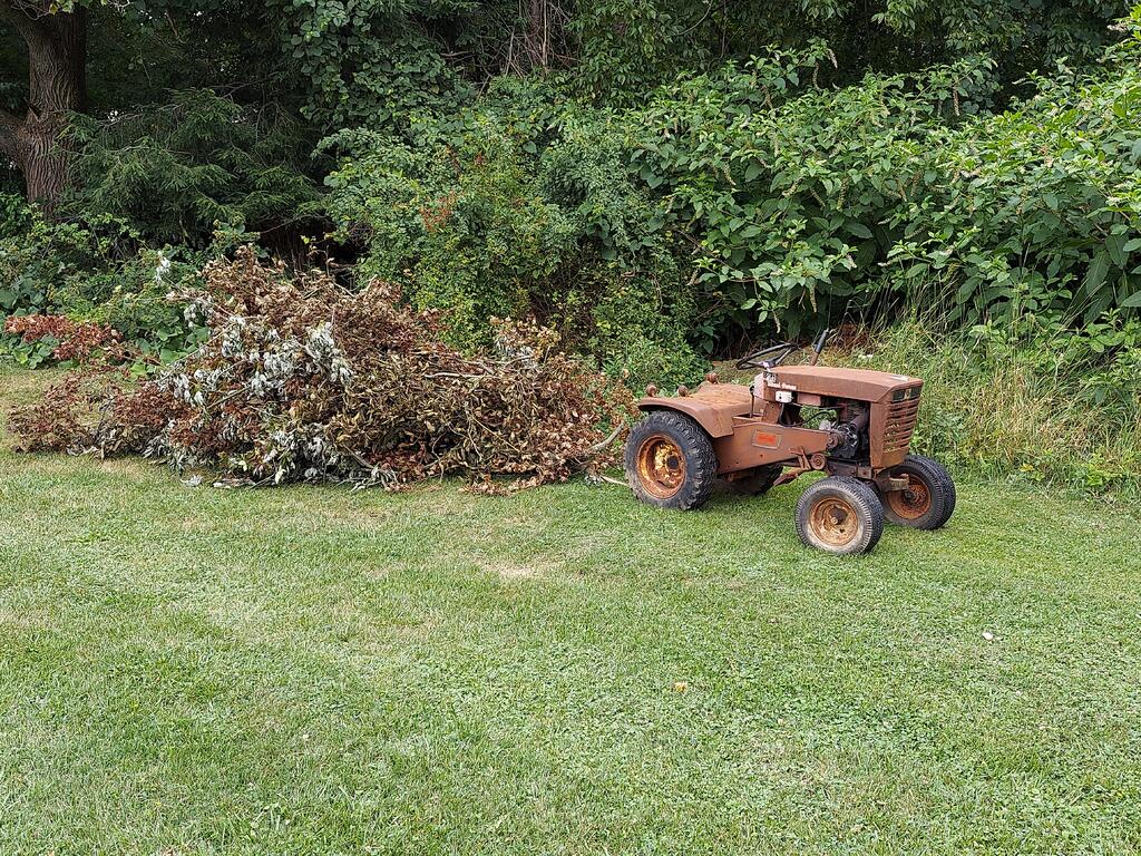

josephbruce11212@gmail.co 262 #65 Posted July 27, 2022 Gave her a light task.... 6 1 Share this post Link to post Share on other sites

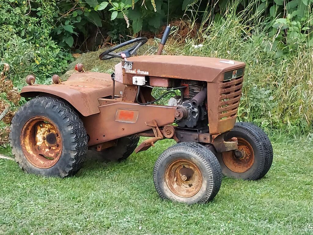

The Freightliner Guy 1,364 #66 Posted July 27, 2022 Have you been driving it with no seat this whole time or anything but the raw metal Share this post Link to post Share on other sites
Handy Don 16,973 #67 Posted July 27, 2022 Looks like you are on the road. Good news. Guess you are looking for a seat, now, too! Just a note on speeds, WH engineers designed all their stock tractors to have speeds appropriate for their intended tasks--mowing, plowing, etc. and, TMK, that was a top speed of around 6 mph (except for the 520-HC, aimed at commercial landscapers, which could cook along at 9-ish). Some folks, of course () have swapped pulleys and done other tweaks to boost speeds. 1 1 Share this post Link to post Share on other sites
josephbruce11212@gmail.co 262 #68 Posted July 27, 2022 20 minutes ago, The Freightliner Guy said: Have you been driving it with no seat this whole time or anything but the raw metal Raw metal, not so bad 1 Share this post Link to post Share on other sites

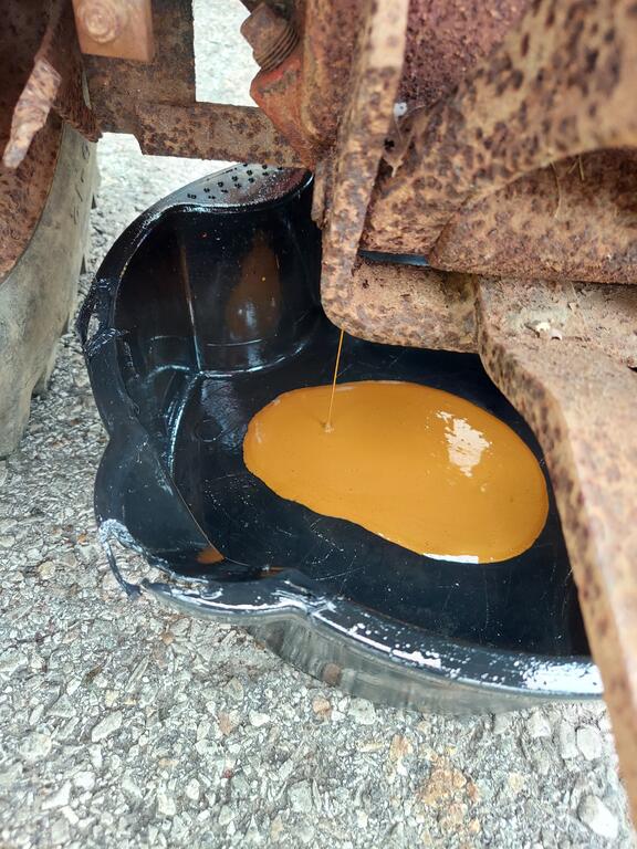

josephbruce11212@gmail.co 262 #69 Posted July 27, 2022 Not the color I was hoping for.... 3 1 Share this post Link to post Share on other sites
The Freightliner Guy 1,364 #70 Posted July 27, 2022 That looks like peanut butter hahaha but also that can’t be to good Share this post Link to post Share on other sites
Snoopy11 5,731 #71 Posted July 27, 2022 2 minutes ago, josephbruce11212@gmail.co said: Not the color I was hoping for.... Well, some people would tell you to run diesel in the transmission to clean it out... I would recommend a tear-down... Don 1 Share this post Link to post Share on other sites
josephbruce11212@gmail.co 262 #72 Posted July 27, 2022 15 minutes ago, Handy Don said: Guess you are looking for a seat, now, too! Looking for a seat and a front wheel, they are mixed matched. The left front has multiple washers on front and back of wheel. 1 Share this post Link to post Share on other sites
josephbruce11212@gmail.co 262 #73 Posted July 27, 2022 1 minute ago, Snoopy11 said: Well, some people would tell you to run diesel in the transmission to clean it out... I would recommend a tear-down... Don I'll probably try to clean it a bit, but it will be tore down and rebuilt at a point. 1 Share this post Link to post Share on other sites
Handy Don 16,973 #74 Posted July 27, 2022 Just now, josephbruce11212@gmail.co said: Not the color I was hoping for.... Given that the tractor looks like it's been either left out or submerged (or both?), that is no shock at all. Lots of threads here if you search for "flushing diesel" that'll step you through getting after that. PLEASE be sure to dispose of the contaminated fluid responsibly. Also, you almost certainly will need a new boot for the shifter. Several of the vendor supporters of this site can fix you up 1 Share this post Link to post Share on other sites
