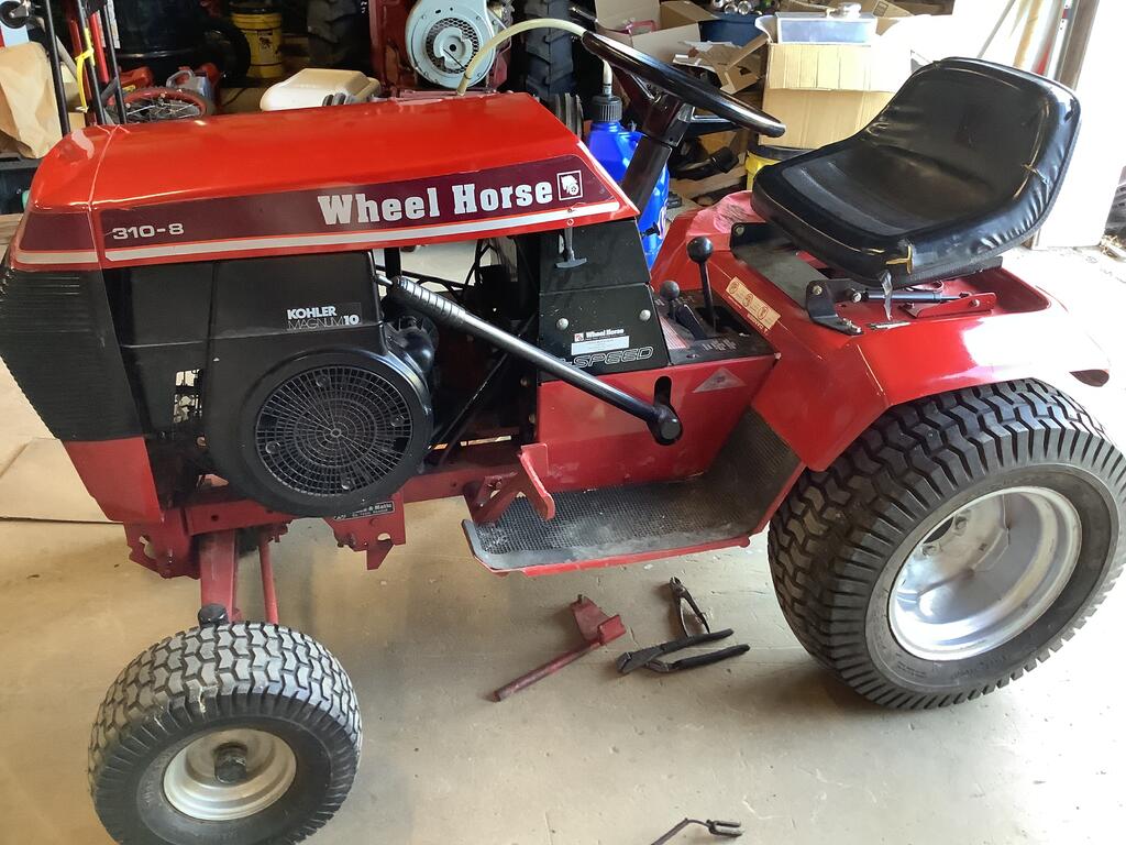

Pullstart 70,702 #1 Posted July 21, 2022 I’m replacing the lift cable on a 310-8 without the rock shaft. I was wondering if the top or bottom hole should be used on the lift quadrant? I looked through the 300 series OM without any luck. I even greased the hitch pin! Share this post Link to post Share on other sites

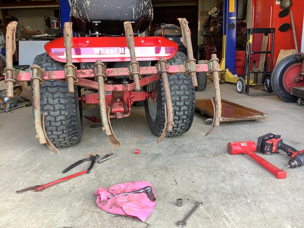

Pullstart 70,702 #2 Posted July 21, 2022 This cultivator came from Brian at K&B Horse Parts. My buddy was in need of it, but also a tractor to pull it 2 Share this post Link to post Share on other sites
Blasterdad 3,167 #3 Posted July 21, 2022 I know for C series the rototiller with rear rock shaft calls for the lowest hole, hence most throw/lift. With the slot hitch I would just experiment with how much lift you get from the different holes... 1 Share this post Link to post Share on other sites
Pullstart 70,702 #4 Posted July 21, 2022 I ended up trying the bottom hole. I figured it would be the most throw if it works and it would be the easiest to remove if I were wrong! 1 Share this post Link to post Share on other sites
Pullstart 70,702 #5 Posted July 21, 2022 5 minutes ago, Blasterdad said: I know for C series the rototiller with rear rock shaft calls for the lowest hole, hence most throw/lift. With the slot hitch I would just experiment with how much lift you get from the different holes... We posted about the same time… Share this post Link to post Share on other sites
Blasterdad 3,167 #6 Posted July 21, 2022 1 minute ago, Pullstart said: We posted about the same time… Lol. Agreed, top hole can be a PITA ! That cultivator looks heavy, an assist spring might be a good idea too... 2 Share this post Link to post Share on other sites

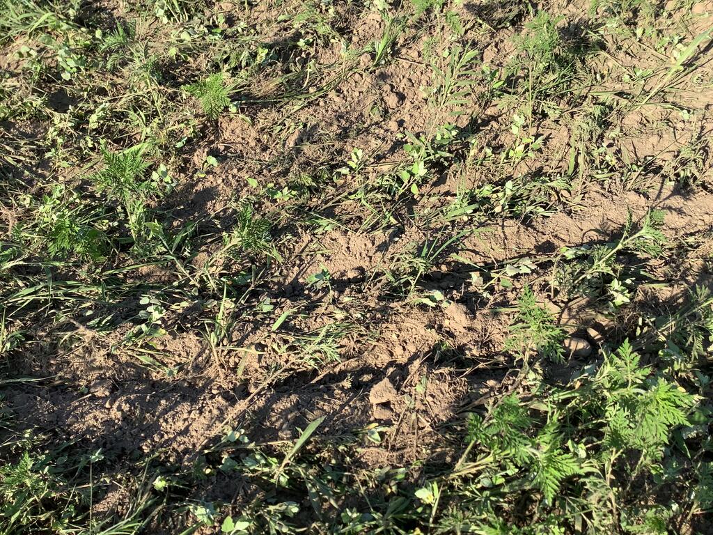

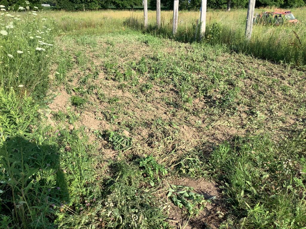

Pullstart 70,702 #7 Posted July 21, 2022 Well, our ground is harder than a rock as it hasn’t rained good in weeks. I see critters are getting the squash plants before they even grow squashes! It still digs, even with turf tires and no weight! As for the garden, we did containers this year. I just tilled it and planted squash for observation… 1 Share this post Link to post Share on other sites
