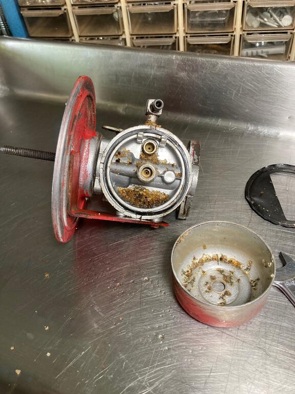

lynnmor 8,914 #2 Posted July 18, 2022 It sounds like you are using some kind of snake oil in the gas or gas that contains too much ethanol. Many of these additives are powerful solvents that sometimes temporarily dissolve the crud in the fuel system and people think they are great. My suggestion would be to flush the fuel tank, replace the petcock if needed, replace the fuel line and install yet another fuel filter that is clear like the original. Hopefully the fuel pump hasn't been damaged. After that is done,try it but I would bet you have plenty of junk inside the carburetor and it needs to be physically removed. Use only fresh regular grade gas with no more than 10 percent ethanol. 1 1 Share this post Link to post Share on other sites

Blasterdad 3,167 #5 Posted July 18, 2022 (edited) 1 hour ago, lynnmor said: I would bet you have plenty of junk inside the carburetor and it needs to be physically removed. This is what you're likely going to find in your carb, this is from the same thing, "disintegrated" fuel filter. Good 'ol ethanol damage, I use filters with metal screens & rec fuel. Clean out your fuel lines & pump, clean out/ rebuild your carb & you should be good to go.. Edited July 18, 2022 by Blasterdad 4 Share this post Link to post Share on other sites

ineedanother 2,621 #9 Posted July 19, 2022 Likely a stuck float. I'm betting the bowl looks a lot like what @Blasterdad showed above. Nothing catastrophic... 1 Share this post Link to post Share on other sites
